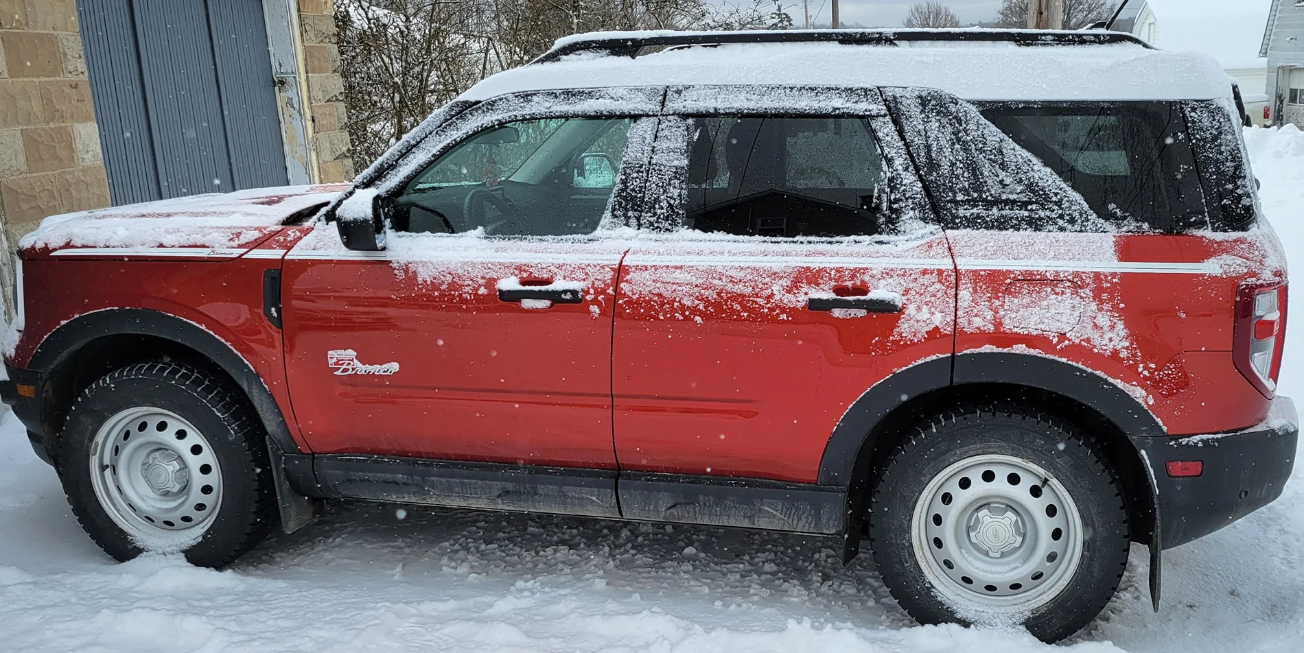

My 24 bronco Sport Heritage came with a full size spare on a steel wheel (rim). So I thought they all did. If your trunk or floor storage (what ever you want to call it) can hold a full size tire, I would just go to ebay and find a Ford Maverick steel wheel. Then put what size tire your Bronco Sport came with on it for a spare. I am not talking sasquatch tires (not sure if it would fit back there).
I just seen one on ebay -used- for $65 USD (Maverick steel wheel)
Yes , Maverick steel wheels fit Bronco Sports. Here is a pic of mine dressed in winter tires on Maverick steel wheels
Ford Bronco Sport Spare tire size 20251211_093345
