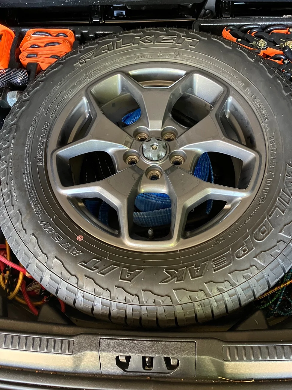

Didn't see my specific tire size addressed but I wanted to know if I put a 235/65 17 Falken Wild Peak tire on a stock 5 slot rim. Would it fit where the current smaller size spare is? I read you're supposed to remove the carpet and raise the floor one level. I see where I can raise the floor but I don't see any carpet in my 2024 Big Bend. Thanks in advance for the advice.

My new 2025 BB came only with a tire inflator. Not sure if this helps but I found a used Ford aluminum wheel and a slightly used Yokohama Geolander (225/65 17) tire. This combo serves as my spare and it fits perfectly in the tire well when the rear floor is raised to its upper position. In my BB, the "carpet" is the upper side of the rear floor.

Ford Bronco Sport Spare tire question IMG_3339
Yes, it fits fine. Floor mounts in the top slot and is flush with the seats.
