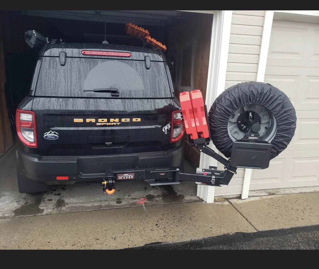

I saw another Sport today and it had a tire holder on the back. I can’t say what model of sport it was as I could only see the back. Is that possible with a big bend with a flip up hatch? I imagine there is a bracket for that which would have to swing out before the hatch could open. The weight of a tire would be problematic, on a flip up hatch unless I put stronger door struts on. I am guessing the Sport I saw was a badlands or outer banks with a swing open hatch instead of flip up, but I don’t know if that is a thing or not. Additional benefit is I like the look of a tire on the back.

There are some hitch mounted options out there.
edit: too old and slow!

Well rats, I didn’t notice it was a hitch mount. I don’t have a hitch.
