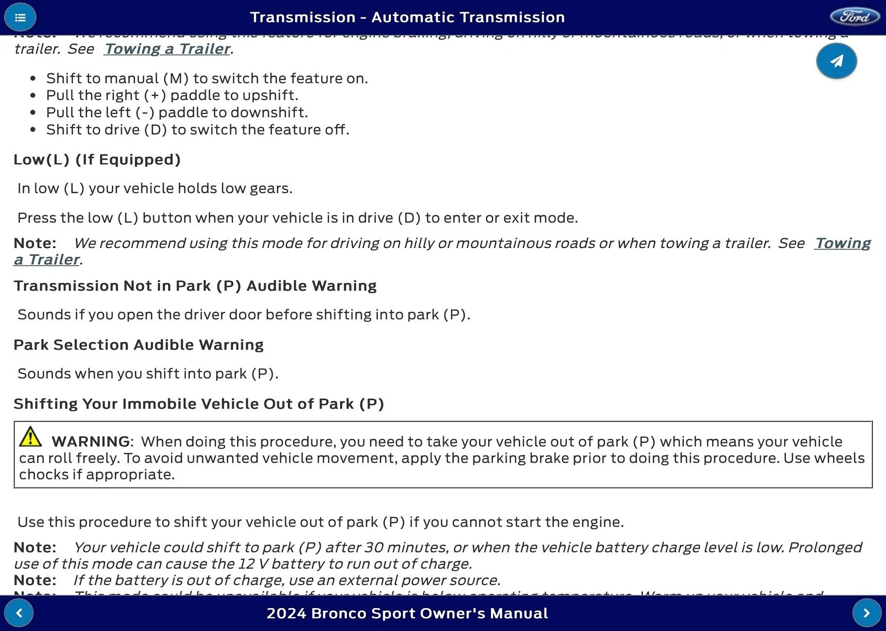

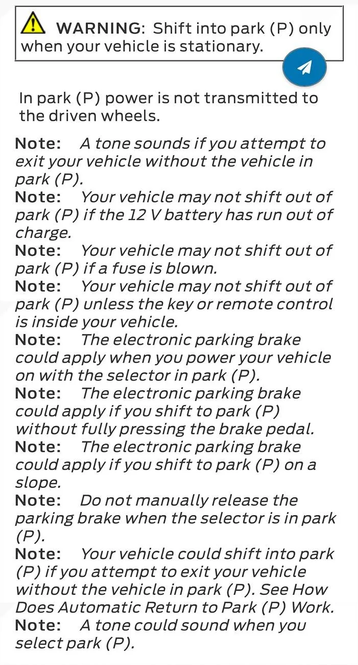

can you please post a screenshot of the owner’s manual note that the vehicle may make a tone when shifting into park (including the section it is in)?
It is under Transmission -> Automatic Transmission -> The last note in the screenshot.

Here is another blurb from the manual.
Park selection audible warning.
Sounds when you shift into (P).
This makes it sound like there should always be an audible warning. Maybe this is a new feature for MY 2024 that works most of the time? Good grief.
