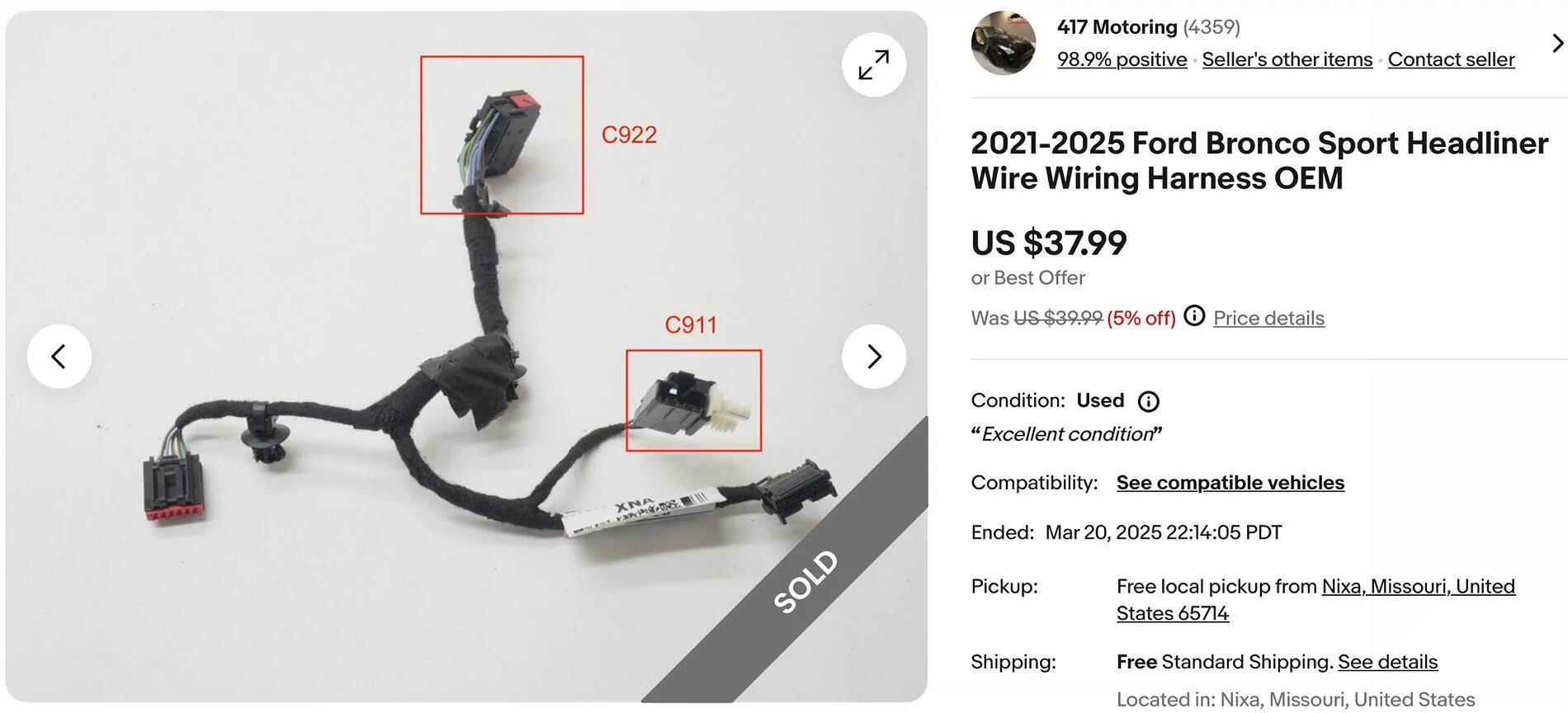

PSA: Don't waste your $ buying the '25 Repair Manual from Factory-Manuals

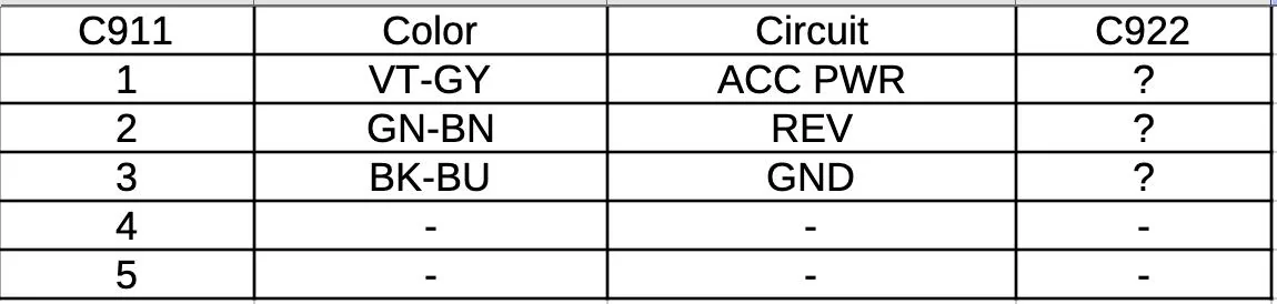

I specifically purchased the manual to see if I could wire in a '24 BS auto dimming mirror from a baker's yard. Originally, I purchased the small headliner wiring harness with the mirror pigtail which indicated it was compatible with a '25.
Ford Bronco Sport Service manual Screenshot 2025-04-26 at 7.47.41 AM

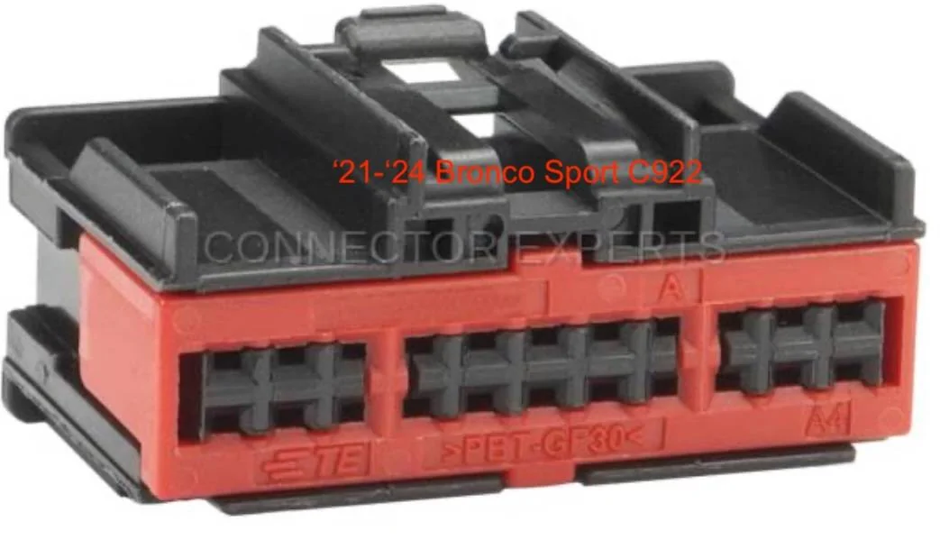

For the '25 BS, the C922 connector was changed from a 22-pin TE connector to a 16-pin Molex connector. Although I de-pinned the circuits from the TE connector, the pin retention mechanism between the connectors is different. Not to mention I would not know with 100% certainty which positions to insert the wires. I have tried searching for the correct headliner harness directly from Ford for the '25 BS.

Does anyone else know how to get the correct '25 BS repair manual, the correct pinout of the '25 BS 16-pin C922 Molex connector, or the headliner harness with the auto dimming mirror pigtail?
The '25 non-auto dimming headliner harness is P/N SZ1T-14A411-XAD
