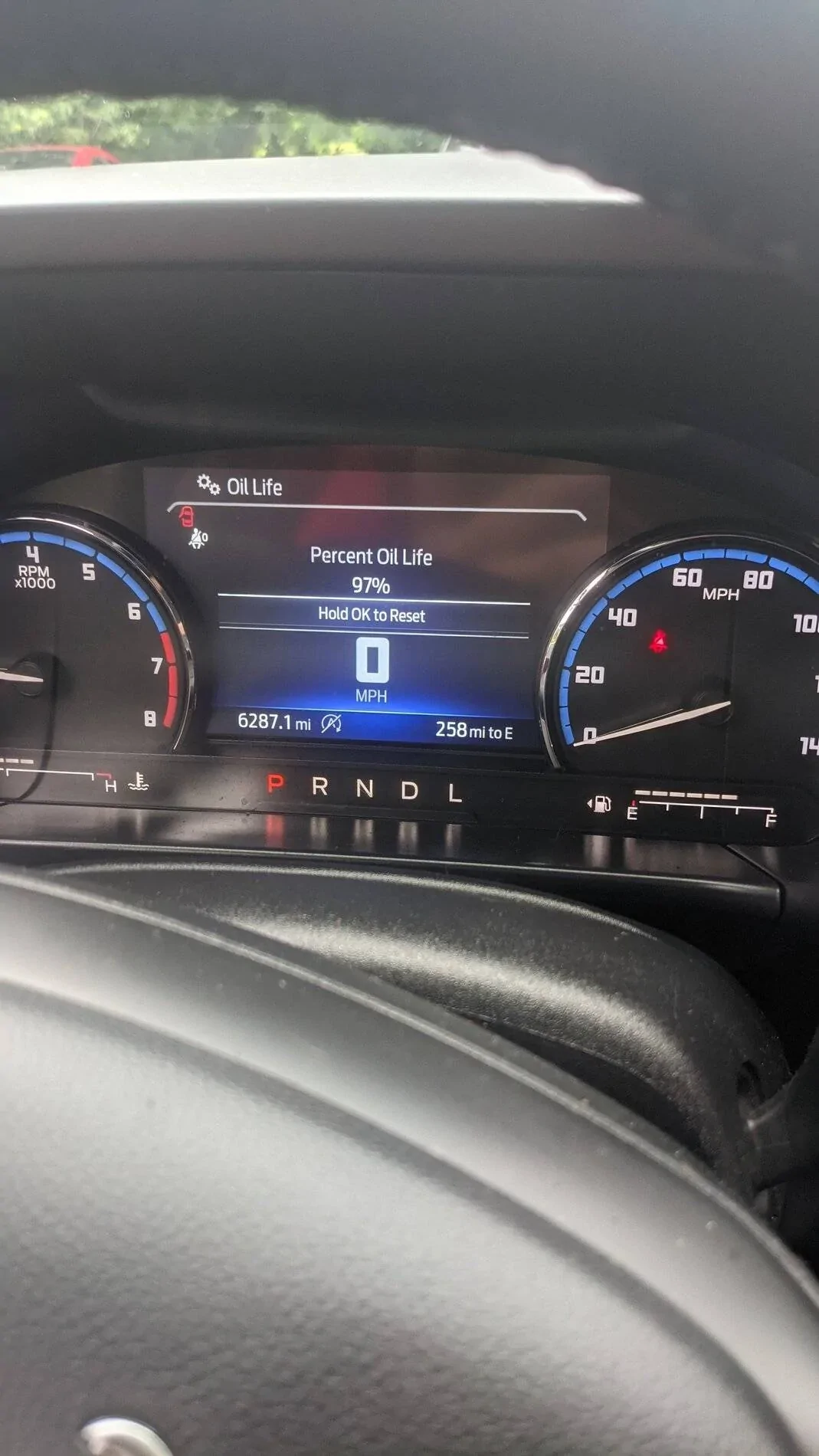

Ford Bronco Sport Service intervals PXL_20210809_194215439
on the steering wheel menu check oil life. I have used this with Ford and the best time to change is once you get below 20% oil life.
From what I have been told it factors mileage and engine run time. The oil life can also be found in your Ford pass app which you can setup oil change tire rotation reminders.
