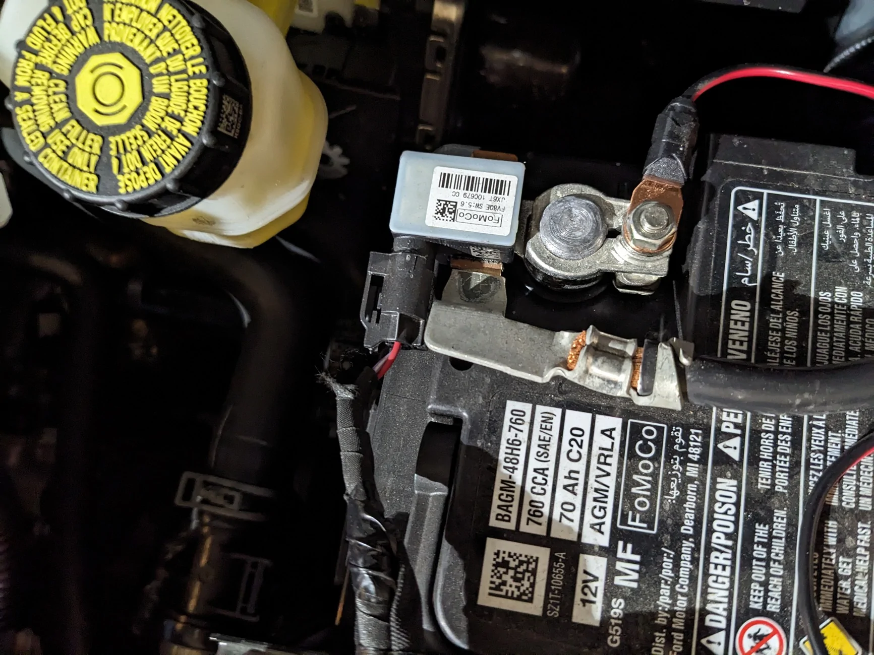

I ended up getting a trickle charger and it has made a world of difference! I got NOCO Genius 1, removed the clamps and connected the leads directly to the battery. I hooked a NOCO extension cable and ran the end out through the drain near the wipers and just hook up the charger after use. I average once a week - the remote features were shutting off in between uses sometimes, the auto start/stop never worked, and I could definitely see the drop in gas mileage until the alternator charged the battery (like 10-20% lower).
Make sure you are connecting the charger to the BMS sensor and not directly to the battery terminal so you don't mess up the BMS data quality.

Follow the black cable to the drivers side front fender

The bolt connecting that cable to the frame is welded.
Bummer, mine is not welded and on some vehicles the bolt got loose which maybe explains why it’s now welded (assuming ford made that change IDK)
