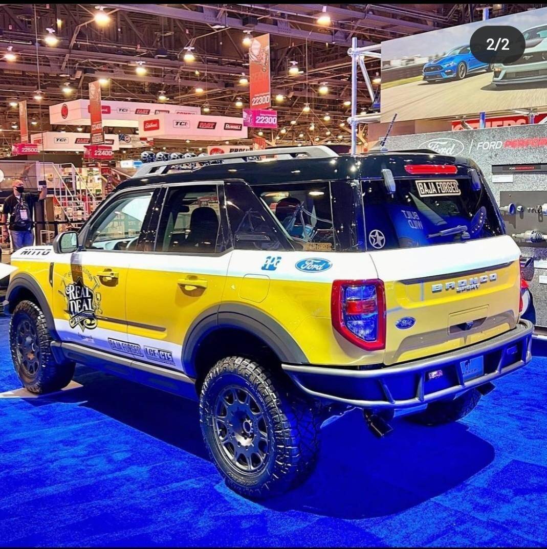

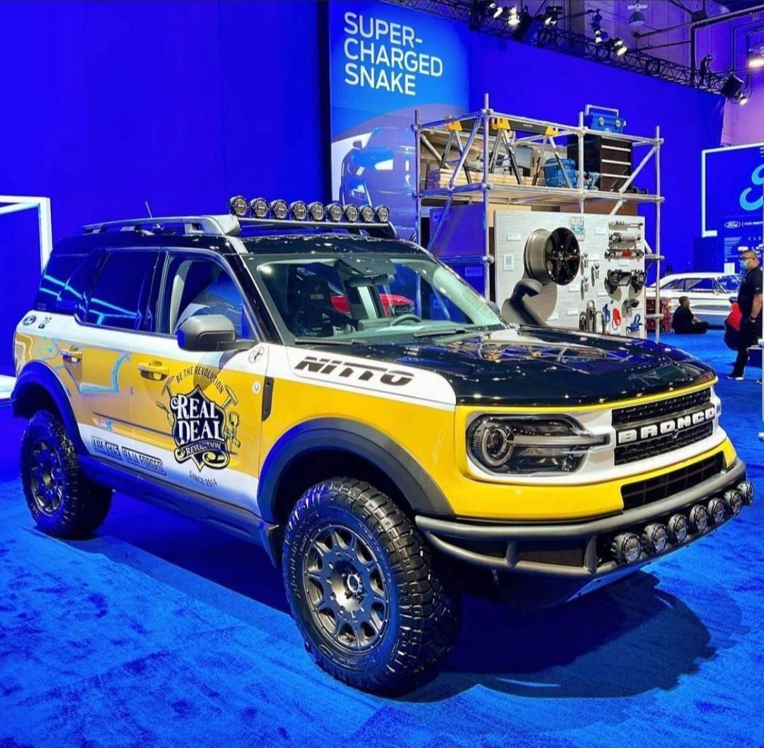

The rings are ok, I don't care for the tin wrap, at least its not as bad as the front.
I was thinking of something more like this.

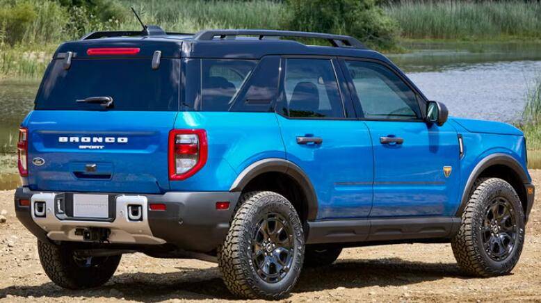

Order the parts.
Looks great with the D-rings!
