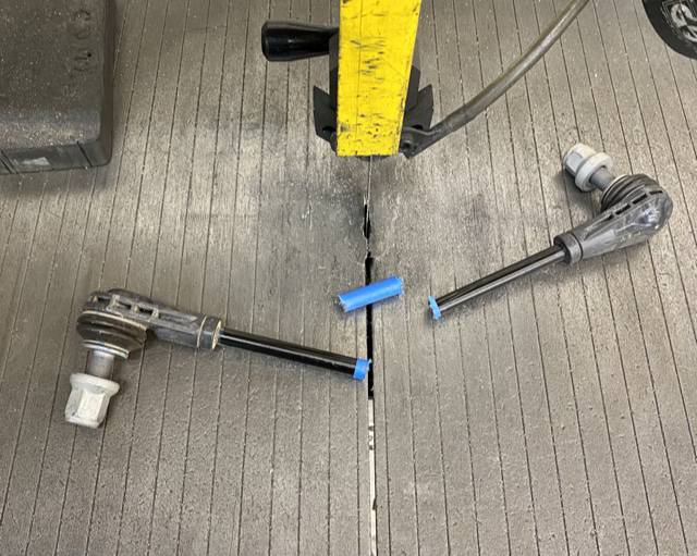

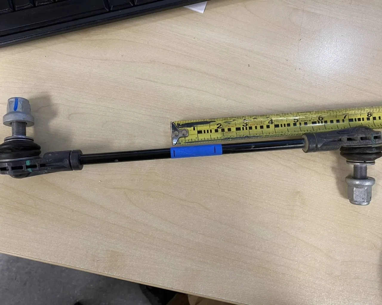

I marked sway bar link at the center with 2 marks, 1.5” from each other.
Ford Bronco Sport Rough County Lift Fix C740B44C-7FF7-43CF-B8BD-203867D4CE91
next I cut the section between the marks out

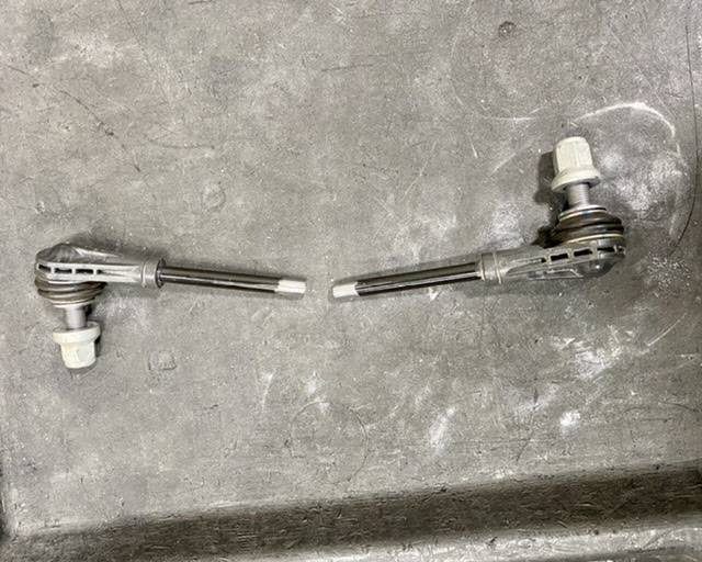

took the paint off where I was going to weld
Ford Bronco Sport Rough County Lift Fix B957E019-0769-49B6-A24E-93B76849BECE

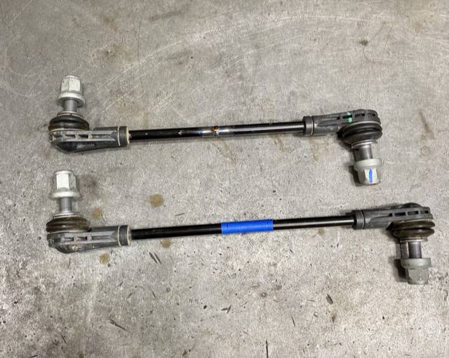

Then welded is back together with the bolts opposite of eachother
Ford Bronco Sport Rough County Lift Fix 062ED3BE-A1DF-4B8E-A376-5BCDB113EB7F

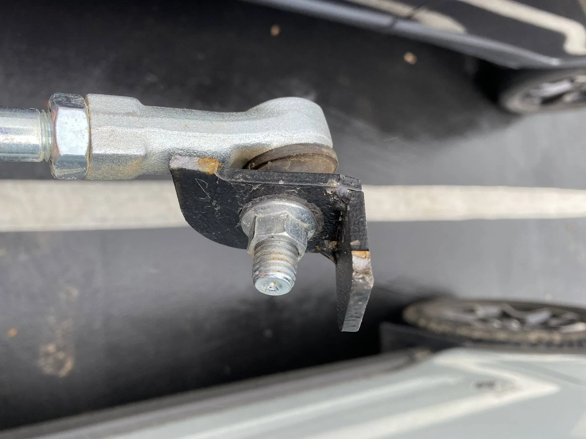

Today was our first day driving with our correctly cut to length sway bar links. They feel great and have been working well both on and off road.
100% the Rough Country Drop Brackets will break from off roading. Oddly enough mine broke last week.
Ford Bronco Sport Rough County Lift Fix 0EEAFA92-8089-46D1-8D0E-7FA4A24AB540
The OEM links are much better built and include fine-tread bolts with locking nuts!

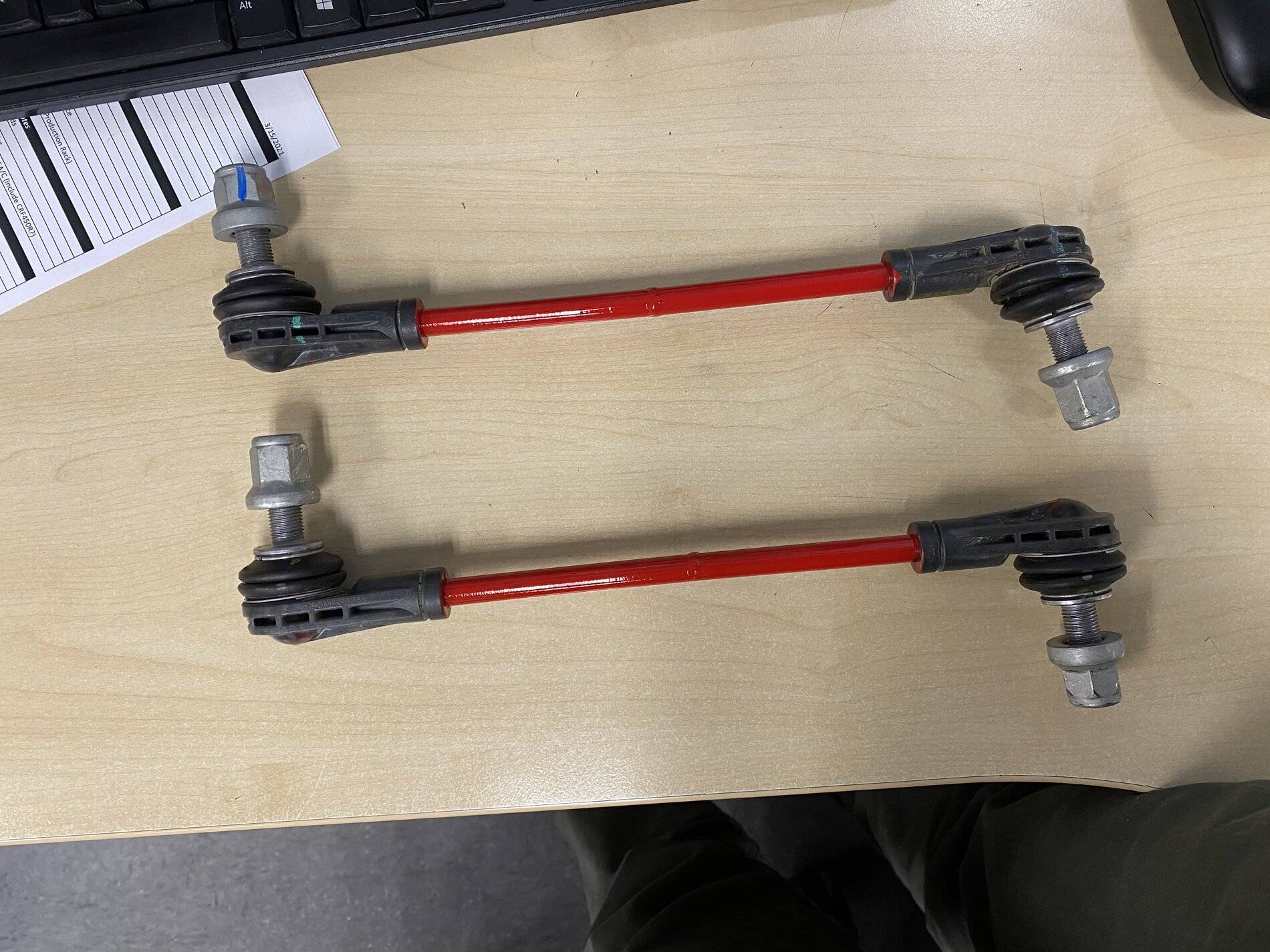

A little red for some low-key flare
Ford Bronco Sport Rough County Lift Fix E3C4AA91-F247-4F48-8EE8-0F75F4F18526
