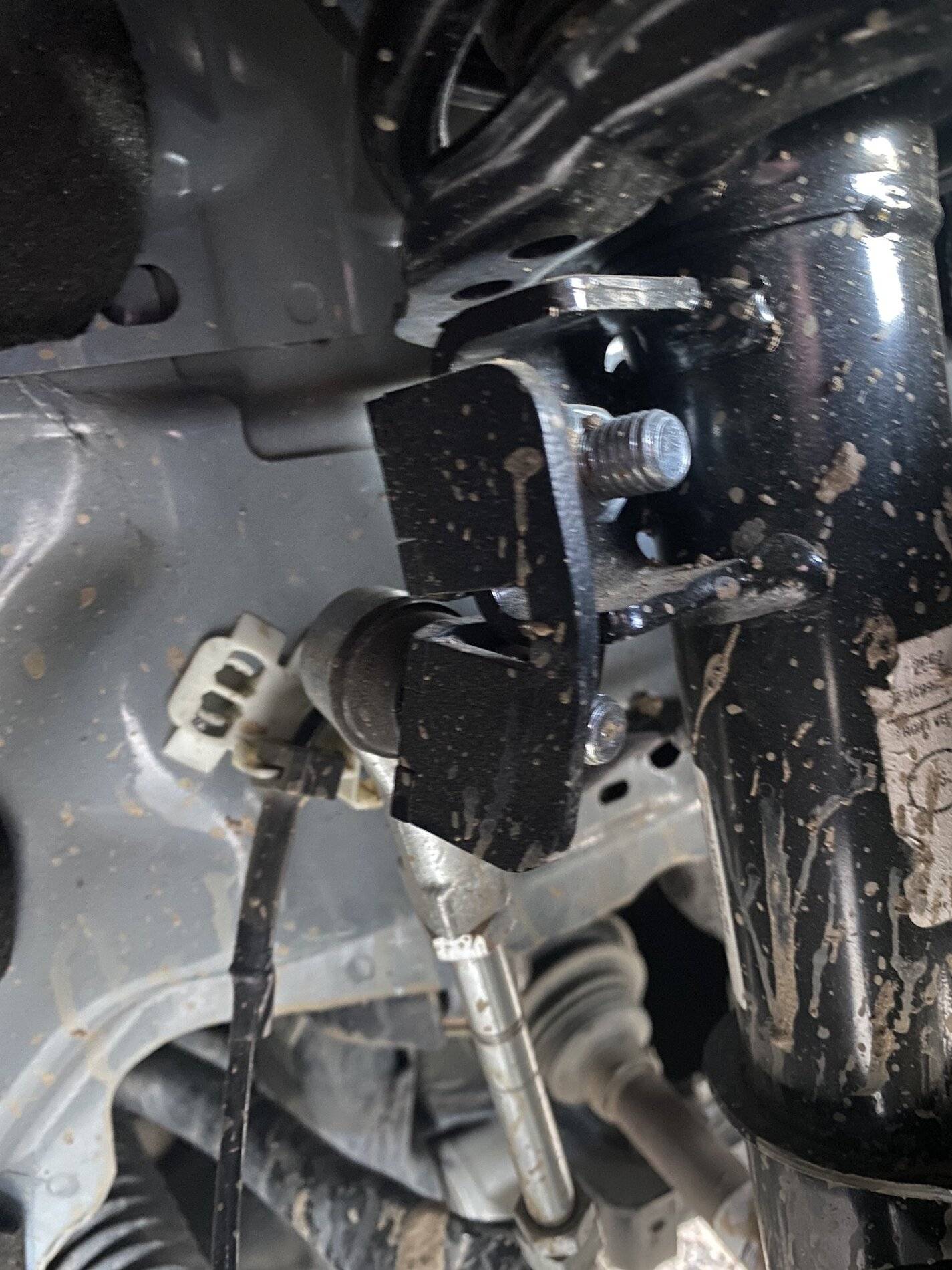

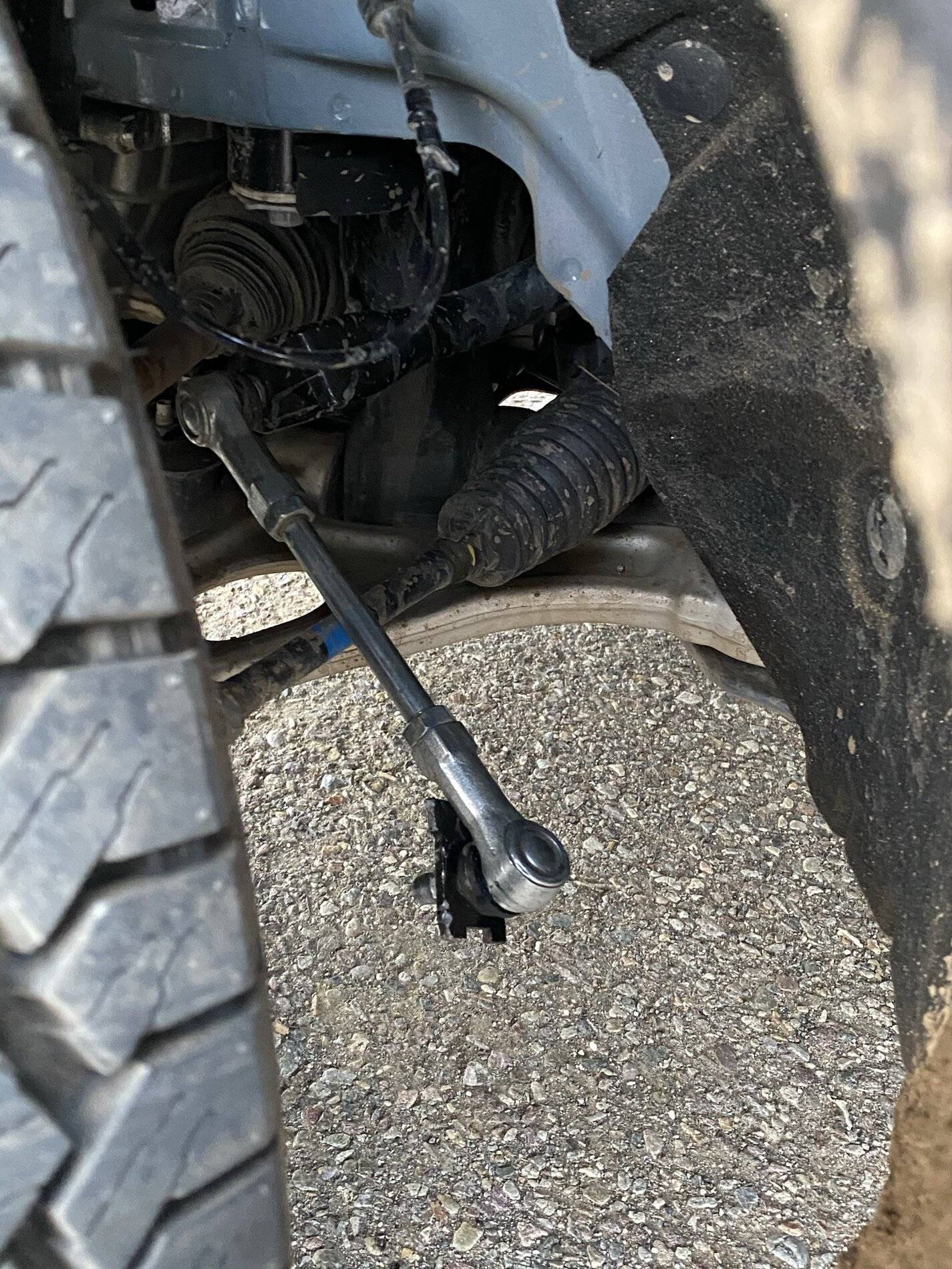

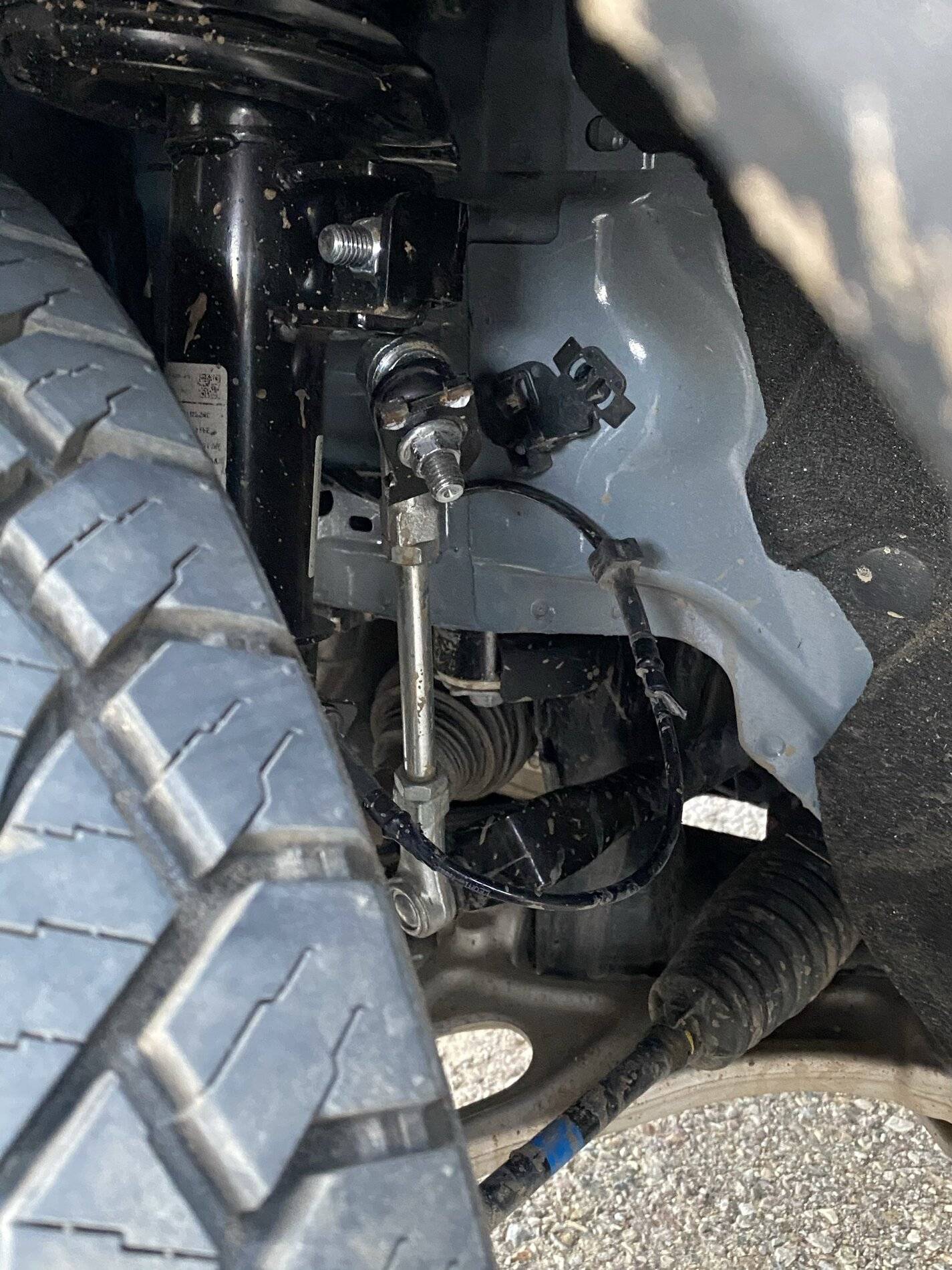

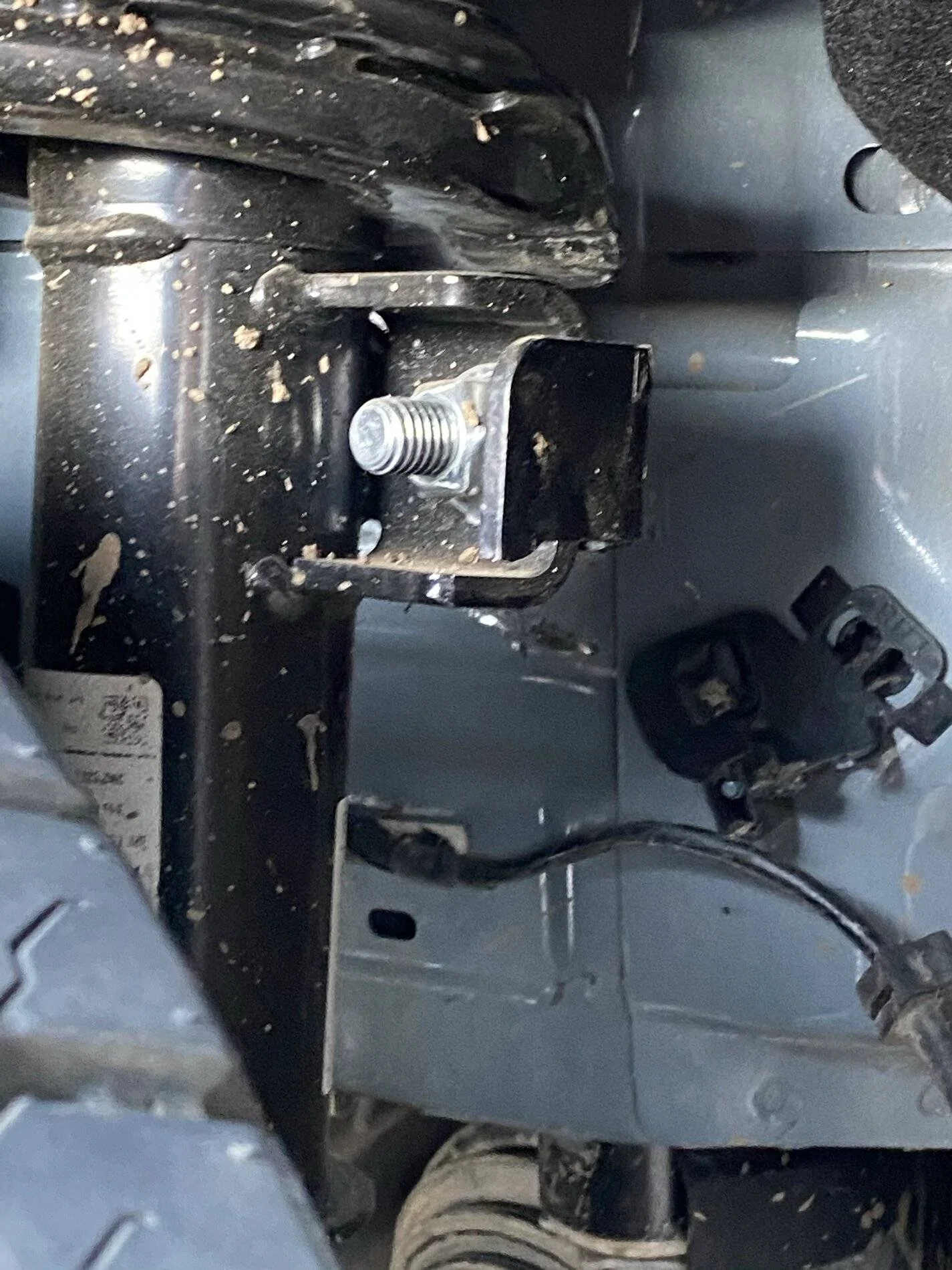

Well I snapped the sway bar link drop bracket on a mild 2/10 off road trail. One side fully snapped off and disconnected and the other side seriously bent.
I have gone back to the OEM sway bar end links without the drop bracket. As far as I can tell this should work fine as the 2 other kits a available don’t use a drop bracket or shortened links?
the steering with the oem links is far far better and slightly better but still bumpy ride quality.
also as far as I know that when you increase lift you would want to extend your sway bar end links not shorten them. The rough country is about 4 inches shorter than the ford pieces and far far worse quality.

I think I agree with your logic about the length of these replacement sway bar links -- installed *shorter* with a lift doesn't sound right to me either, are you sure that was done correctly? The replacements have instructions for setting them up at the right length (adjustable) for installation, right?
These pics looks as if that flange on the strut isn't strong enough -- but with different geometry and thus different forces, exerted, who knows? Maybe an engineering issue they didn't, or weren't equipped to figure out and are "testing" on customers. Another reason to be cautious about who is actually "endorsing" what mods -- I think.
Yes they said to measure to 9 1/4 inches which we did. Nowhere did it say to expand them once installed or anything. We did install the bracket wrong upon further inspection looking on the online photos versus the horrible black and white instructions booklet that we used to install which was impossible to distinguish the parts due to such low contrast.
nonetheless that part shouldn’t have snapped in half like that.

The reason they made the links shorter is because you are effectively lowering the shock when you install a spacer on it. So you have to shorten the link to keep the sway bar in the same place.
I have the kit and agree the rough country lift parts are built for an RC car, not a real one. I work in metal fabrication and I was shocked by how poor the structure was on the spacers and drop down brackets.
I plan on cutting and welding my oem links 1.5” shorter

well the issue could be my poor installation too we noticed that we put the bracket on backwards. The drop was the same. The instructions were literally horrible.
Oh I see that now yes its backwards. Sorry man that's rough. I'll still be cutting my OEMs down. I'll let you know how it goes and if it's successful you can try it out.

I was also reviewing the posted installation photos of the Rough Country kit in this thread and comparing them to Rough Country's photos ln their installation instructions. The installation in this thread looks incorrect and could have possibly caused the failure of the bracketry and issues with the tie links.
