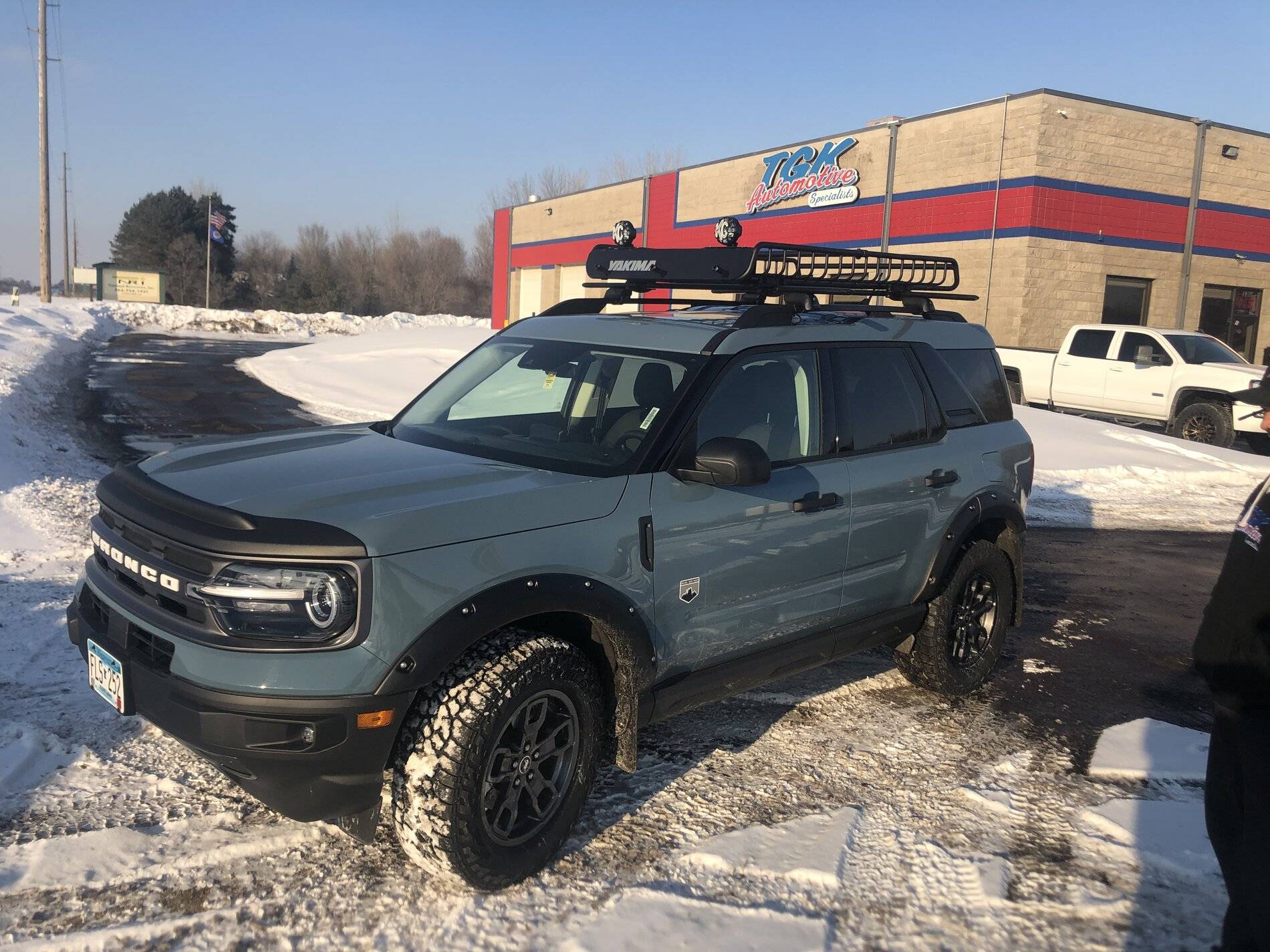

After having Rough Country lift installed the sway bar hits the uni-body any idea how to correct?
Ford Bronco Sport Rough Country 1.5" leveling lift 255/56/r17 Wild Peak A/T At3W tires Hood protecter IMG_2823[1].JPG

They did some re-adjusting and not hitting the uni-body anymore, however still have a knocking noise from front suspension like something is loose its going back in this afternoon.

Front sway bar, they spent 2 hours couldn't find whats causing the problem, dropping it off next week they are going to look further into it, they are also calling Ruff Country for help.

Problem solved, they talked to Ruff Country, when putting the spacer for the strut your need to properly seat, which is not on the directions, 2 hours of work o more noise

i am a bit confused, doesn’t the spacer only go on one way? How can you install the spacer without seating it ?
