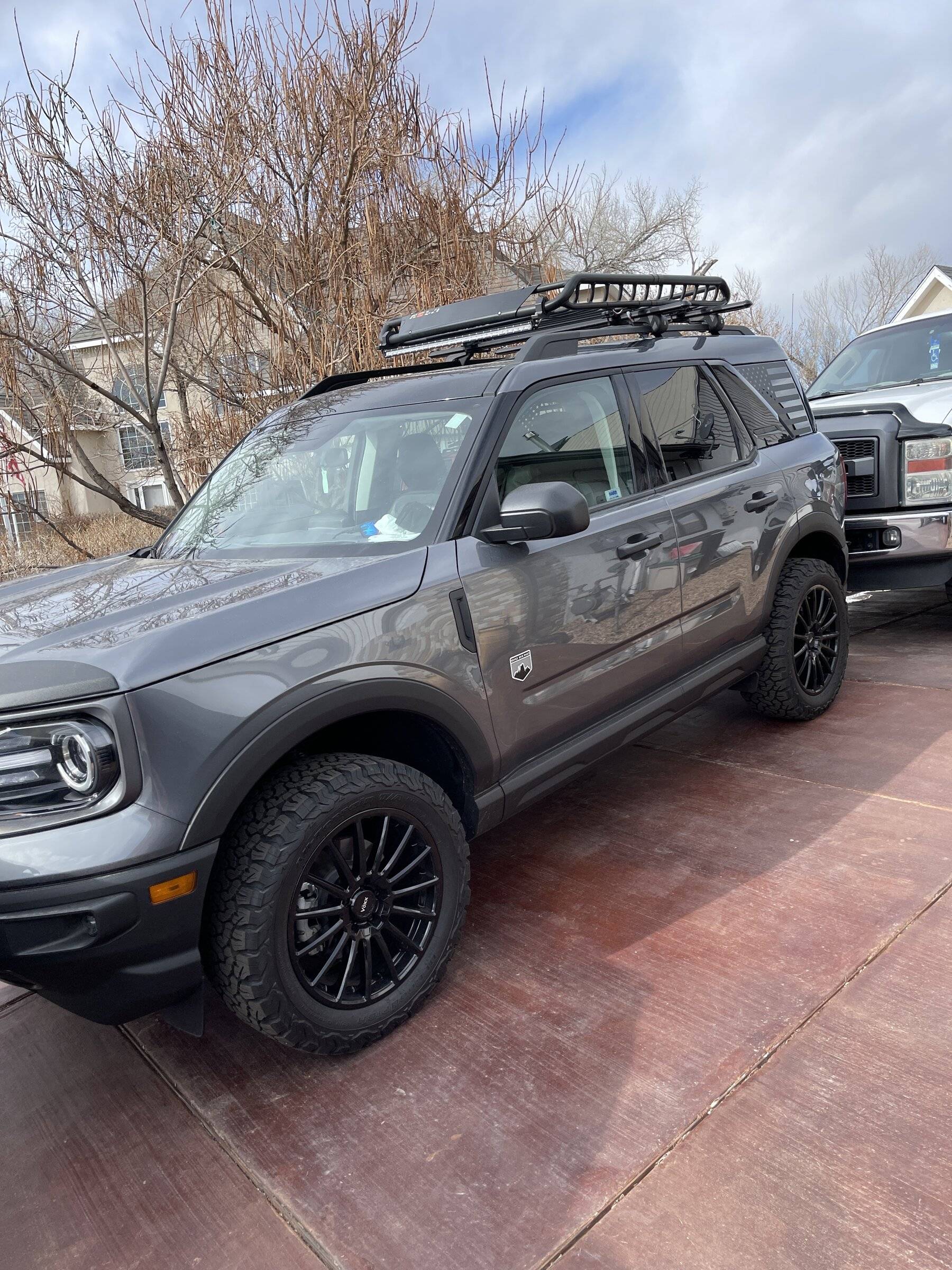

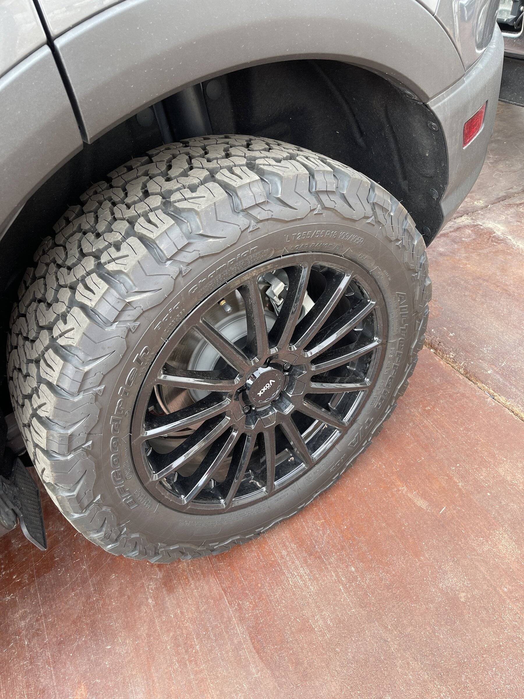

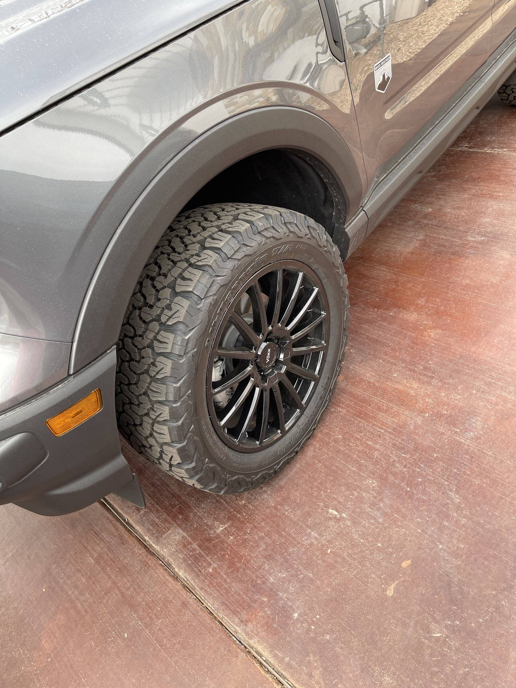

I did get new rims. Ordered for custom offsets on line 768.00 delivered. They are 18 by 8 wide with + 32 offset( not much difference from factory +37)

Very nice setup, that’s the look we are going for as well, not a lot but enough to grab some eyes here and there. Thanks again!

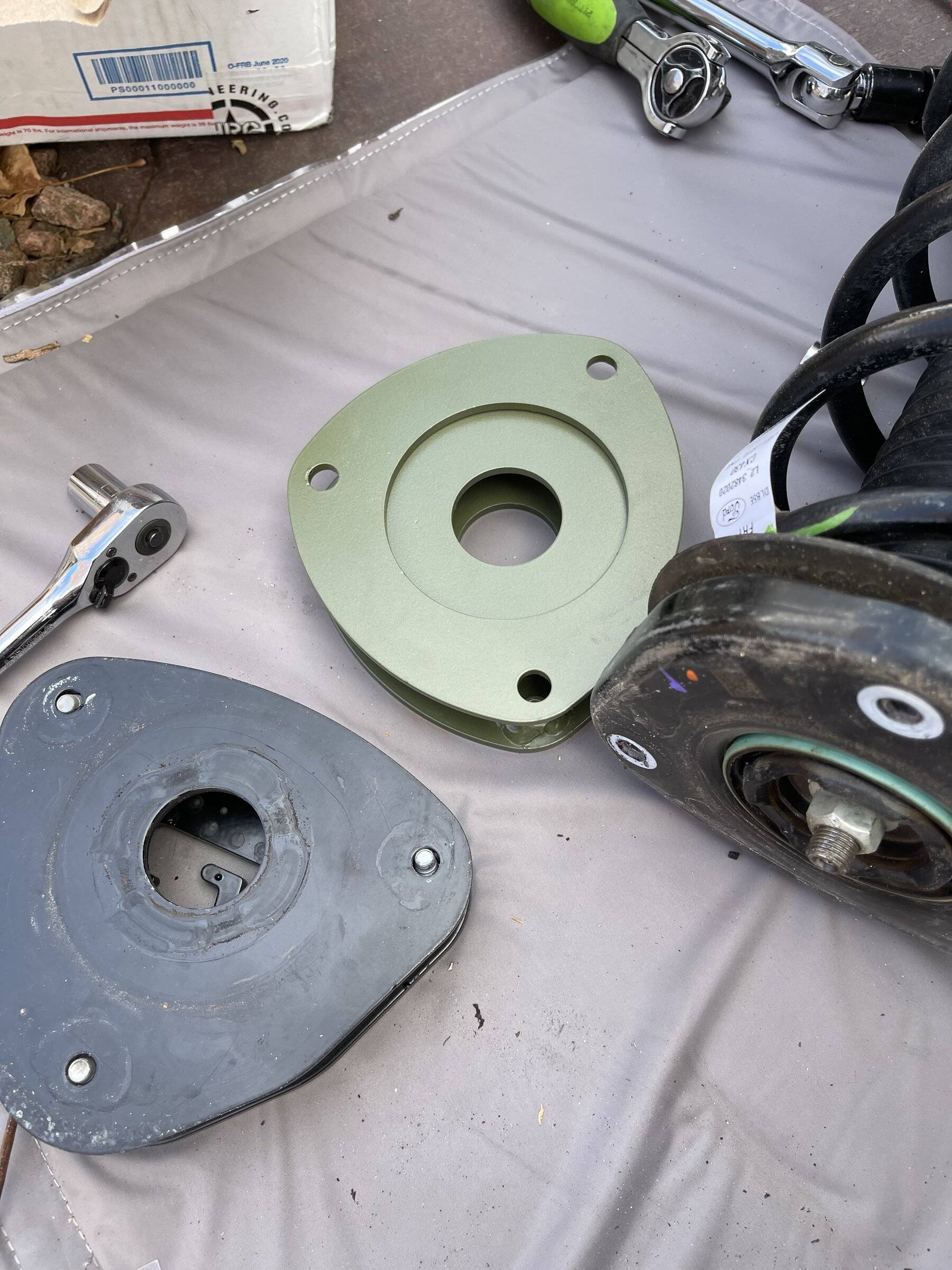

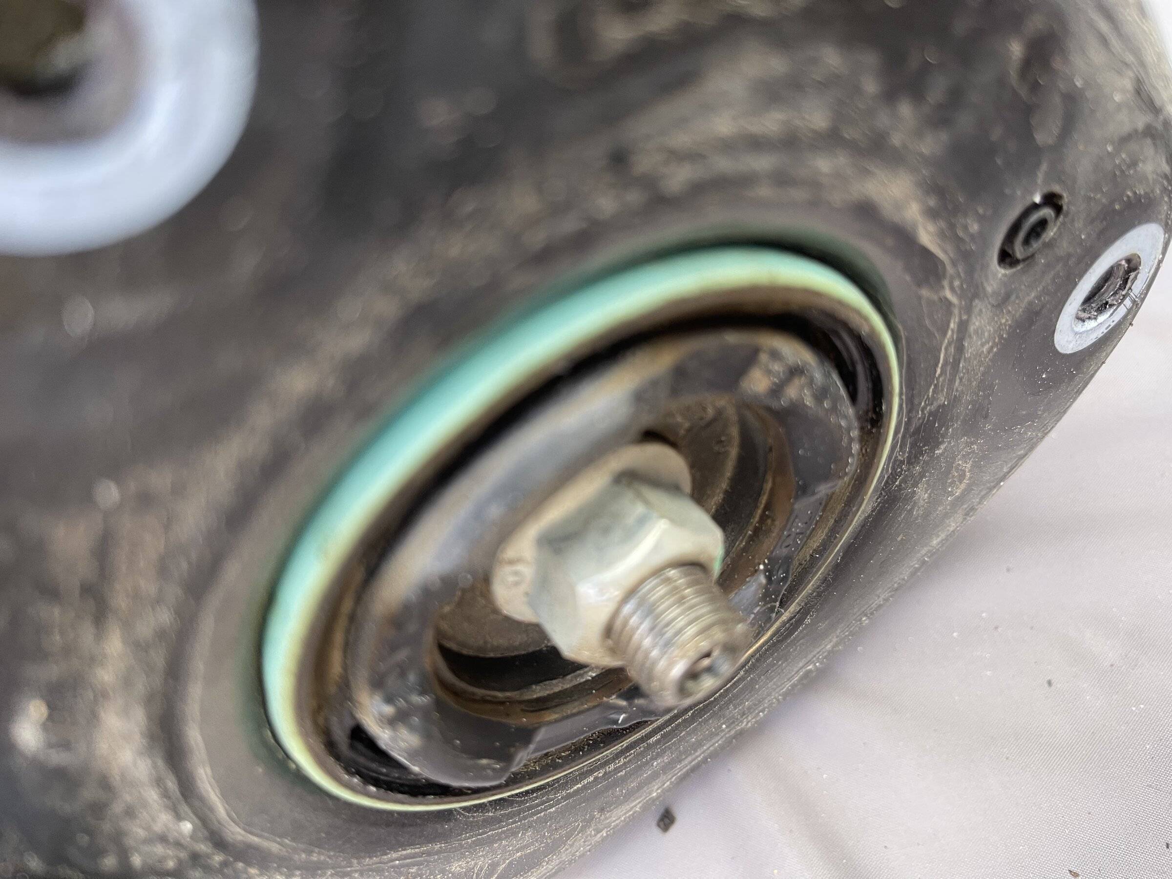

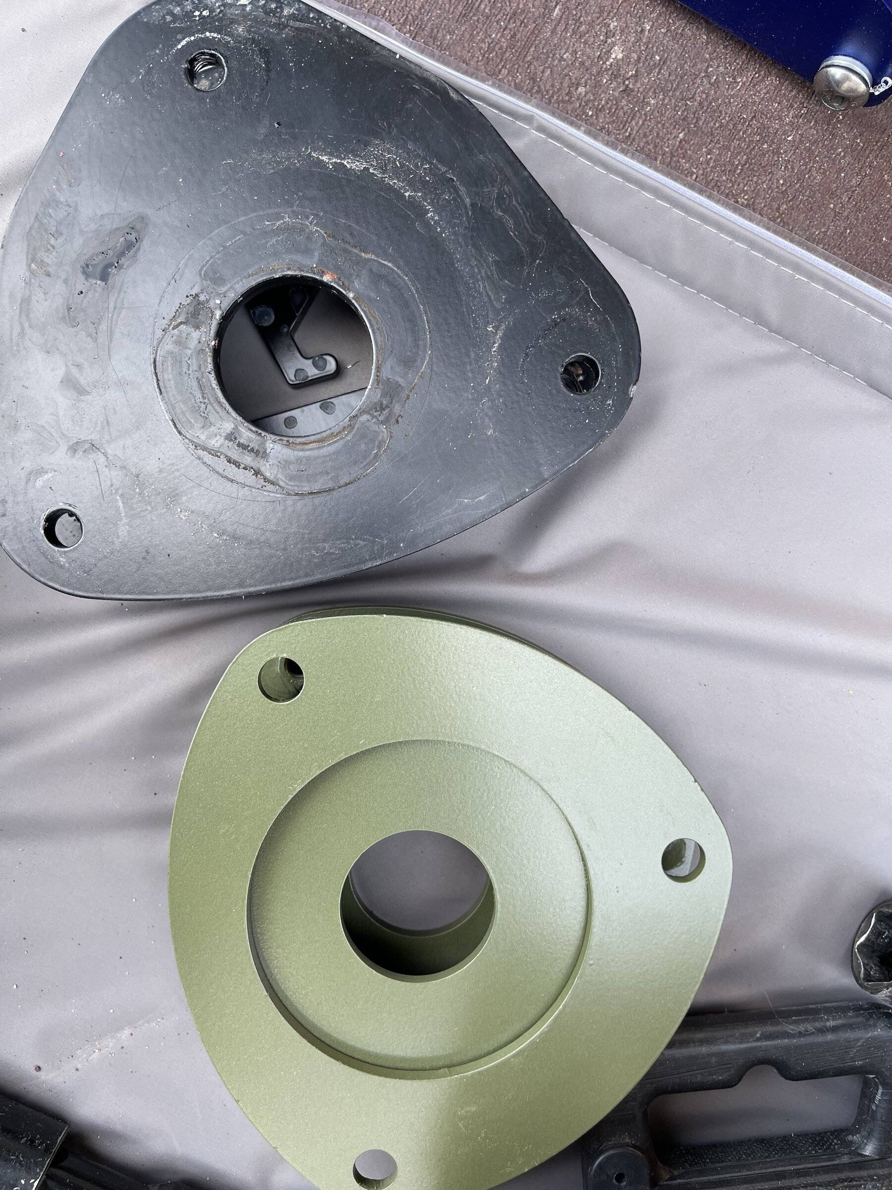

There are some threads here about the RC lift having issues. It is the way the spacer connects to the top of the front struts. Basically there needs to be a recess in the spacer for the area around the nut on the top of the strut to sit in. There was someone that created a plate to fit in there and create the recess but I don’t know if they are still doing it.

Yes that is correct, I had the same problem with readylift. Here is a picture of how they should look the green ones have cut out( hrg) the black ones ready lift and has no cut out for strut hat.

Thanks so much for that Adam! I wish I would’ve saw the HRG one before I bought the RC. I’m definitely ordering the HRG in the coming days and going to have RC replaced.
