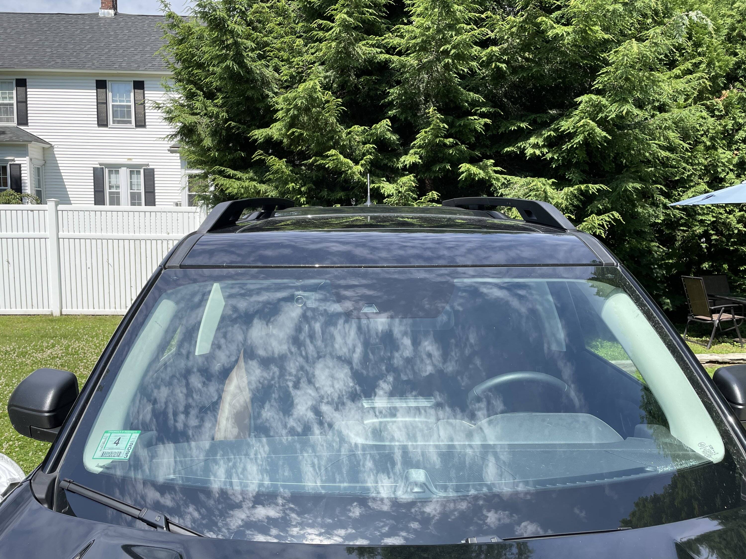

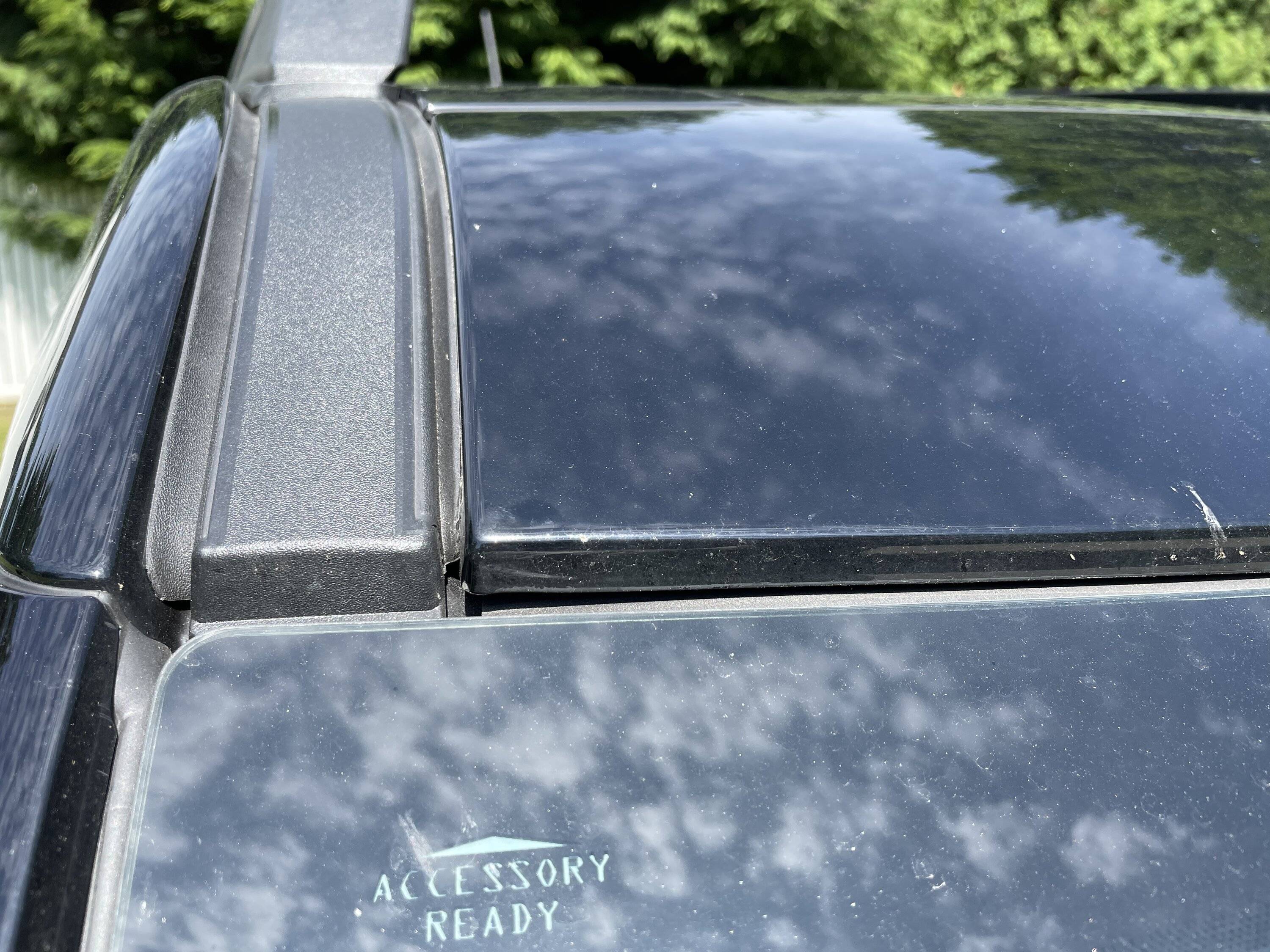

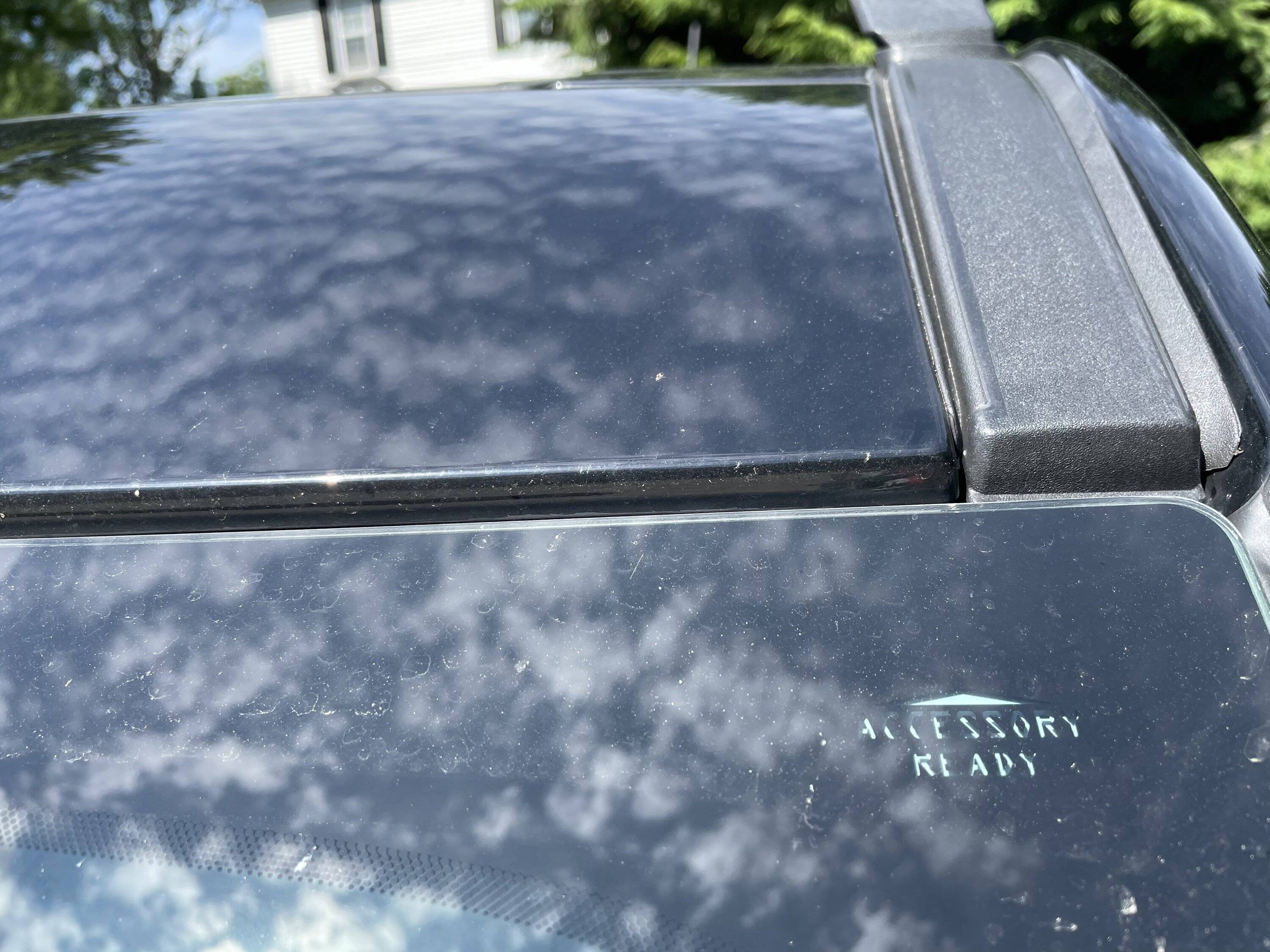

Anyone with a BS have the front part of the roof between the windshield and moonroof separating from the vehicle? My passenger side is warped and is peeling away from the molding and adhesive. Is like a good 12” of it is coming off. I’d be screwed if was winter here. Literally just left the shop for bad speakers. Seems weekly there’s another build quality issue.
Thing is built like a gingerbread house made by a three year old, nothing lines up.

Certainly does not look good.
Can you tell what that particular part of the roof is made from? I’m wondering if it’s some sort of plastic that uses clips.
I would assume that models without the moonroof use one large sheet of aluminum or steel that is welded to the frame?
It’s a metal piece and it’s warped. There’s no clips in that spot that I can see. Is just adhesive. Looks like it’s twisted. You can push on the spot that’s up, but even with a lot of force it won’t go back to a neutral position. Is actually pulling away from the molding and separating.
I see.
I can accept minor issues because nothing is perfect, especially when dealing with mass production. However, this is the kind of thing I consider to be unacceptable. It should not happen.
Ford has enough experience building cars to know better.

I am fairly certain the roof piece in question is made of plastic. My BS has a moonroof and while detailing the first time I also noticed that you can push on either side of the panel in question and it most certainly will move when pushed on.....mine does not have the gap though. It is probably made to expand and contract and by no means affects weather tightness.
As for build quality, my BS has been perfect. Way better built than my previous 2019 Honda Accord and 2021 Acura TLX. Panel fitment is spot on, paint has no orange peel....Overall the BS seems very sturdy to me ect.

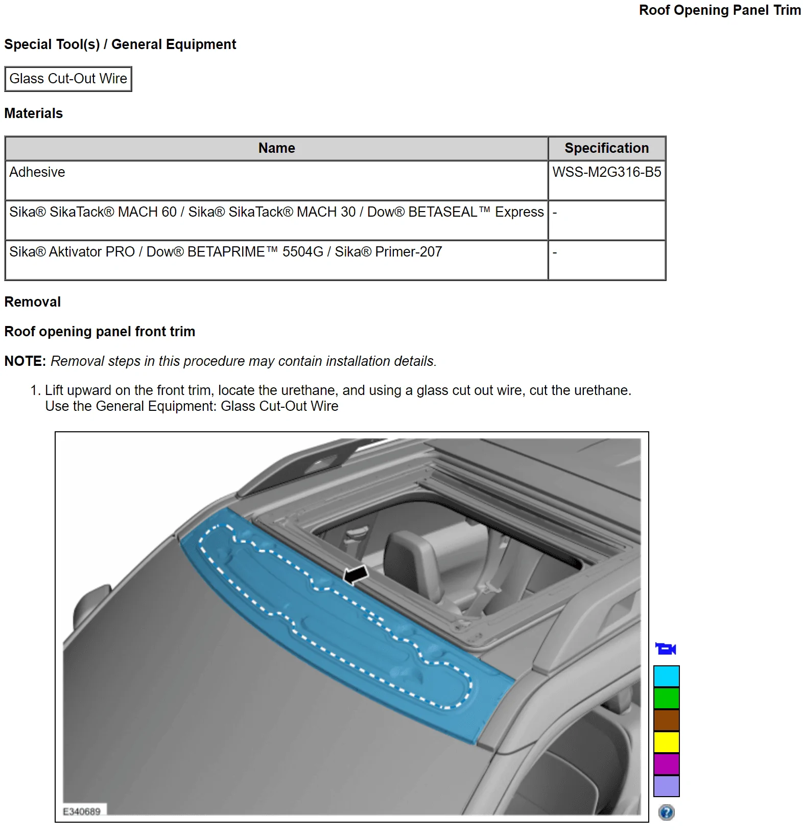

M1PZ-7851916-AC Is what was ordered. Sucks has to be painted and installed after ripping roof apart. Haven’t seen this happen on any others on the forums or heard about it from dealer techs. Wondering what all it entails to replace. And checking if anyone has had this happen at all.

May just happen again. If it is plastic, I would wait to see if they modify the part. if there are enough replacements to make them change the part design, some reinforcing ribs etc. If you replace it maybe have some tint film placed on top of it to help keep the UV from baking it.
