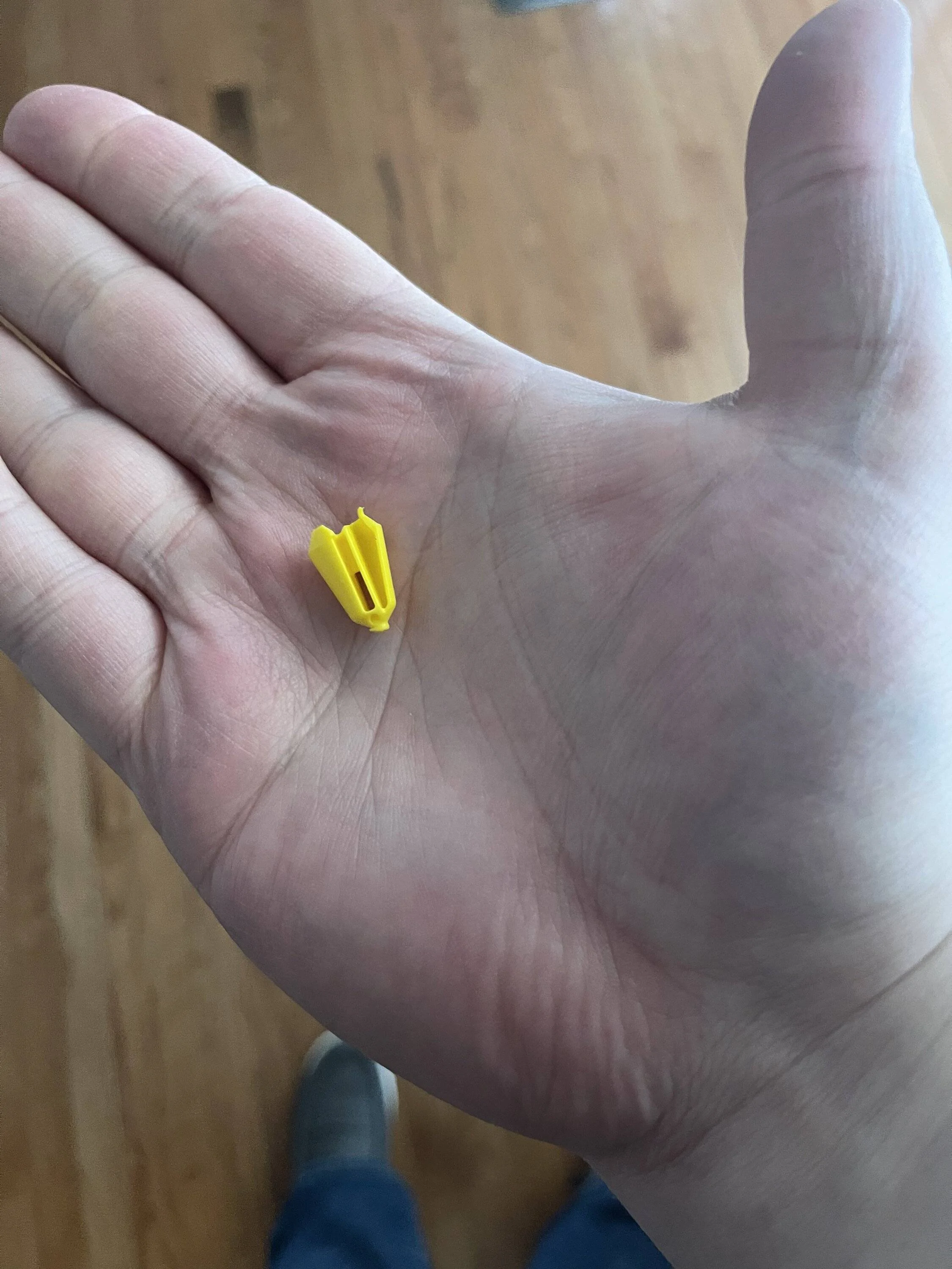

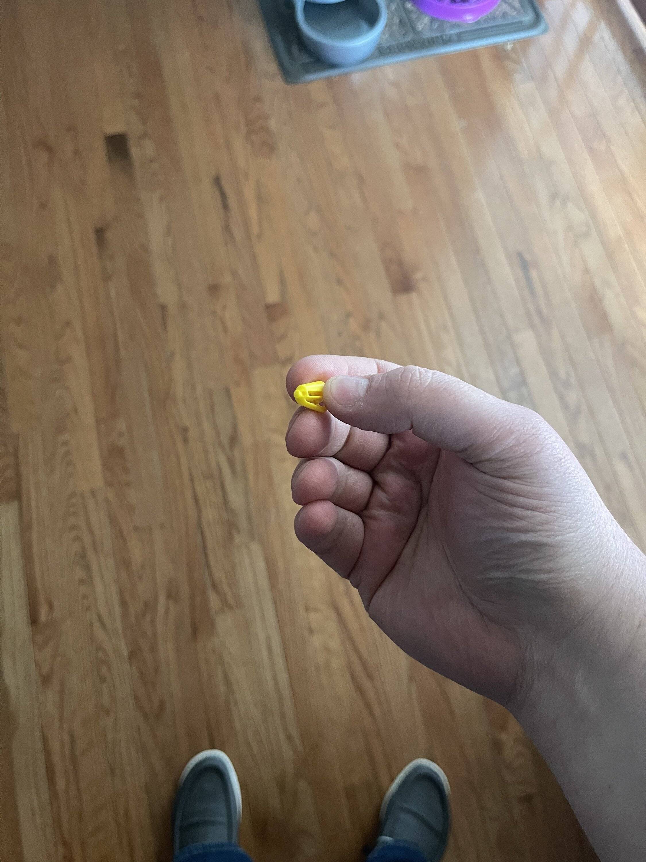

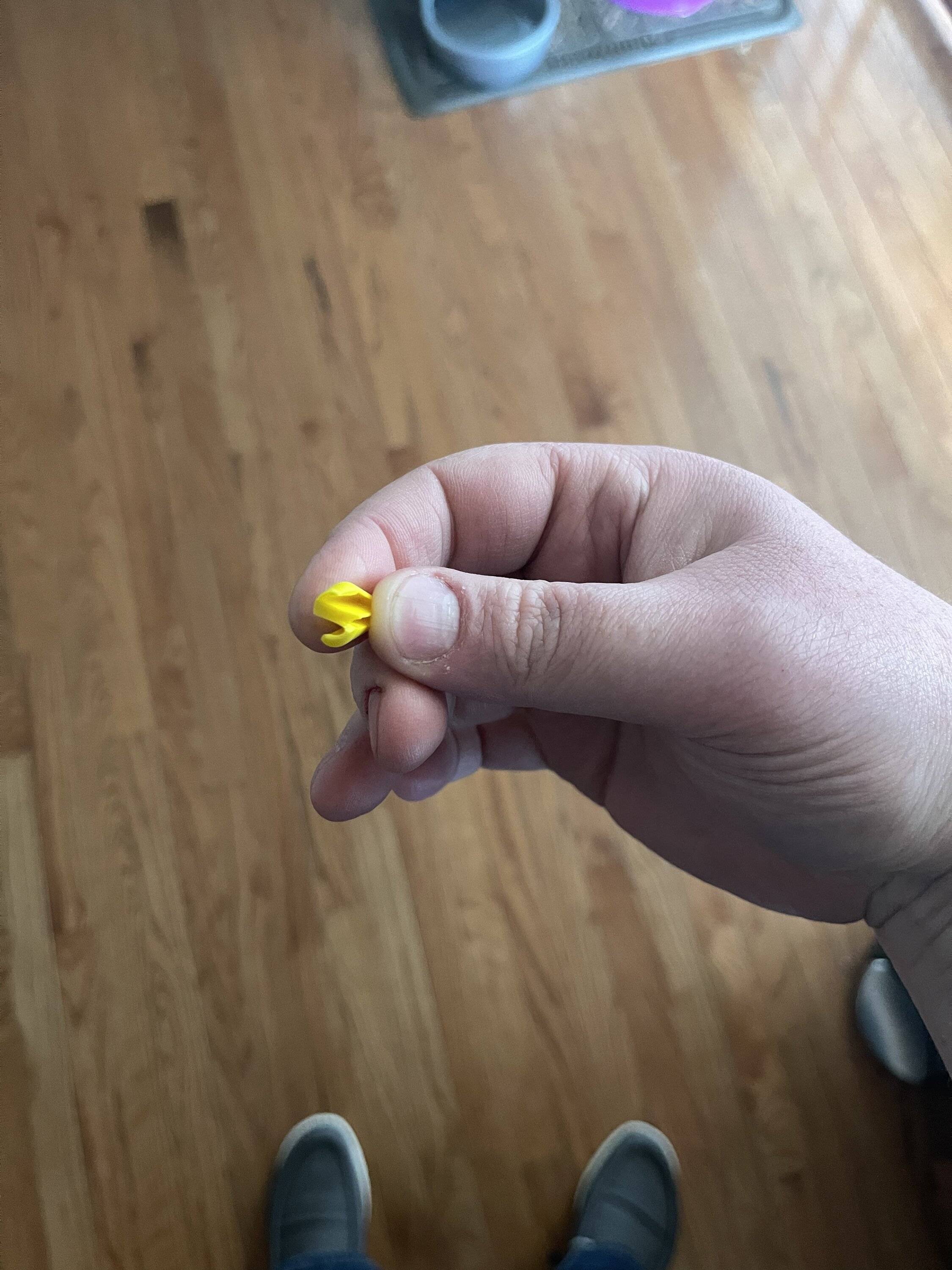

I searched the vehicle and found this little yellow plastic piece in the spare tire area (see pictures). This was not the source of the rattling but glad I found it anyway.

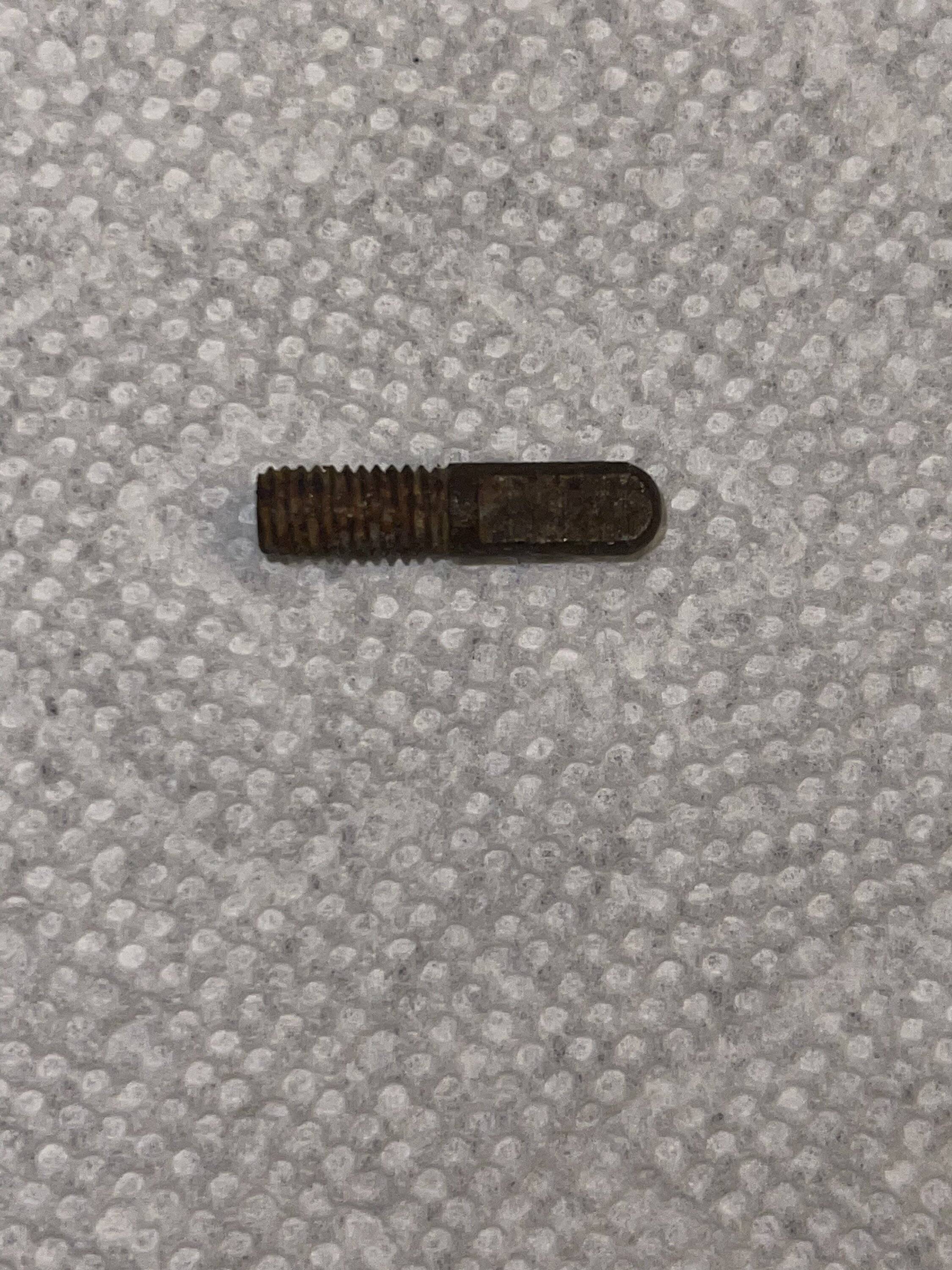

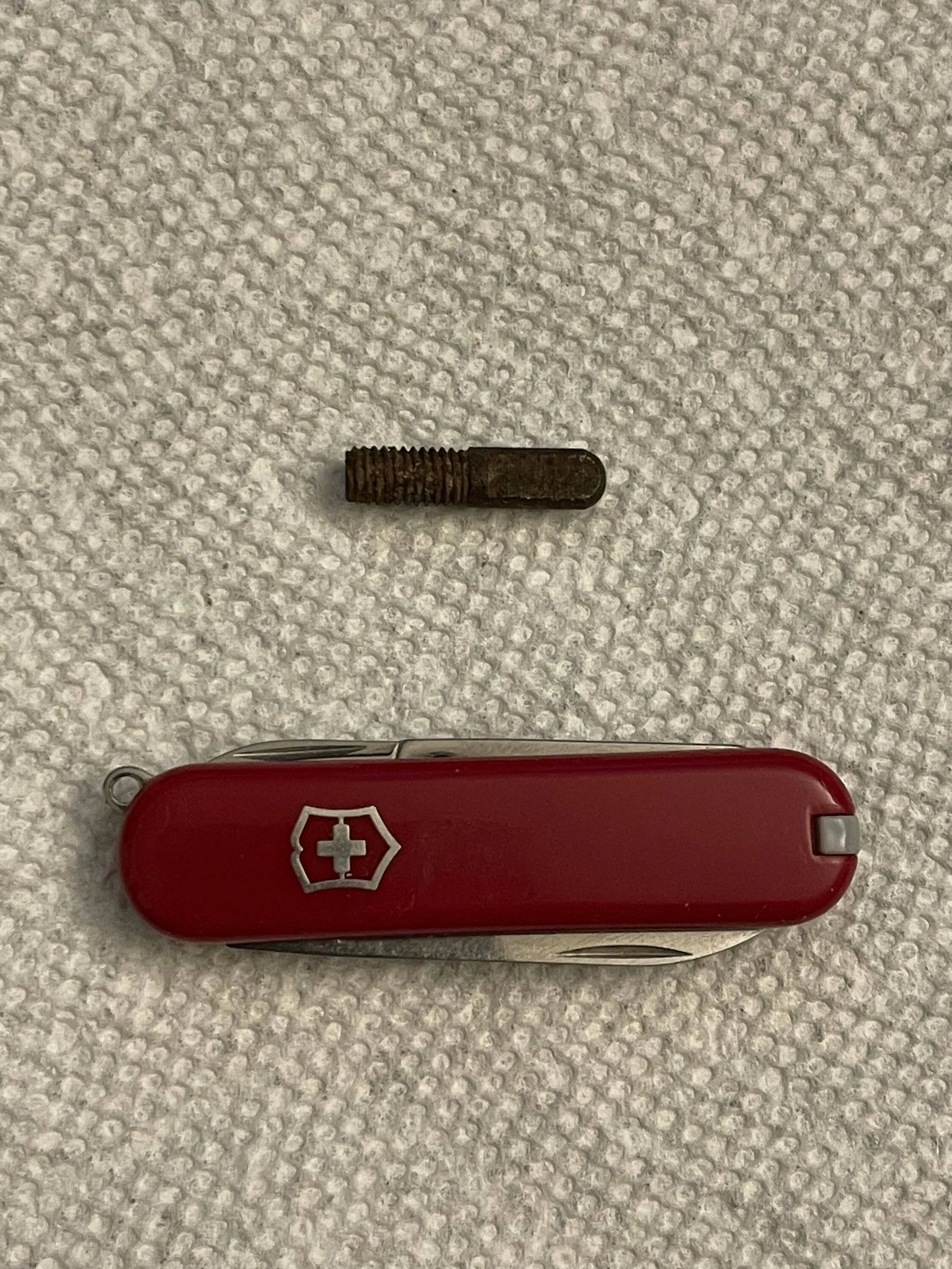

Ladies and Gentlemen, I present to you…the cause of all my headaches…a…a…thing.
The pocket knife is for reference scale. It is 2.25 inches long.
They said it was a plug for the antenna used during shipping since those are installed by the dealership when the vehicle reaches destination. Not sure if they are right, but it sounds possibly correct. Since it was under the headliner, they said it had to come from manufacturing and I agree.
