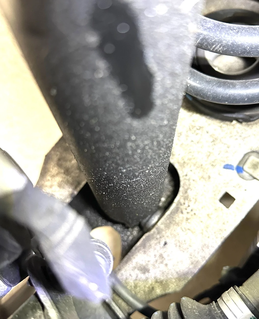

I had a previous post about the right rear shock leaking on my 2025 BL with 6800 miles.
Took it in Monday for my appointment. They called me mid-day Monday and told me the shock is not in stock at their San Diego warehouse.
Not encouraging. Since it is a warranty replacement, they would expedite it from Detroit via Fedex.
It did come in this morning, it was replaced and I picked it up late morning today.
I give them credit for doing all they could to find the part. Never any issue with the warranty.
Looks like another replacement part that is in short supply.
Before & after pics. I didn't pull the tire to check the new shock so the photo isn't great.
Ford Bronco Sport Right rear shock replacement follow up 10

The only reason I found it was I took the tire off to get a leak fixed. If you rotate your own tires it will be obvious.
