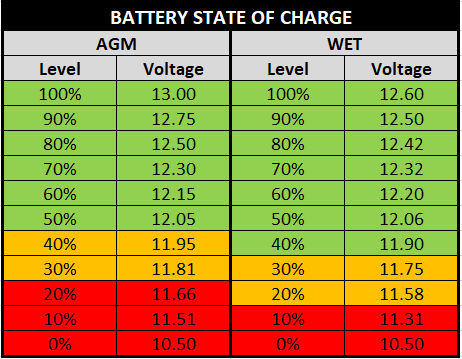

Yep, that's not surprising. 12.1V is about a 50% charge ("SOC"). Check out this chart:
Ford Bronco Sport Resting Battery voltage high -- 12.89V 1667158100243
My concern is not that the battery will not start the BL, but that its life has been shortened. It may need to be replaced sooner than normal (but outside Ford's warranty).
If that's the case, it isn't the end of the world -- but it's reasonable to expect a new vehicle to have a battery that is in like-new condition.
