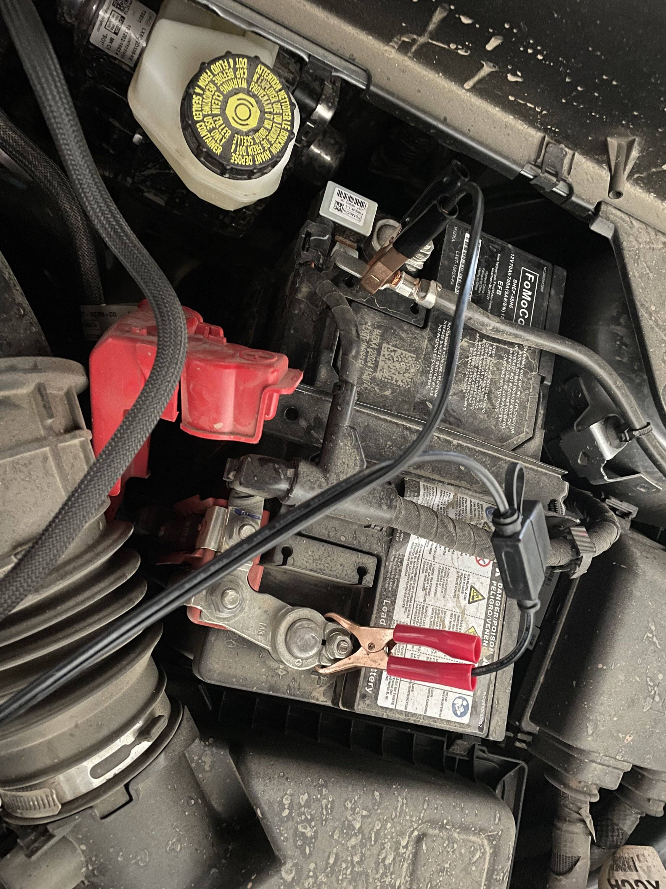

For trickle charging 1-3 amps is a good range to use.
Be sure to connect the charger correctly or the Ford BMS won't recognize the battery's state of charge.
You do not want to connect to the negative battery terminal directly, attach the charger negative clamp to the ground lug that's on top of the right-side wheelwell to the right of the battery.

Thanks for the tip - even though the NOCO instructions clearly say it's ok to connect to negative post...??
Do you have a picture of that ground lug?
Or could you please describe it better. Is it a protruding ..thing ... just for that??
Just to make clear: right side ...??? ... seen from the front of the hood (driver side) ( the side closer to the battery?) ...
or seen from the inside (passenger side)?
Thanks

Here is an updated version of how to properly charge your Battery on a Ford with the BMS system. mine, on the charger
Ford Bronco Sport Regular Lead-Acid or AGM Battery? 1A6186A4-CA7B-469D-AE0C-A4686DF6B4C2

Thanks, Bluebaru!
I completely understand your point of NOT connecting directly to the negative post.
However, the video is a different vehicle and everything is set up differently. So-nothing about that lug RSH mentioned. Connecting to ANY other solid part of the frame is difficult since everything is painted.
What I can see from your video is connecting just slightly off to the side of the negative post / after a sensor. Again - I'm not sur if everything on the bronco is laid out like this since I'm not looking at it right now. Please excuse my ignorance but I'm not a mechanic.

PS: So I just come back after checking again.
I'm pretty sure now what you were referring to is the cable going from the negative post (after what looks like a sensor?) to a bolt / lug in the frame for a solid ground connection.
That's where to connect my negative charger clamp - if I'm not mistaken.
Apologies for wasting your time.
However, please feel free to correct me if I'm wrong.
Thanks

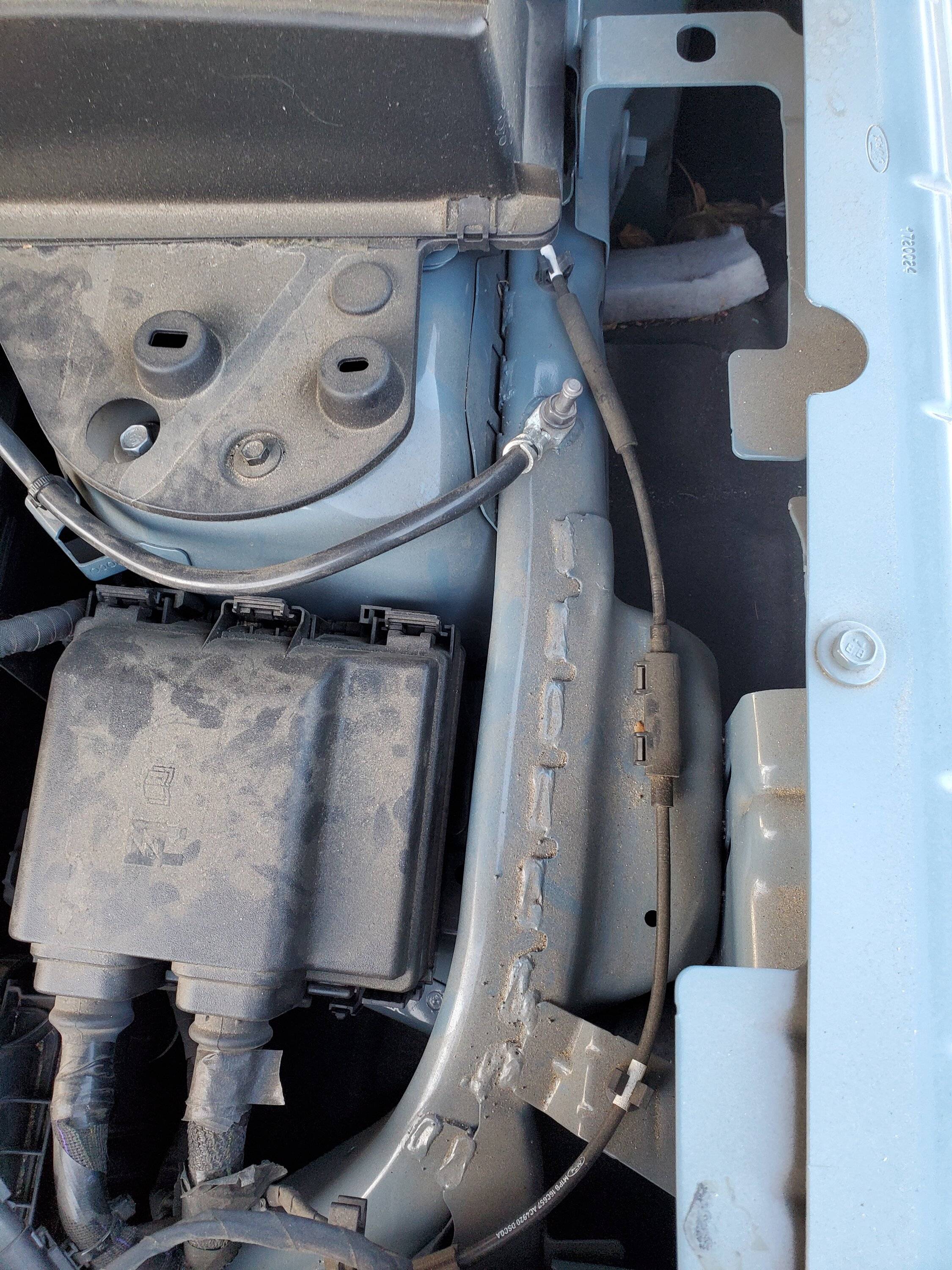

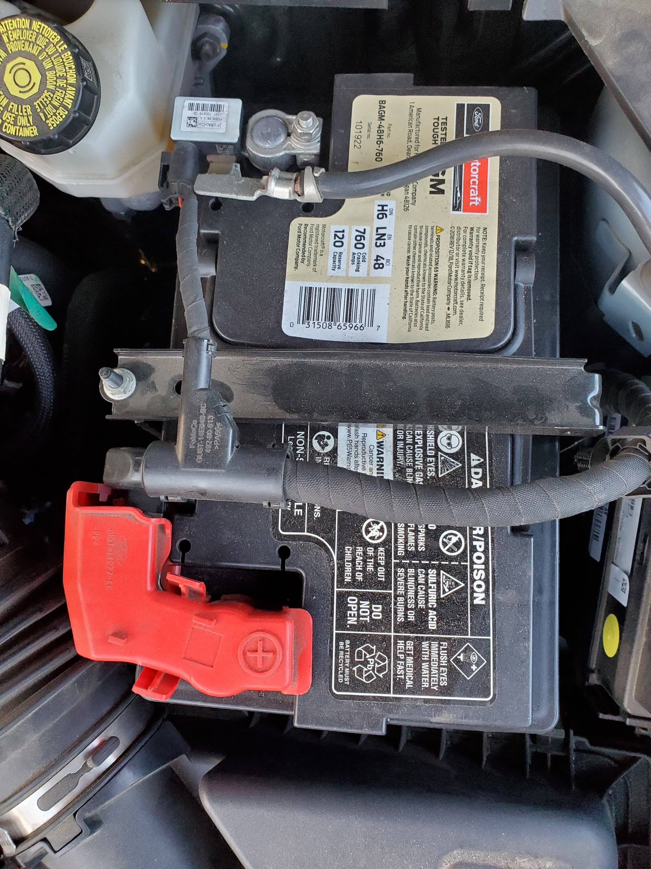

RSH
1,345
1,954
Here is a photo of the the BMS sensor and the ground lug from my Badlands
