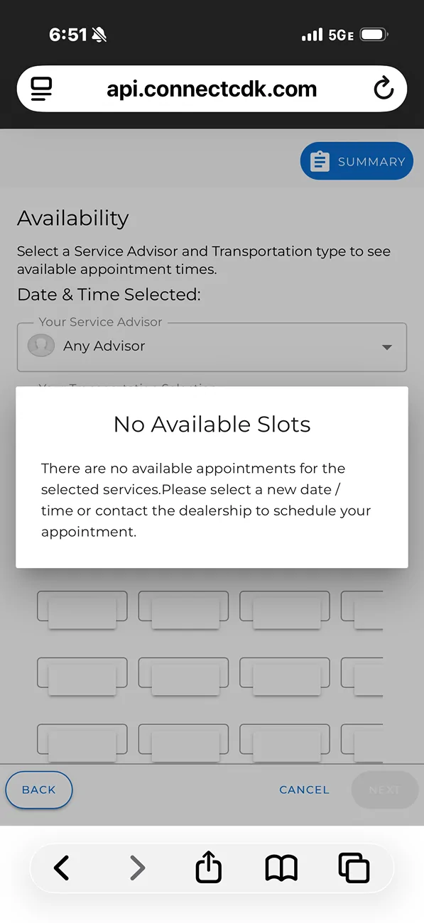

I was trying to login to the website.
The app now says schedule with your dealer.

I'm at the dealership now getting the recall taken care of :C
(SIDE NOTE: I had to go to my local dealer website to book my appointment. ALL the appointments showed they were booked through the Ford App).
EDIT: Time in- 8:09 am Time out- 8:38 (approx. 29 minutes) for completion.
