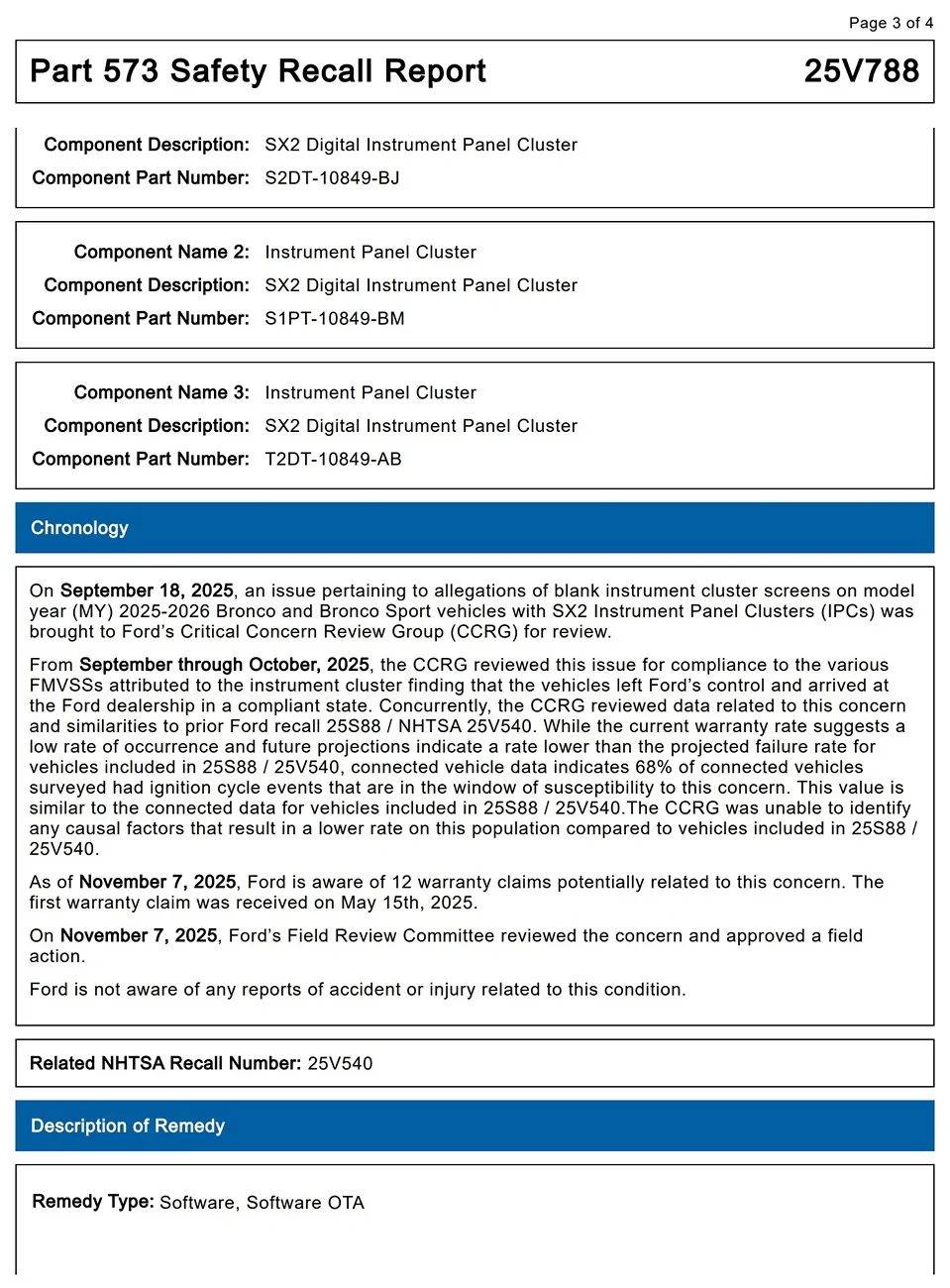

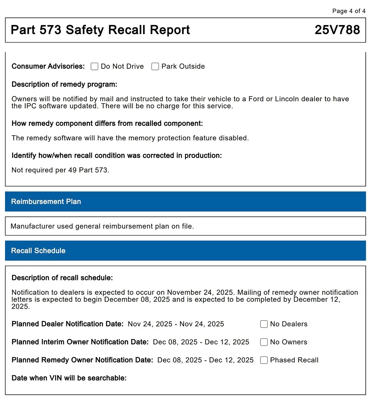

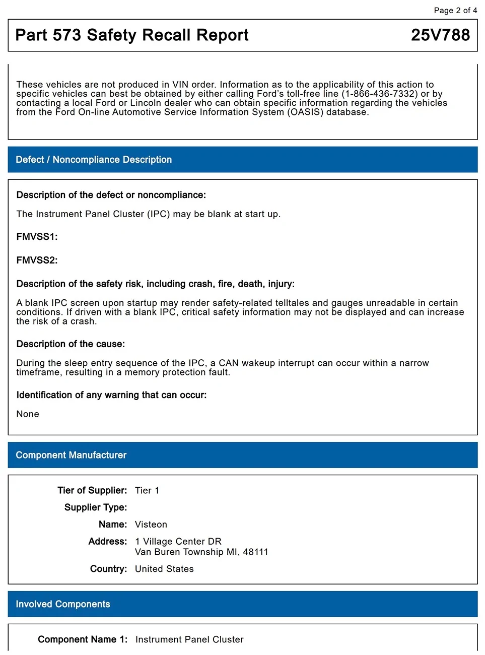

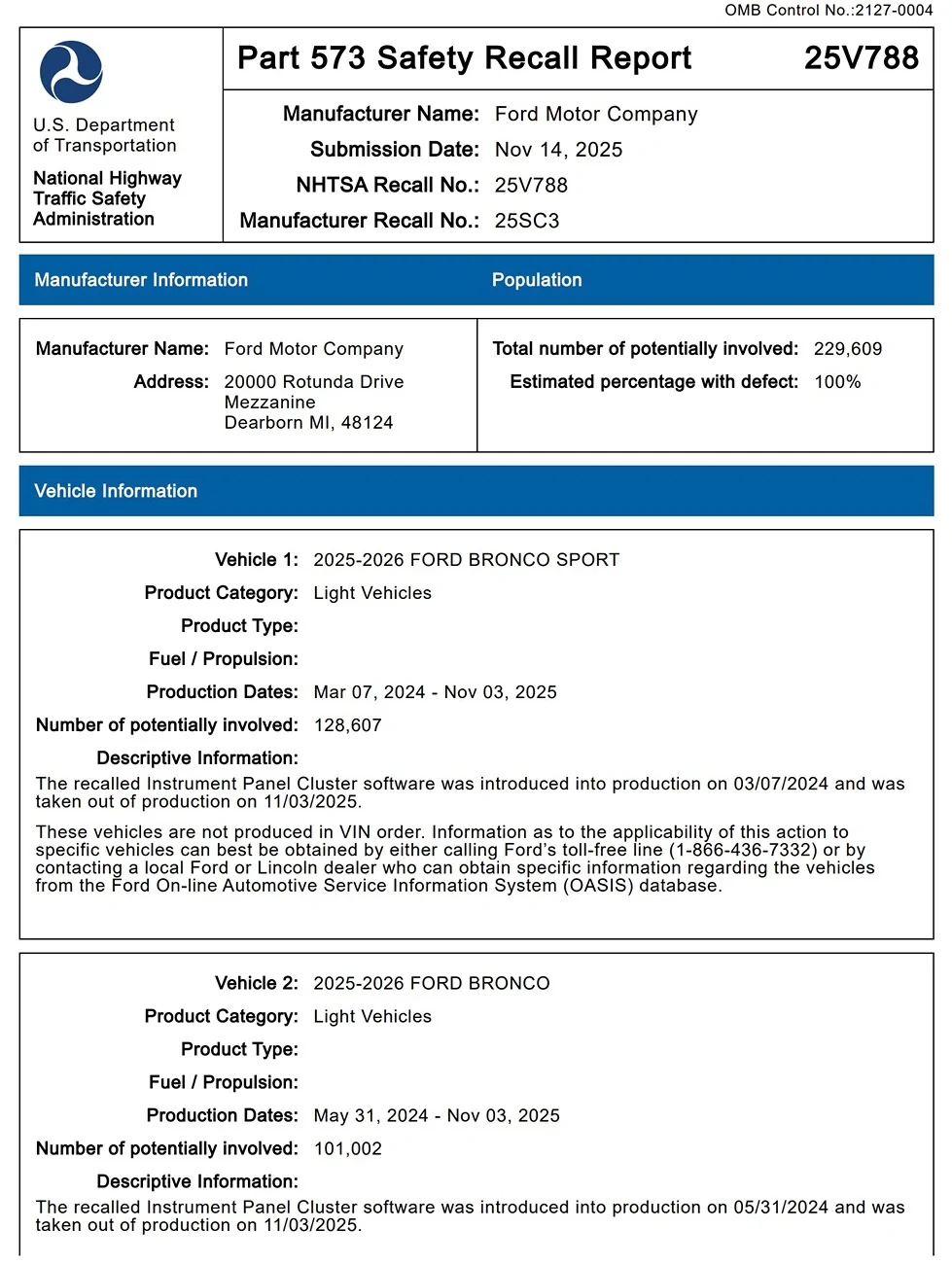

https://www.nhtsa.gov/?nhtsaId=25V788000
November 14, 2025
NHTSA CAMPAIGN NUMBER: 25V788000
Instrument Panel Display Failure
An instrument panel display that does not show critical information, such as warning lights or vehicle speed, increases the risk of a crash.
NHTSA ID Number: 25V788000
Manufacturer Ford Motor Company
Components ELECTRICAL SYSTEM
Potential Number of Units Affected: 229,609
Summary
Ford Motor Company (Ford) is recalling certain 2025-2026 Bronco and Bronco Sport vehicles. The Instrument Panel Cluster (IPC) may fail at startup.
Remedy
The instrument panel cluster software will be updated by a dealer or through an over-the-air (OTA) update, free of charge. Owner notification letters are expected to be mailed December 8, 2025. Owners may contact Ford customer service at 1-866-436-7332. Ford's number for this recall is 25SC3.
Ford Bronco Sport Recall: Instrument Cluster Panel Display Failure (NHTSA Recall 25V788) -- 2025-2026 Bronco Sport {filename}
So did anyone hear this was an issue before the recall. I dont recall it being mentioned.
elvisimprsntr
Elvis
Feb 21, 2025
160
278
'25 BS BB
First recall on my '25 BSBB :sadface:
If I have automatic OTA updates enabled, will it automatically update?
The text from the recall seems to imply I still have to schedule when the OTA update is performed.
