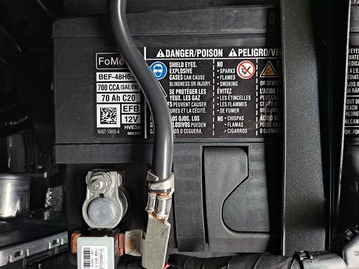

How would you know if you have a EFB Battery? MY recall was done last week.
Thanks
The battery label looks like this: It says EFB right below the rating on the left side.
Ford Bronco Sport Recall 24S24: NHTSA CLOSES FORD BRONCO SPORT 12V BATTERY INVESTIGATION EFB Battery
