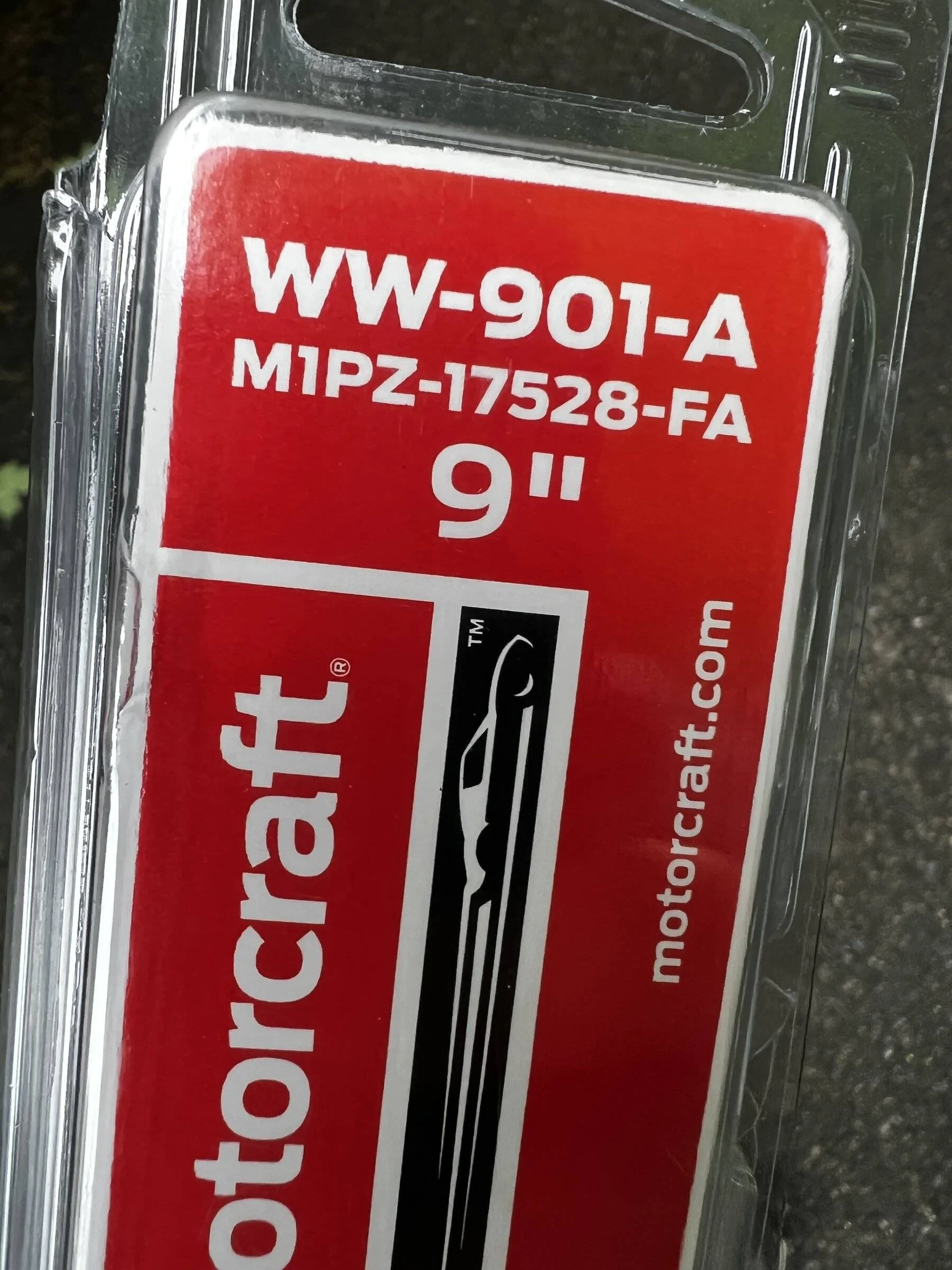

The only place I found to have one was the dealer.
You have to yank it like you mean it. You won’t break it even though you think you might. Under $20

Life saver... my rear wiper went to shit a few months after i purchased it. Even when i called local ford parts they didnt have any in stock and didnt know when they would get them i just gave up. But, i searched motorcraft wiper blade ww901a in amazon and found one.
