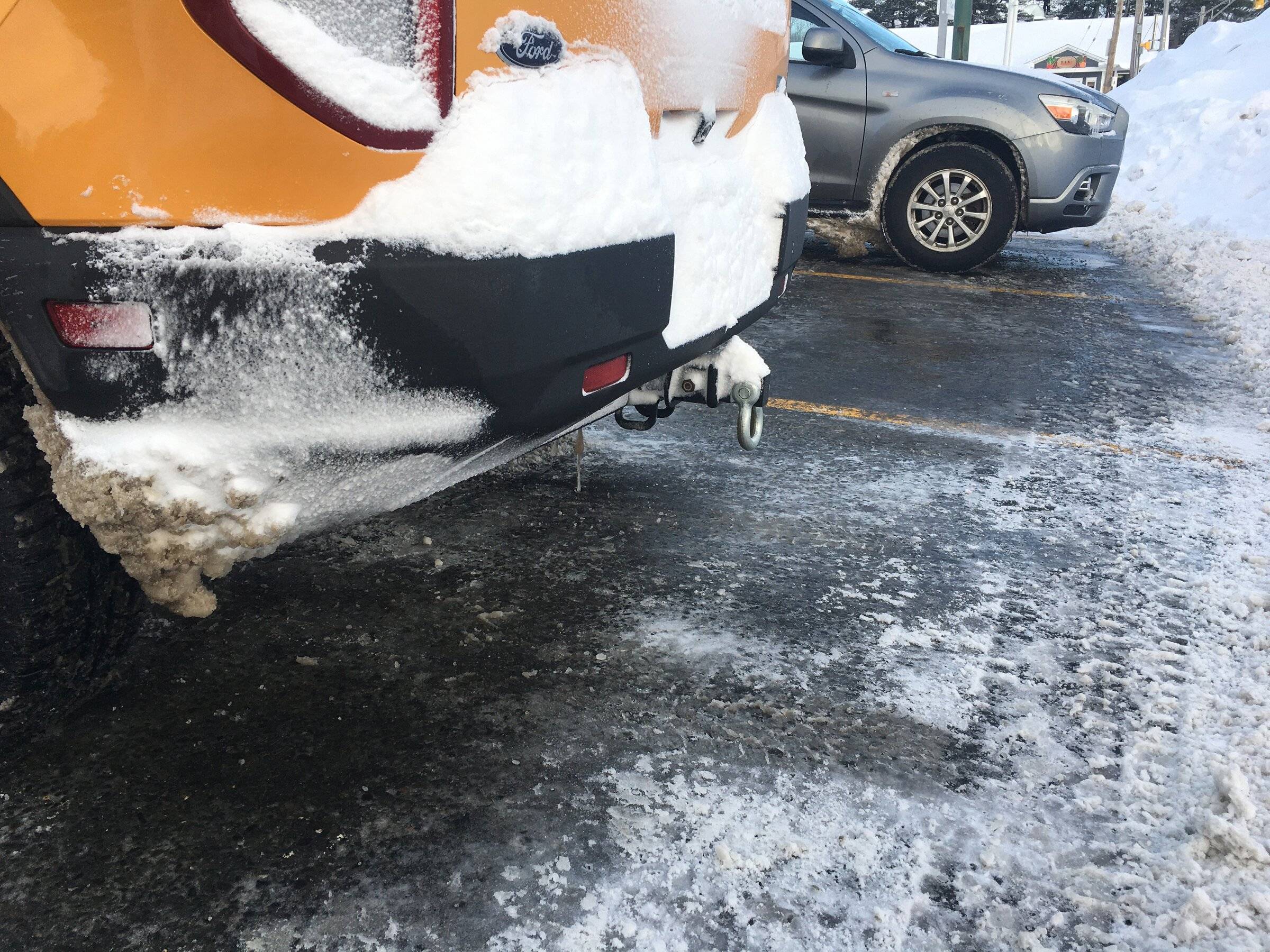

Goinbroke2
Goinbroke2
Jan 19, 2022
198
329
Nova Scotia, Canada
2021 Bronco sport badlands
Ford Bronco Sport Rear recovery point?? A1D48381-AAFE-4BCD-8F85-E4F196A1846A
This is the receiver hitch I got plus a 7/8” “bubba rope” which is the best recovery device I have used to date!!
Used this several times already, works great!
