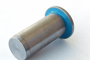

The rivet nuts in the photo are corrosion proof, but the hole in the sheet metal isn't. I would look for a fastener with a seal to prevent water intrusion, such as these.

I don’t think there is any metal behind the license plate holder. Okay, I’m sure there is metal there somewhere, but what I mean is that the license plate is held on with only plastic.
