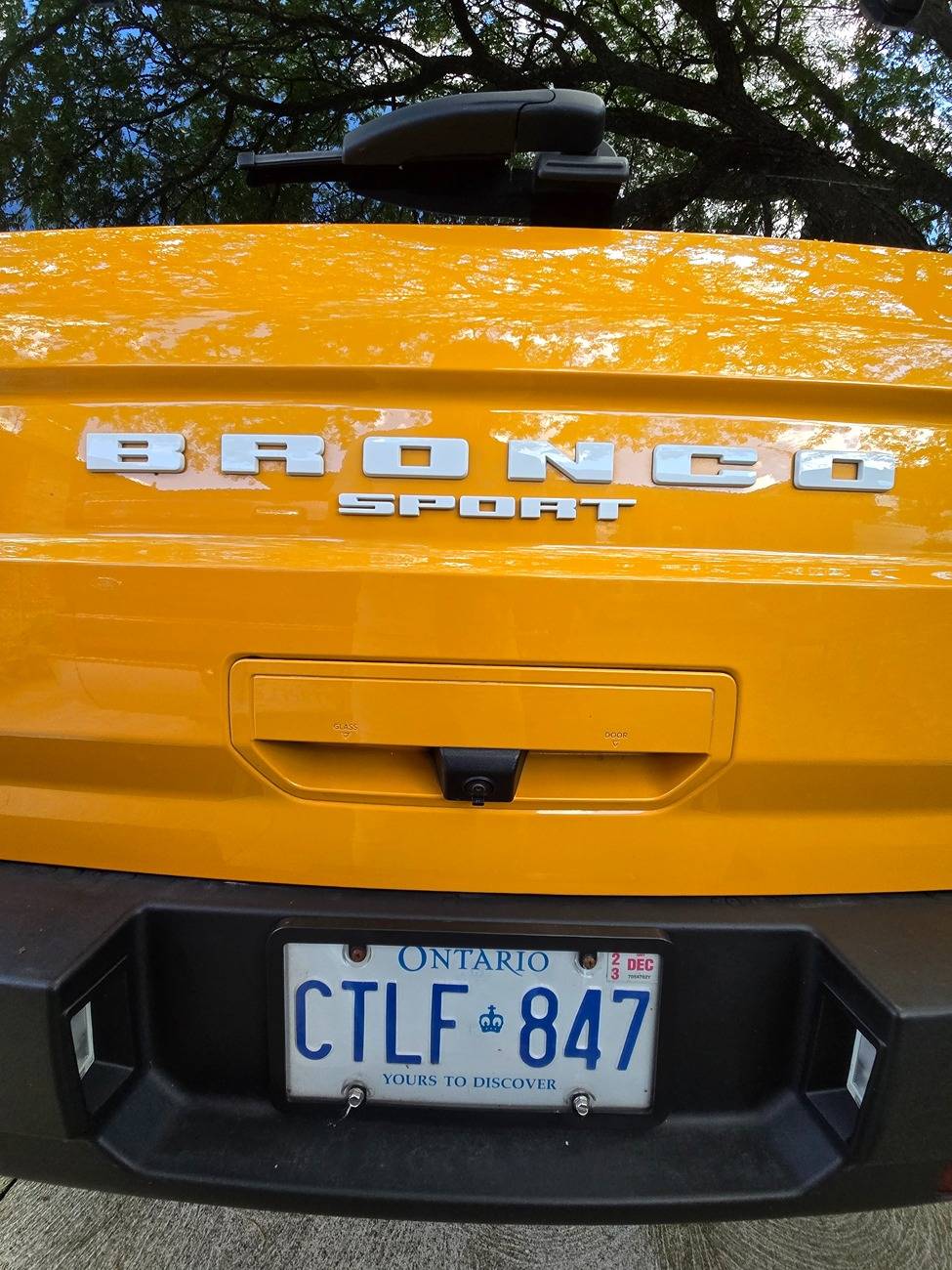

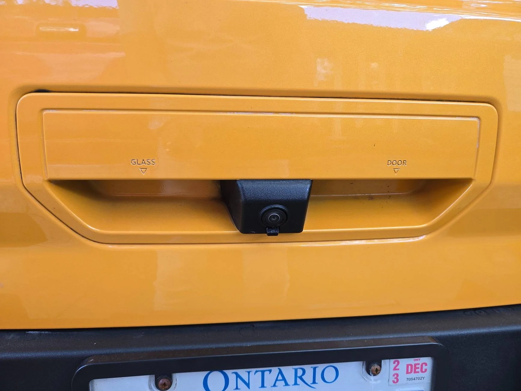

Hello. I have a question. Can anyone tell me how I can tighten the trim plate that is on the bottom of the hatch door of the Bronco Sport. This is the trim plate that includes the two buttons, one to pop open the hatch window (left hand side) and the other one (right hand side) opens the actual hatch door. The plate (trim) is loose and I am trying to determine how to tighten it. Thanks in advance.
Ford Bronco Sport Rear Hatch Door Trim Plate Around Glass/Door buttons Loose 1000005320
Ford Bronco Sport Rear Hatch Door Trim Plate Around Glass/Door buttons Loose 1000005321

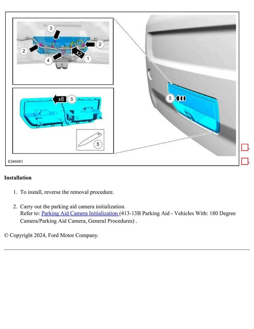

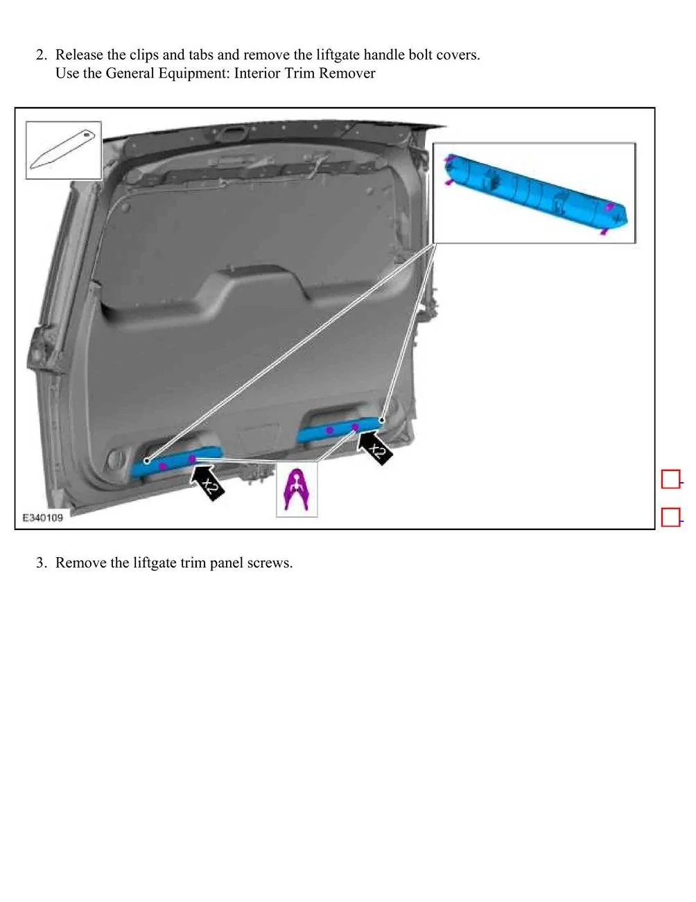

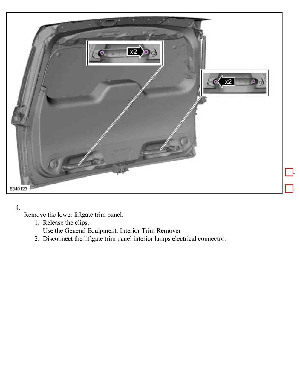

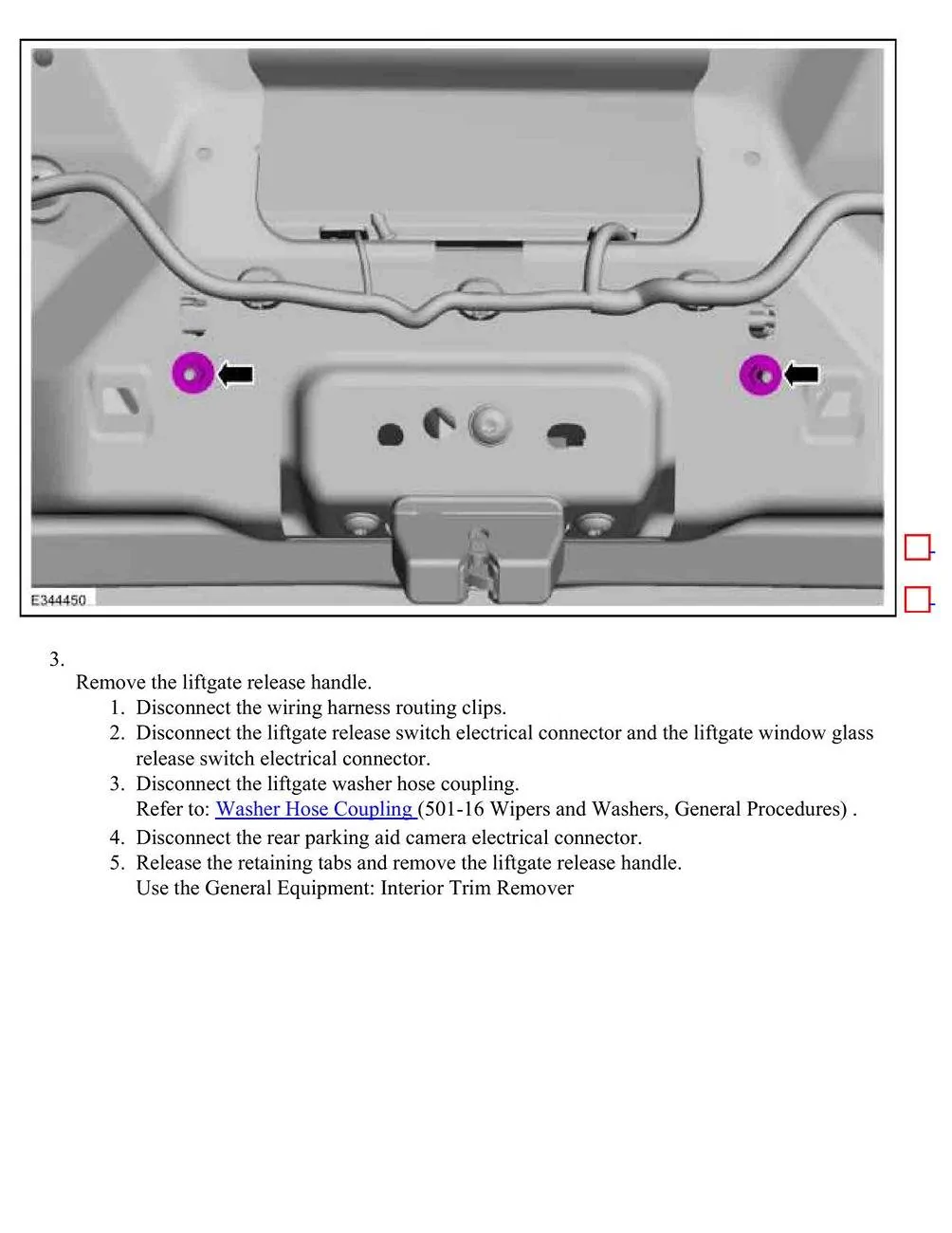

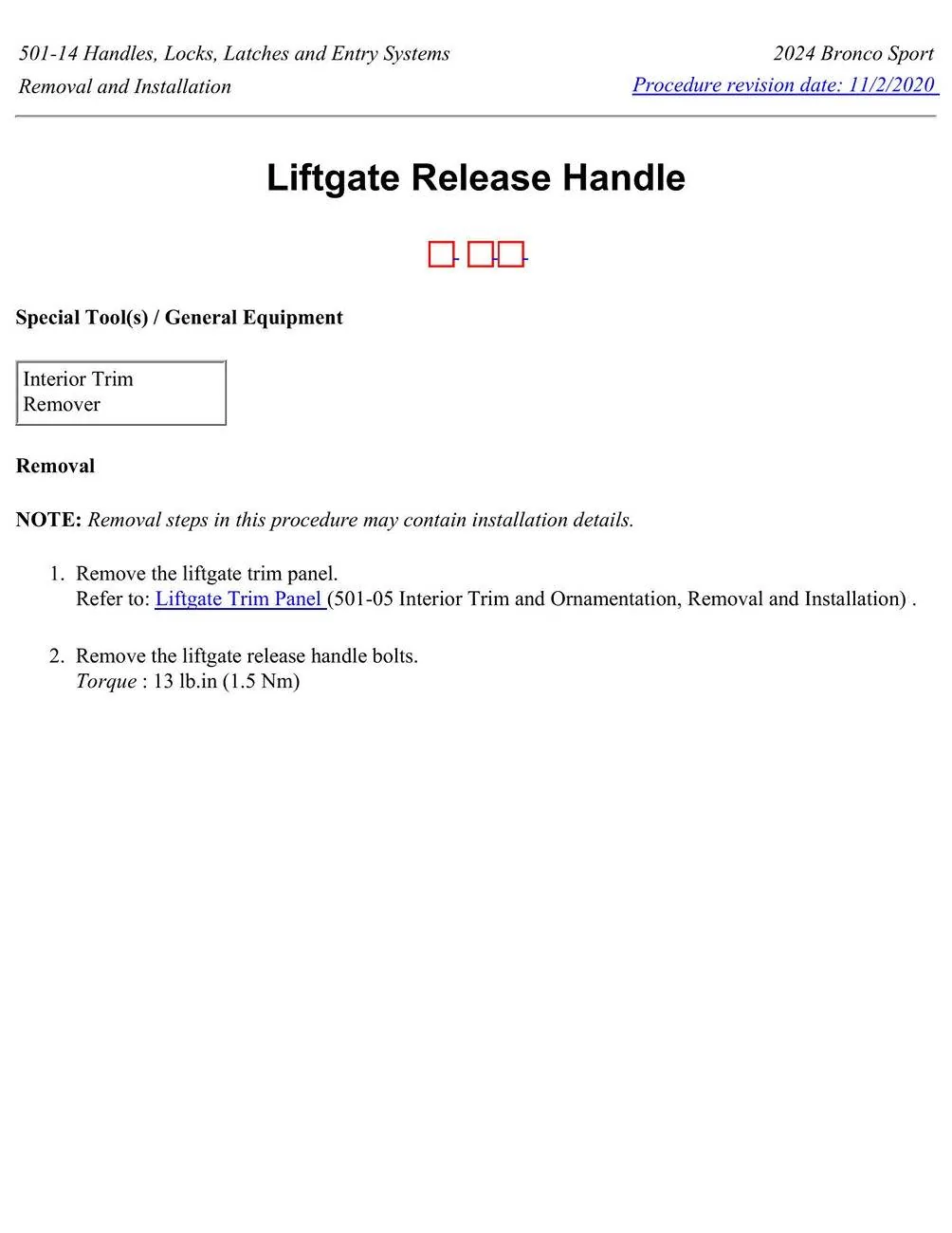

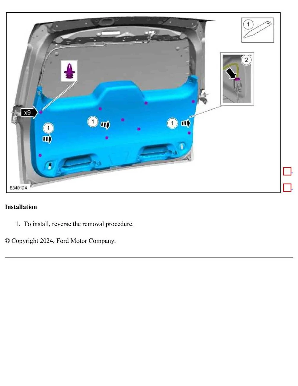

Maybe this will help 01-02
Probably not the easiest solution you were hoping for!?!
(Note: first time posting here, not sure how to upload in correct order, so, you are on your own for that) Good Luck!

First of all, thank you for having taken the time to provide me with this detailed information. I knew that I would more than likely have to remove the trim panel over the hatch door but I had no idea that so many other steps were going to be necessary. Yikes, it looks daunting. I am going to see what I can do. Thanks you again.
