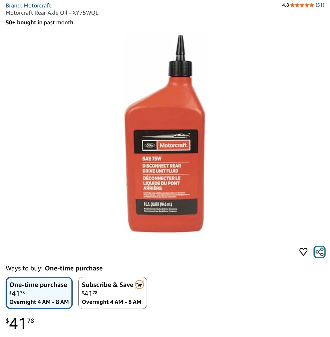

Bringing this back up for updates from anyone using Amsoil instead of the Motorcraft. I just went to my local Ford dealer to buy 2 quarts of the OEM stuff for me to drain and fill the PTU and RDU. As I understand it, both use the same XY-75w85-QL. The parts guy brought out two quarts, rung them up, and presented me with a bill for $103. For two quarts. I walked away and found the 75w85 Amsoil product for $23 a quart.
I've used Amsoil often and like their products. This thread is over a year old; can anyone confirm yet if I can use it instead of the obscenely overpriced Motorcraft stuff?
RSH
1,451
2,203
The RDU does not use the same fluid as the PTU
The RDU uses Motorcraft XY75WQL disconnect rear drive unit fluid. Yes it's more costly than other lubricants, it's not like your going to change the RDU fluid at intervals like engine oil so the cost isn't that big of a hit. If your Sport is still under warranty I'd stick with the Factory fluid.
