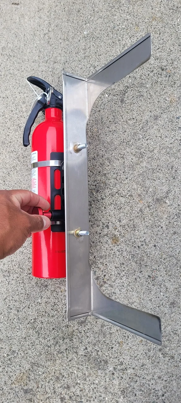

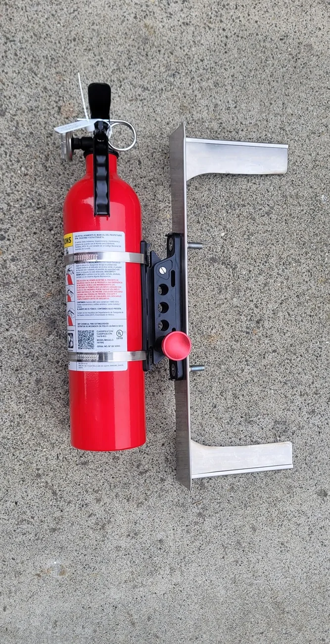

Not much room in the truck area. But here is a bracket I made from some salvaged stainless steel from an old drinking fountain. Rivet nuts to secure quick release mount, and wedged between the seat brackets and the desert does it spacer plates. Tightened back down.

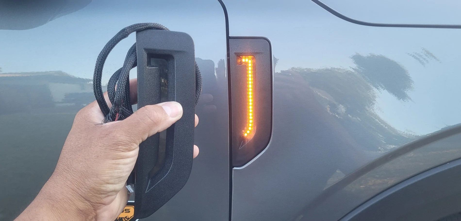

At the supermarket yesterday and noticed the passenger side marker turn signal was burnt out. Ordered a new set and they arrived today. Dressed it up with some expandable sleeving and weather tight ends real quick and swapped them. Back in business. Not too bad the first set lasted about 5 1/2 years. I only changed the passenger side so far since driver side is still fully functional. But will probably swap it also as soon as I get a chance.

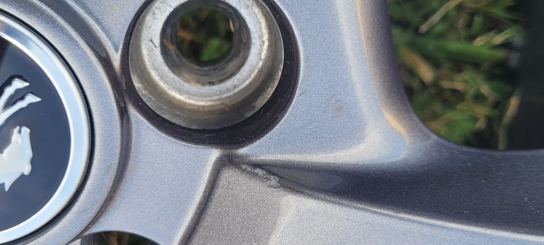

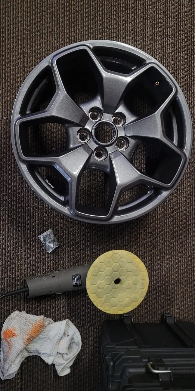

Different spare wheel arrived in much better condition. Still dirty, and had some surface scratches and a couple rock chips. But I cleaned it all up, polished it up, some careful wet sanding on the worst scratches and some more polishing, and a bit of paint touch up. I can't even see the scratches anymore unless I'm inches away looking for them. I think I'll remove the wheel weights before I take it to get a tire mounted. And maybe give it a wax coat after the touch up paint cures a day or two.
