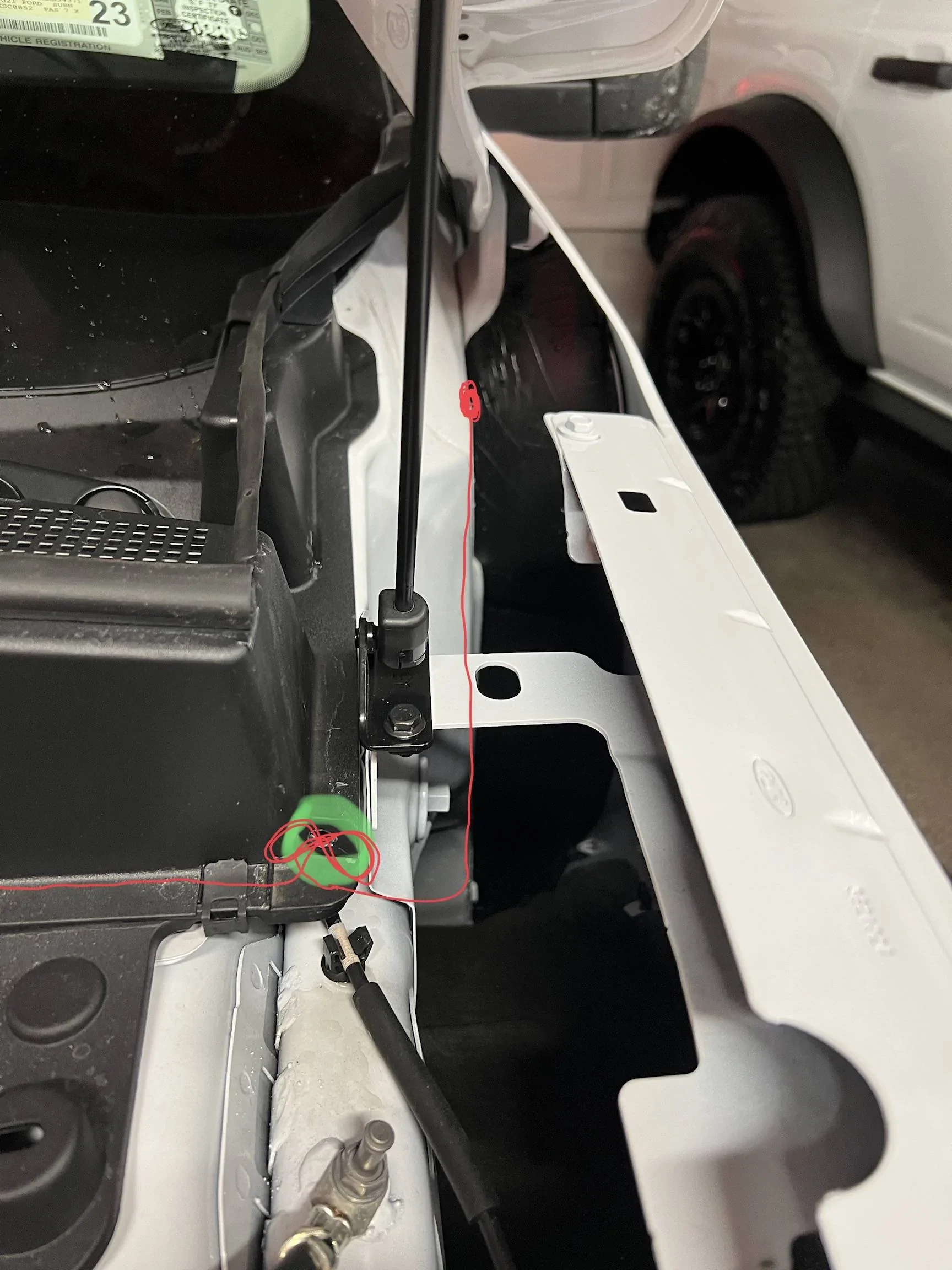

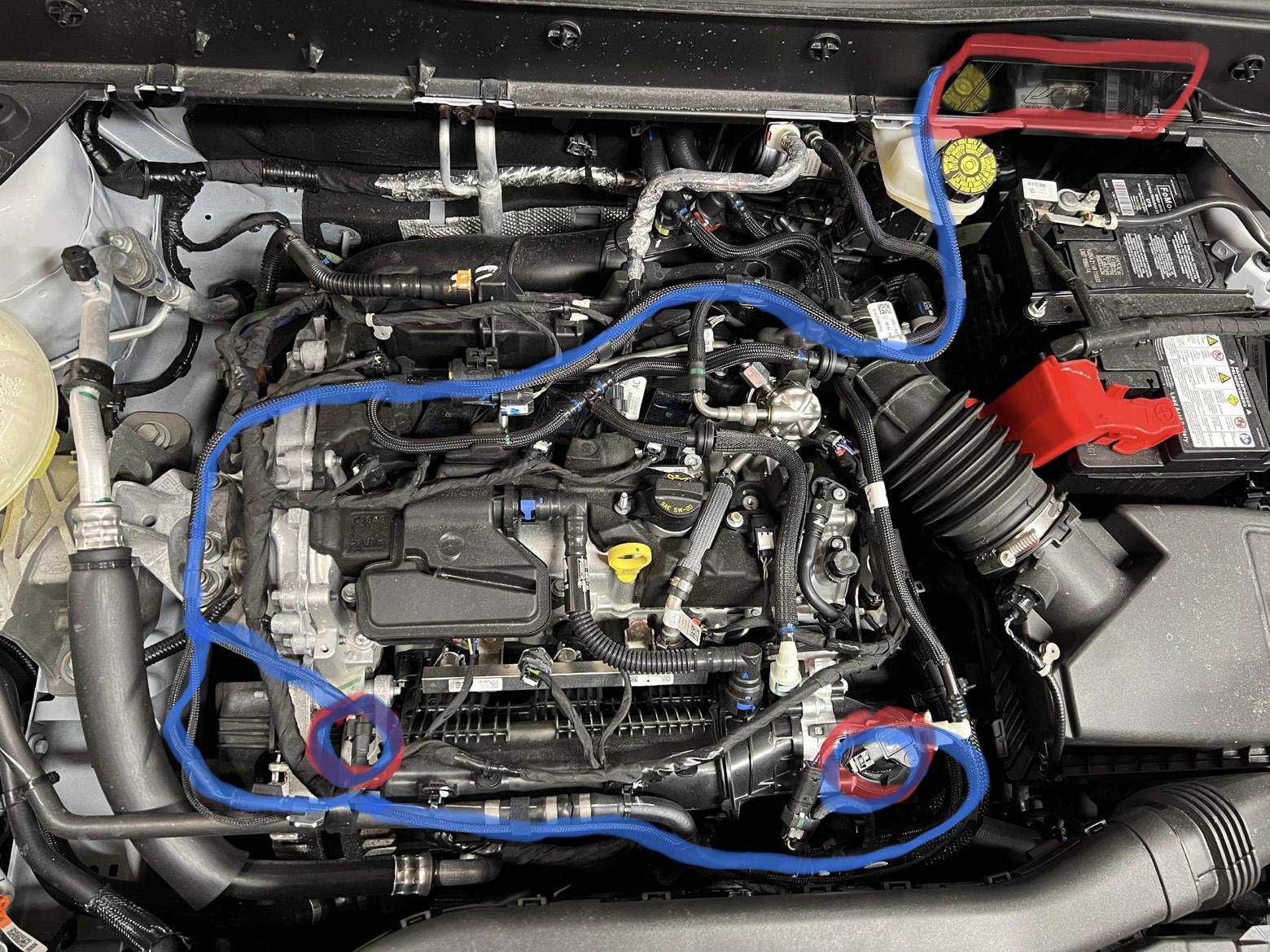

So I got the installation completed over the weekend. Pardon the crude markups in the photos. While the install was easy, frustration developed quickly (more on that later).
First I opened the hood, locked the vehicle and put the key in my bedroom and waited 5 minutes for the computer to sleep (as per instructions).
As you can see, I mounted the JB4 on the plastic guard above the firewall. I used Velcro and it holds very solid. I mounted the Bluetooth dongle to the right of it, away from the box and other metal parts (as per the instructions). I routed the harness as shown. Connecting the middle connectors to the rear MAP sensor and the end of the harness to the front MAP sensor. A few Velcro loops tidied it up a bit. It blends in with the rest of the hose/harness/wiring mess that is under our hoods.
Ford Bronco Sport Pulled the trigger on a JB4 0DDE3EF2-A364-4F17-9BCC-559A01C046A6

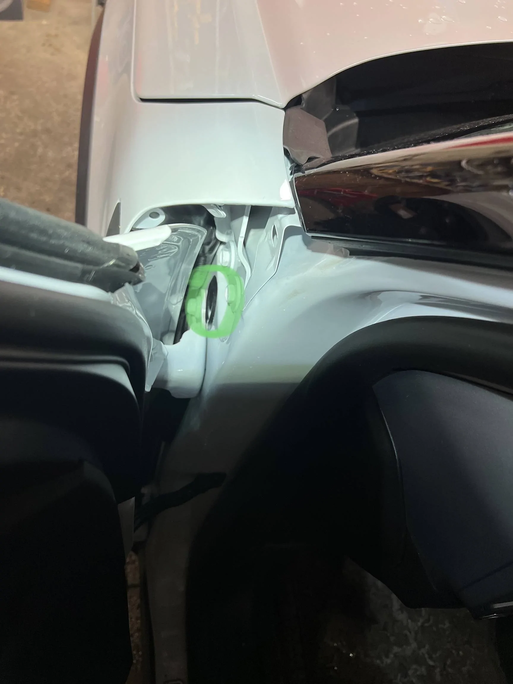

I routed the OBDII harness from the JB4, to the drivers side, (I drilled a hole to wrap the excess wire to) then through the foam separator and ultimately through the grommet in the side of the door jam. This was a tough choice, but the firewall grommet for the main harness is more difficult to get to and the door side positions the OBDII plug right near where it has to plug in to the vehicle. Please note that the photos do not show the actual cable, but highlights and mock-ups (again, more on that later).
Also, please note that you must pop out the grommet, fish a hanger (or equivalent) through the hole and then attach the JB4-side of that harness and pull it back through and route as described. The OBDII plug will not fit through the grommet.
