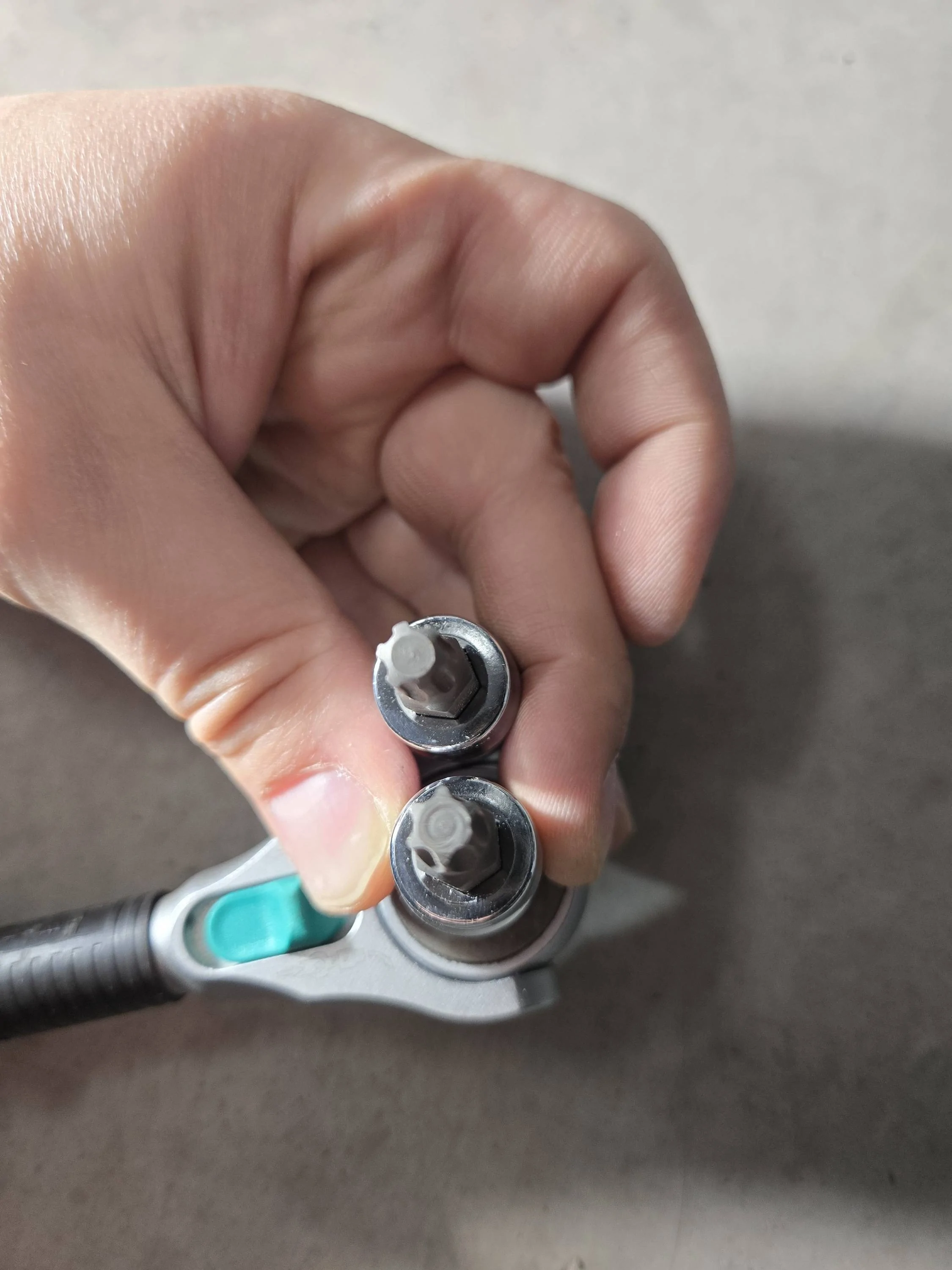

I am removing the underbody of the 2025 BS Badlands Sas. for DIY rustproofing and I just found they switched from Torx to Torx Plus.
I had some Fords but never seen with them until today.
They look almost the same but it will strip, just a FYI.
