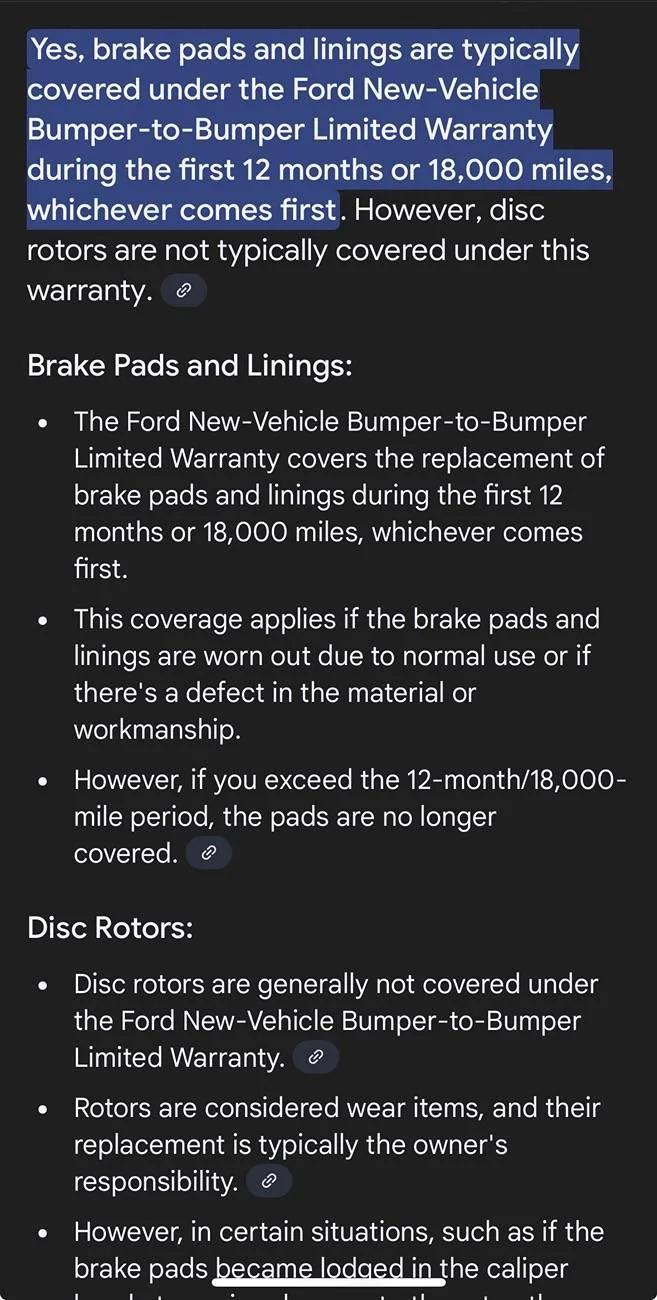

2024 BS 11300 total kms and the rear pads and the rotors are worn badly, Hope to get it looked at next week. My issue is will they warranty it?
Dec 13, 2024
49
1,147
2,928
2025 Badlands Sasquatch
it 1 year for pads 3 for rotors and they said they turn/resurface the old rotors??? I didnt know they still did that
Very much still a thing. Based on the initial rotor thickness and amount of material needing removal, resurfacing can be safely and cost-effectively done more than once.
bonnieblackdog
Mar 21, 2025
Alogoma Canada
2024 Bronco Sport
I remember we did it at one time but the machining and labor costs were more than a set of rotors??
