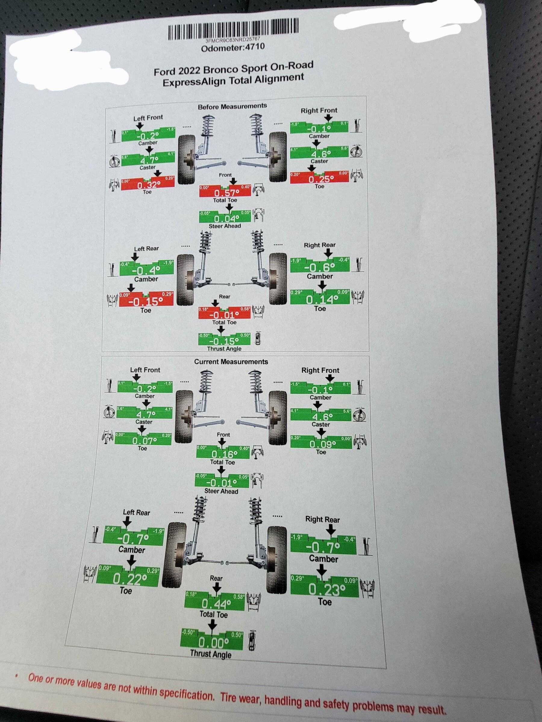

Thanks! It looks like they did a good job on the alignment. Also, it looks like you didn't get camber bolts, in front, or they just didn't make an adjustment with them and while you are within factory spec, of +0.1 to - 1.5, dead center would be -.7*. I'm guessing that the before and after were both done with the springs on the car and that the before, wasn't pre spring install?

Yes both the before and after are with the springs. I do not have cam bolts in the front. Looking at the sheet though I may consider getting some down the road, but as it is at this point it's within spec so there shouldn't be uneven tire wear etc. I'm definitely happy with the angles considering the alterations.
