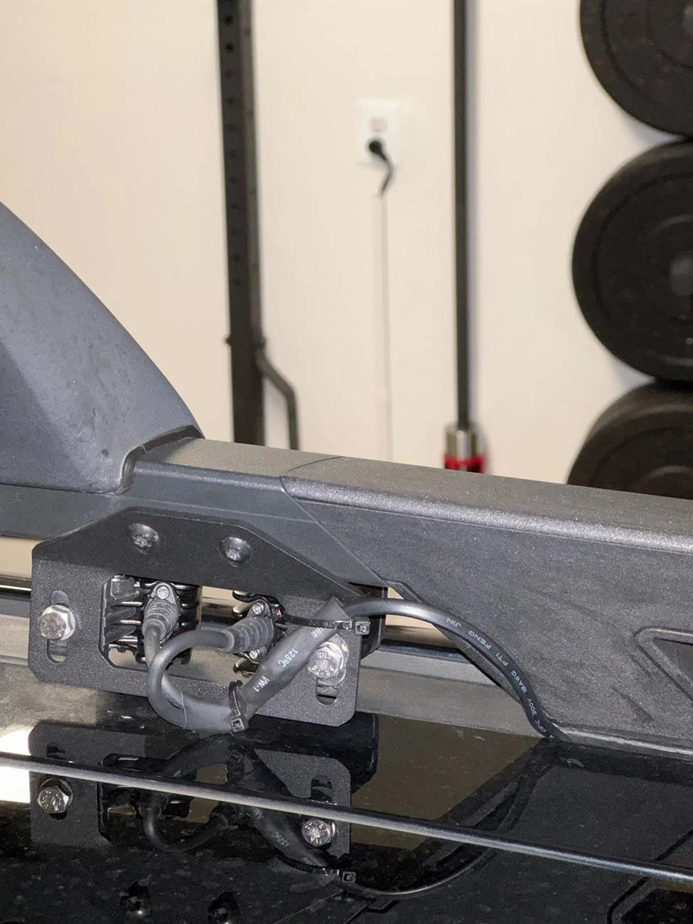

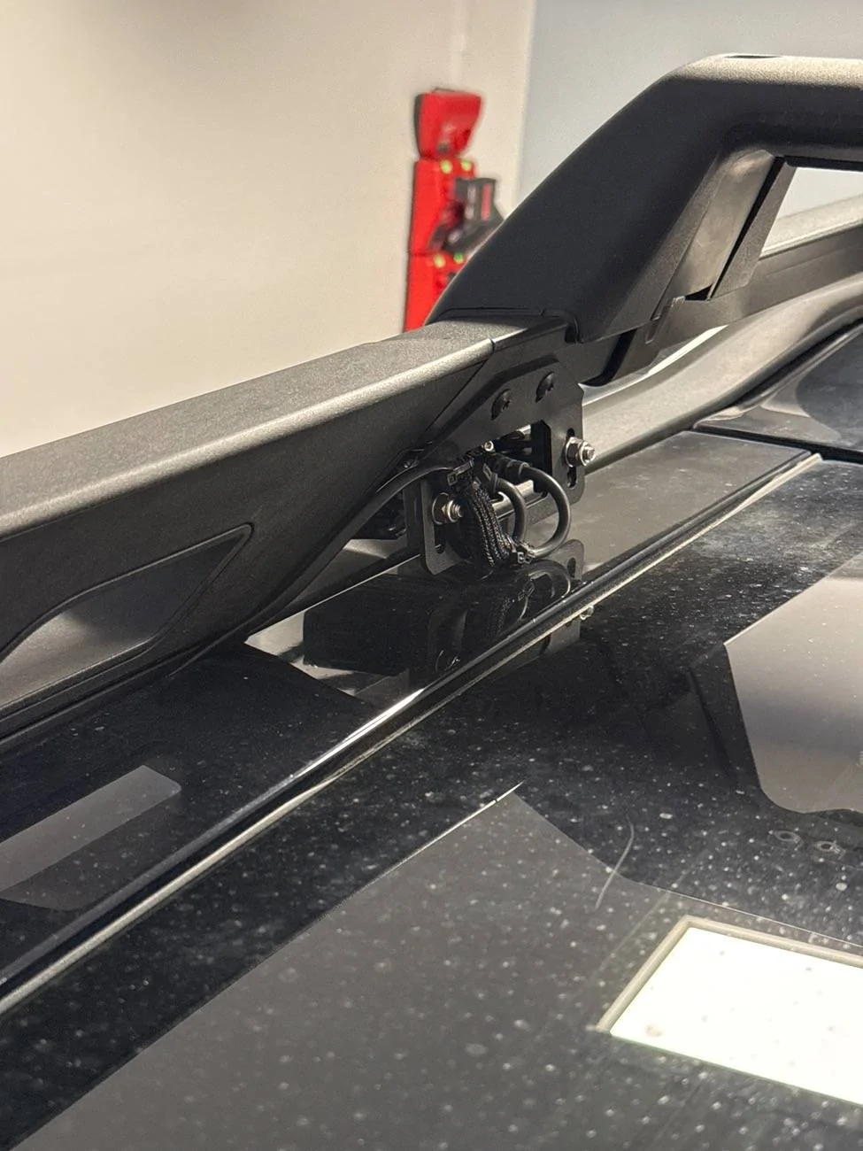

For the first part, the wire I used did indeed have a coating on it so it was like one strand with red and black inside. Since its exterior wiring I wanted it tough. A plastic panel tool will help a lot for shoving wire down into tight places
For the second part; here you go! You’ll want to leave just enough slack to be able to angle the lights, but not enough that it’s sticking out all over

Perfect, Thank you. I do have the set of plastic trim tools. Now I know my insulated wire will fit.
