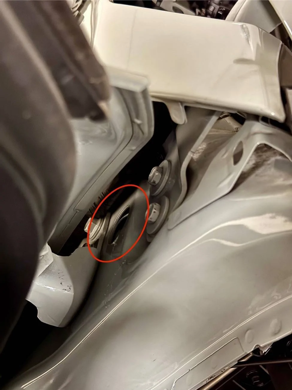

Slick! How did you get the wires into the cabin?
I don’t have a good picture of it at the moment but I used the grommet in the drivers door area, it’s a bit of a pain to get up to but is in a super convenient area overall for running wires from the cabin to the engine bay. Comes out behind the dash above the hood latch. Runs to the engine bay along the inner part of the front fender, there are plenty of cutouts to run cables through from there
I used the grommet down by the pedals for my ACC retrofit so I didn’t want to reuse it (plus having to run all those wires down behind the battery would have been miserable)
