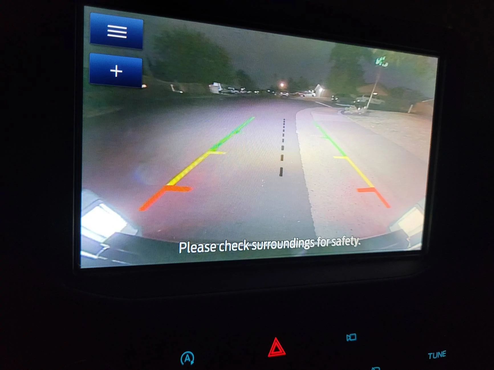

I am not sure if its my camera or of anyone else feels that the back up camera at night is very poor, splotchy looking and hard to see. I suspect it may be related to the light output from the reverse lights not producing enough output for the camera to be effective.
Is anyone else experiencing this and has anyone changed out the reverse lights to brighter bulbs or even LED without error codes?

Before you buy anything, try this (which I learned on the F150 forum when I searched about its too dark backup camera and i found a forum post that lead me to an acceptable solution)
When backing up, you technically don't need your forward lights, so turn them off, manually, with the switch. Don't accept Auto-off here, you have to manually turn the switch to off. This worked for my F150 and it also works for my Bronco Sport. The image on the screen is almost night-and-day in brightness difference.
I park in a condo garage and have to back into the spot because there's a big concrete support column next to my spot. Backing in puts the vehicle between the lights that are along the center of the garage, and the wall behind the spot I'm backing into. Turning off the headlights does the trick.
When you next turn on your Bronco, it will revert to Audo mode, so you don't have to redo that every time as well.

Here's a Dropbox link to a 15 s video of what happens when I turn the lights off manually while in reverse & the camera is on. The freaky flashing is the cell phone camera software adjusting to the brightness change. But I hope you can see there is an overall brightness increase ...
https://www.dropbox.com/scl/fi/05hnksv0nnv1e6n17vide/FordBroncoBackupCamera.mp4?rlkey=w5jm1jqmqr2as65nqrnyf7l73&st=8zzd262k&dl=0

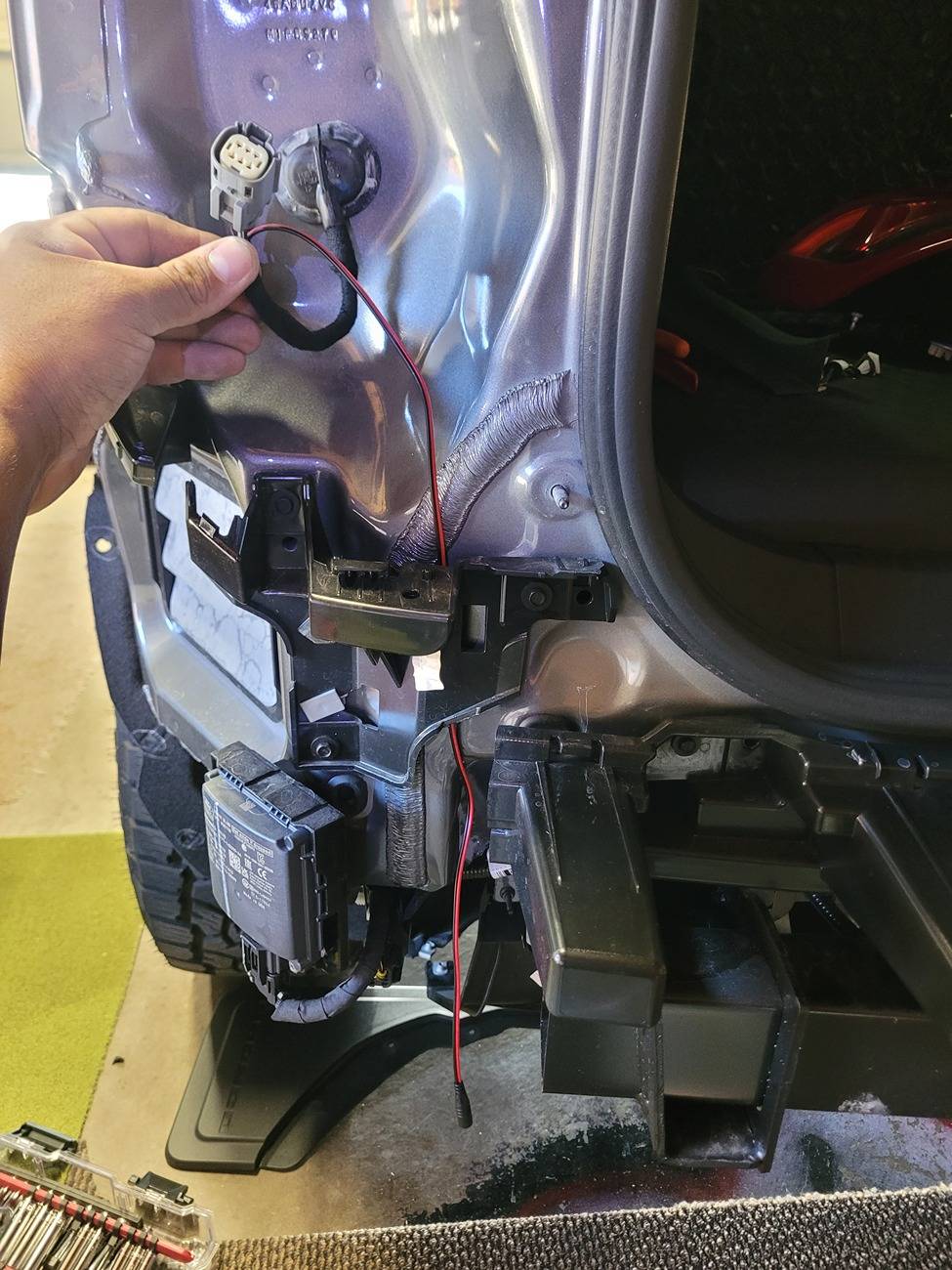

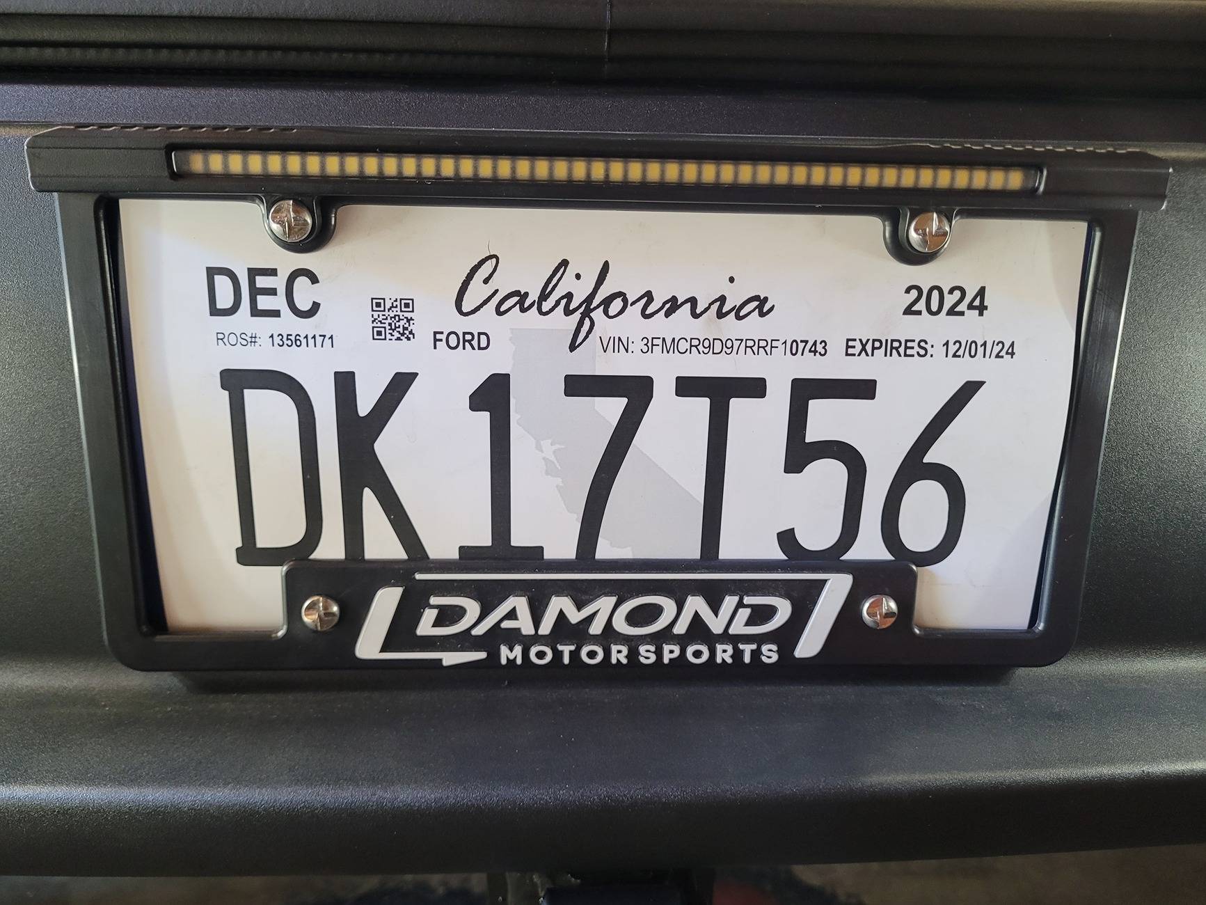

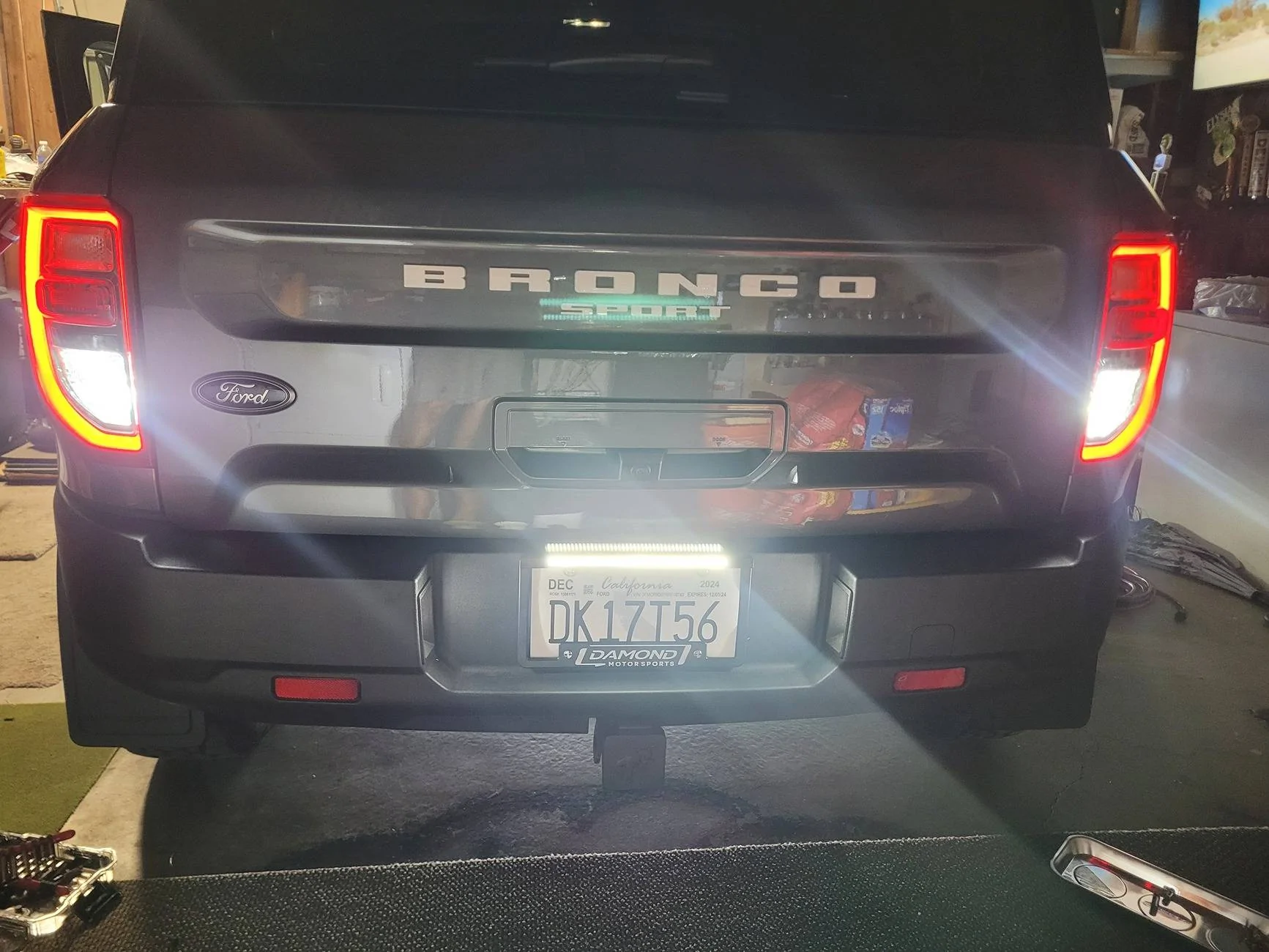

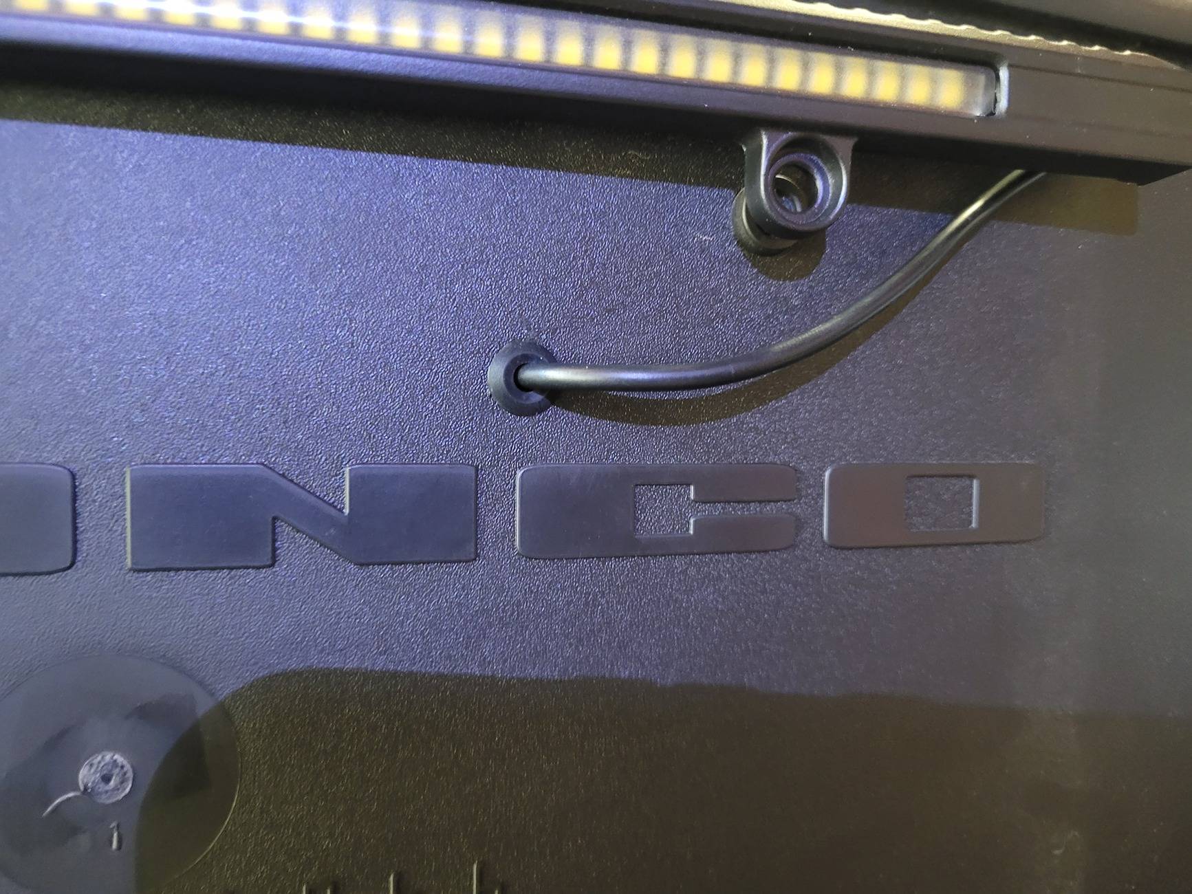

been discussed on the forum before but Baja designs has a tow hitch inserted S1 pod light for reversing. sometimes isn't in stock though.
i have a revere boost bar from Morimoto that bolts to the top of the license plate wired to reverse power. rear bumper removal not necessary. i was doing some other wiring at the same time.
