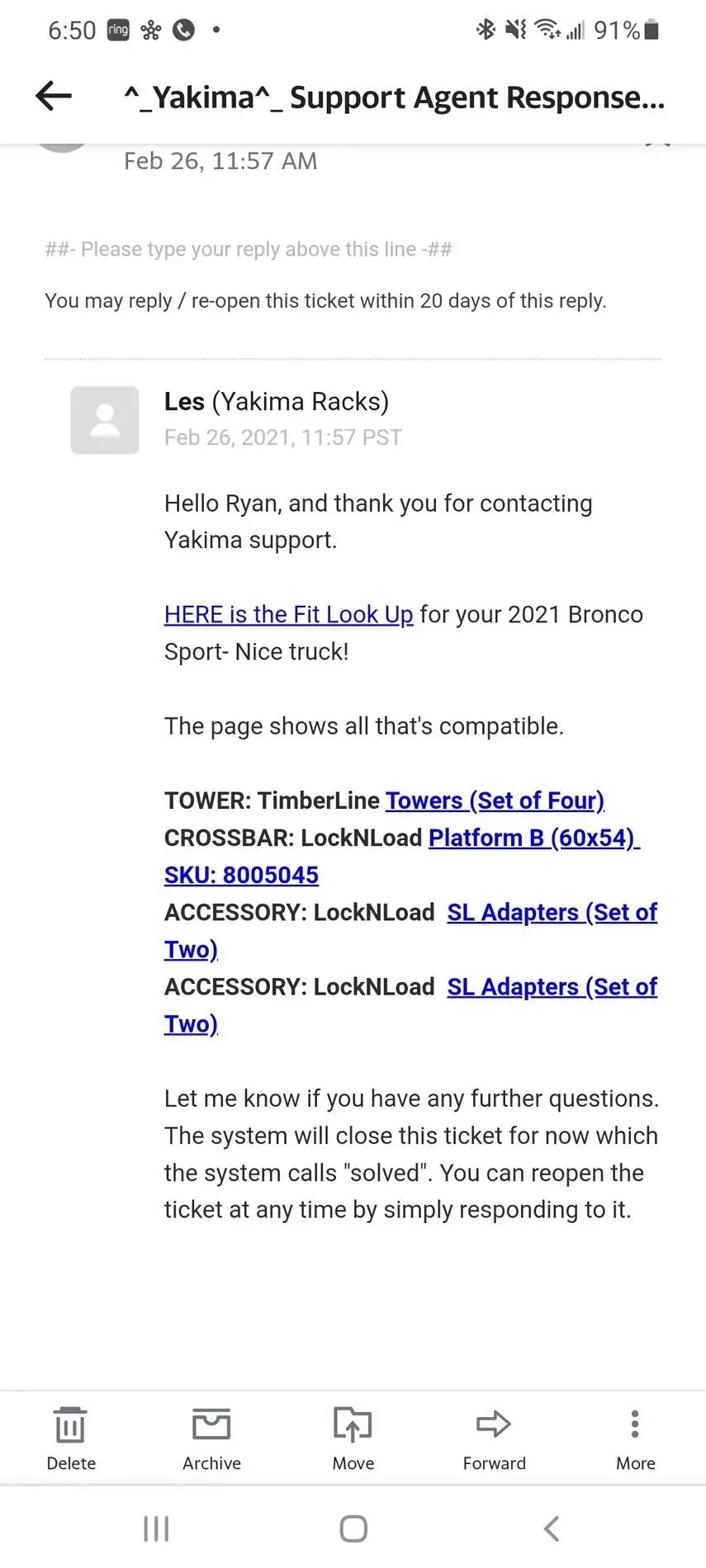

ReRack shows it in stock.
Ford Bronco Sport Platform Racks Screenshot_20210309-185023_Yahoo Mail

That is indeed a Yakima mid-size 'B' LocknLoad rack, with Timberline mounting towers and SL adapters, you might have to add the Yakima lock cylinders if you want those. No crossbars required with the SL adapters, the towers mount directly to the LocknLoad rack, saves you some overall height and a little weight. This rack weighs 65 lbs. Yes, the dynamic weight limits are 150 lbs., or 100 with the moonroof (they are also protecting us against rollover accidents). You can put more up there, but then you just can't drive it! These parts all ARE out there available on eBay -- but still, the whole thing rings up to about $1,000 (from Yakima and I'm sure, Ford as well).
