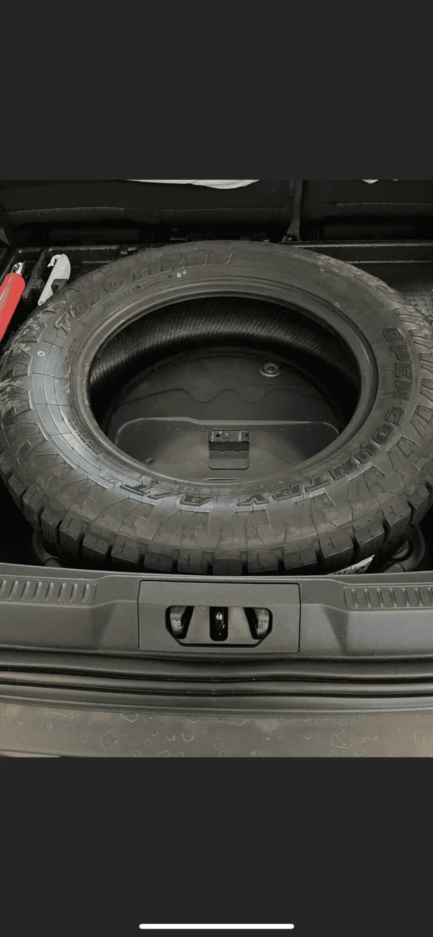

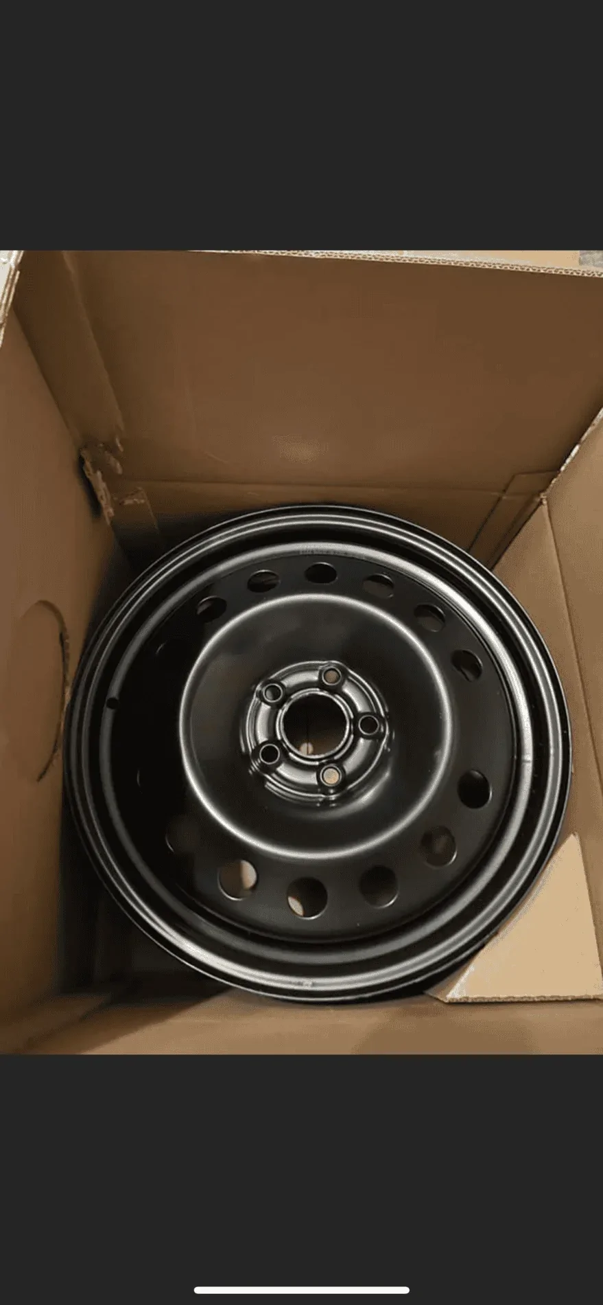

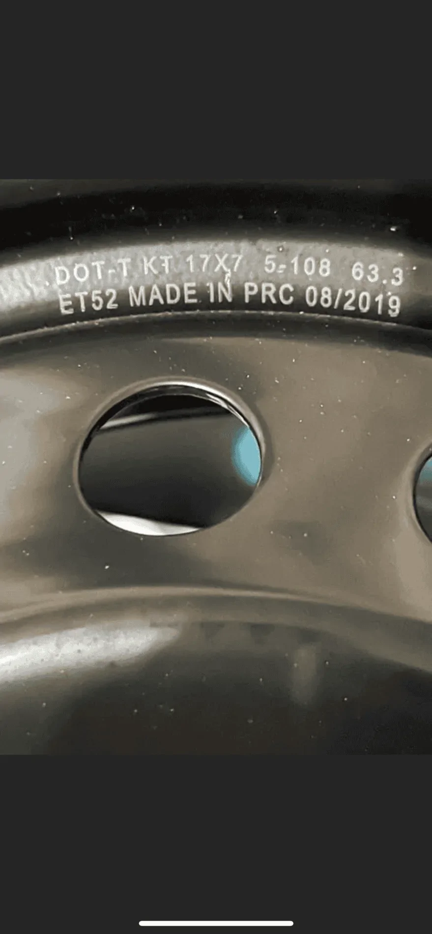

I wanted to mention to anyone not familiar with unibody vehicles and pinch welds. I bring this up because our BS have designated lift points when lifting it for any reason. Our Bronco Sports come with a scissor jack to use when changing/removing a wheel. I personally don’t like the scissor jack and I keep a low profile floor Jack with me. I also use a pinch weld adapter pad for my floor Jack as well. This adapter pad sits on top of the Jack and prevents damage to the pinch welds when lifting the vehicle. I’m also installing Toyo Open Country ATIII 235/65/17 tires tomorrow on my BB. One of the deciding factors for me to go with 235 tires, is that the spare will fit in the spare tire well mounted on my steel wheel I purchased from TireRack.
