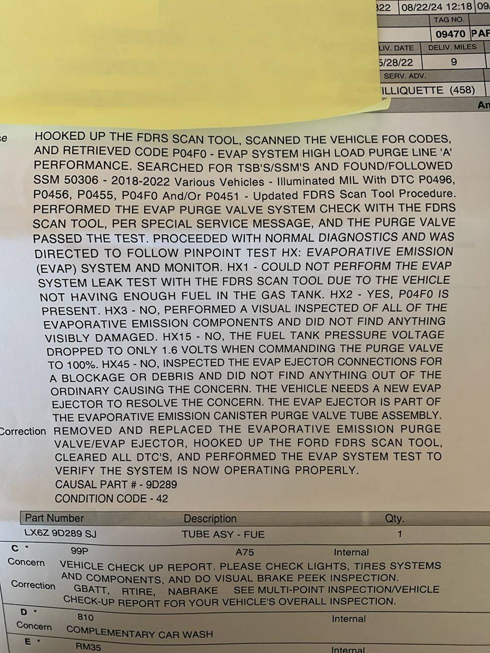

Took to Dealer and they diagnosed the engine light and replaced the parts under warranty.

This is the process they went through. Told me that at 34,000 miles it was a warranty service. No charges.
