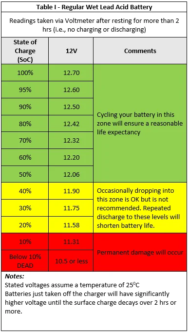

One question I have is why the OE FLA battery was always charged to 100% SOC -- 12.67 > 12.7V? 80% SOC for a FLA battery is ~12.42V. It was never that low (after driving a reasonable distance).

I can just rely on the BT to top the battery off, but intentionally designing a charging system to only charge to 80% SOC seems like false economy. IDK, I guess we'd have to know how much the battery's service life is shortened vs how much fuel is saved.
