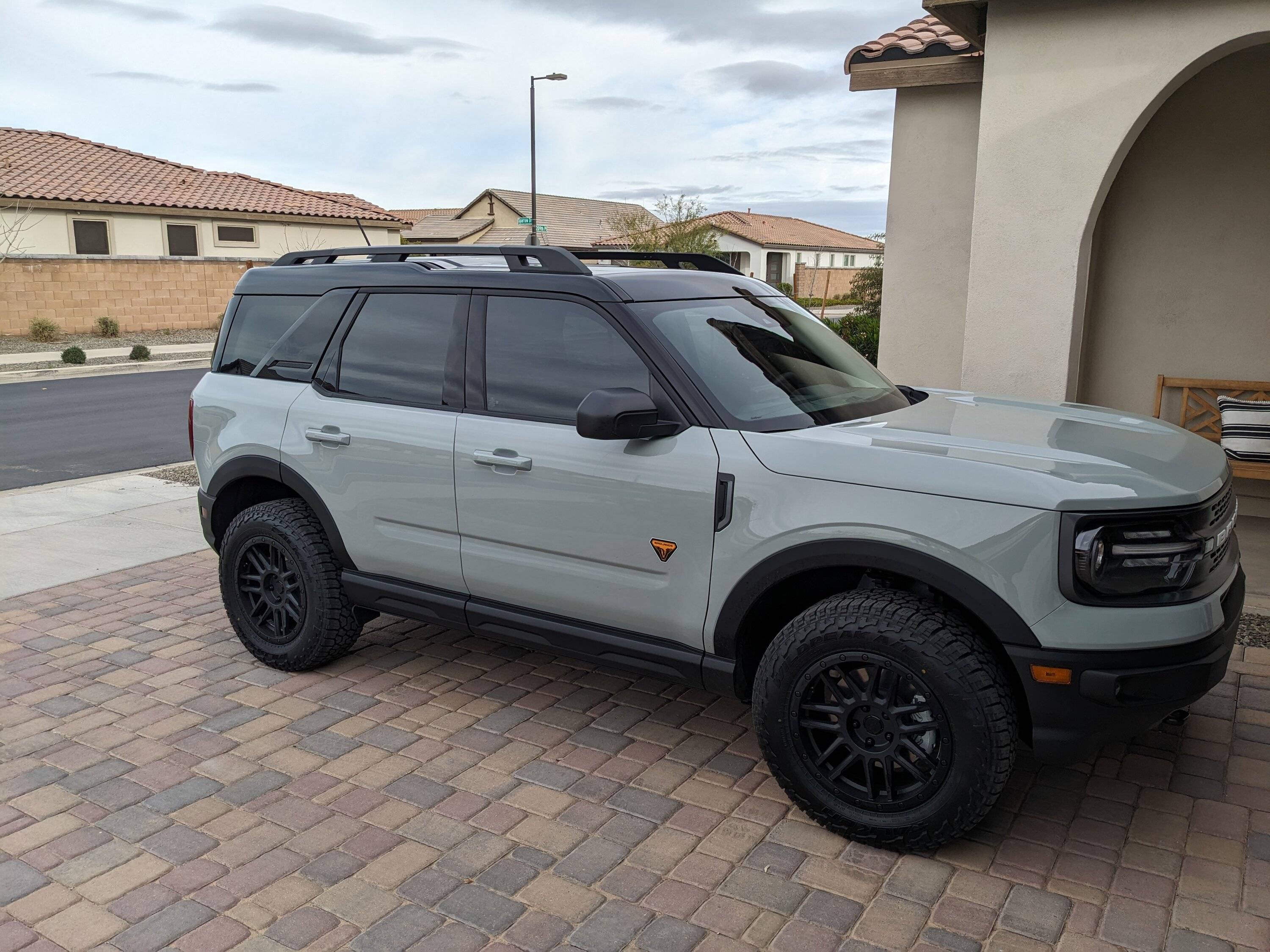

Just put on 245/65-17 Falken AT3's without a spacer and no issues with rubbing. I'm loving these Falkens so far!
Ford Bronco Sport Opinion on 20mm spacer on BS BL with 245/65/17 Falken AT3s PXL_20230311_153502163
So I guess the answer is no on the 20mm, to be frank wouldn't mind a 10mm spacer as well.
