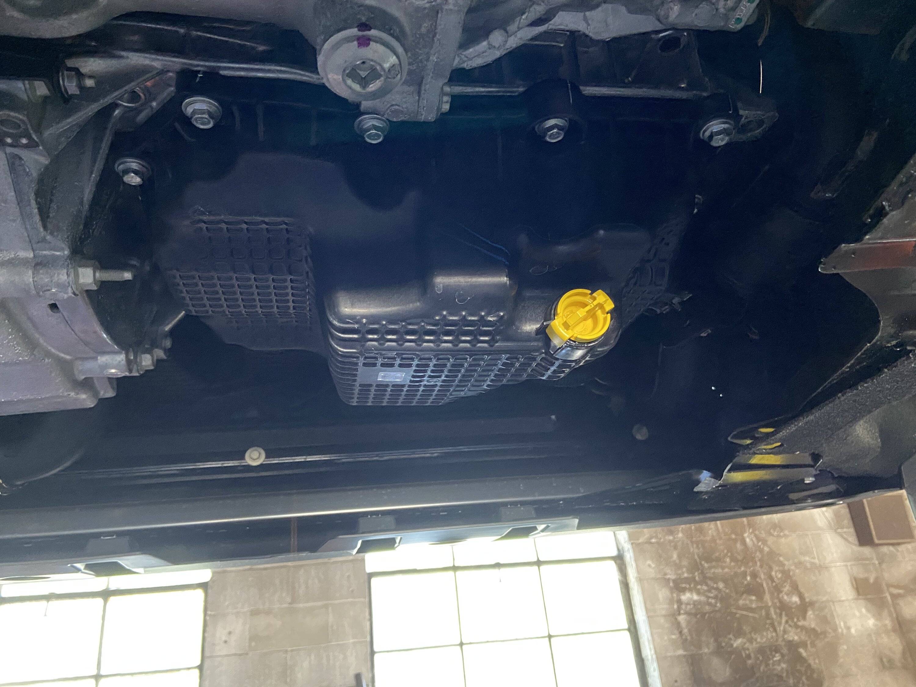

I use my teeth. Kidding aside, just snug it with the turn of the fingers. With the O ring, it should seal up easily with a twist of fingers to snug.
I will remove the O ring from the plug, and head over to my local hardware store to buy a few. Then every other oil change, I'll replace the O ring.

Sure is Plastic !!! This is a pic of my plastic oil pan with plastic plug on a 23 OBX. 1.5

I also have the 6.6 quart oil pan on my 2022 Big Bend. One thing to note f you are doing your own oil changes with this pan: The oil does not come out in a nice slow stream, say like a regular pan with a 12-14mm plug. It comes out like a fire house, so be prepared for it. I had oil splashing everywhere as my "usual" oil drain container's opening couldn't even remotely keep up with the flow of warm 0W-20 oil. It will be a bucket from now on. Luckily, I had put a tarp down first. Cheers!

I know lube techs are hard as shit on everything, but I would relay to this forum that my local Valvoline refuses to use the drain plug on the BS after cracking two oil pans and having to pay for the parts + labor to replace them instead. They just eVac the oil from the top.
(There are numerous schools of thought on the amount of residue left in the oil pan when using an evac and whether or not with modern high quality oils [particularly high quality full synthetic] if it even matters with their abilities to keep any debris in suspension... not getting into the weeds on that here.)
Anyways, point being, there is some advice here down the page on removing/installing the oil drain plug. It can be difficult to remove if the vehicle is hot. The tabs lock it into place but are not to be moved or flexed, and no tools are to be used for removing or installing the drain plug.
