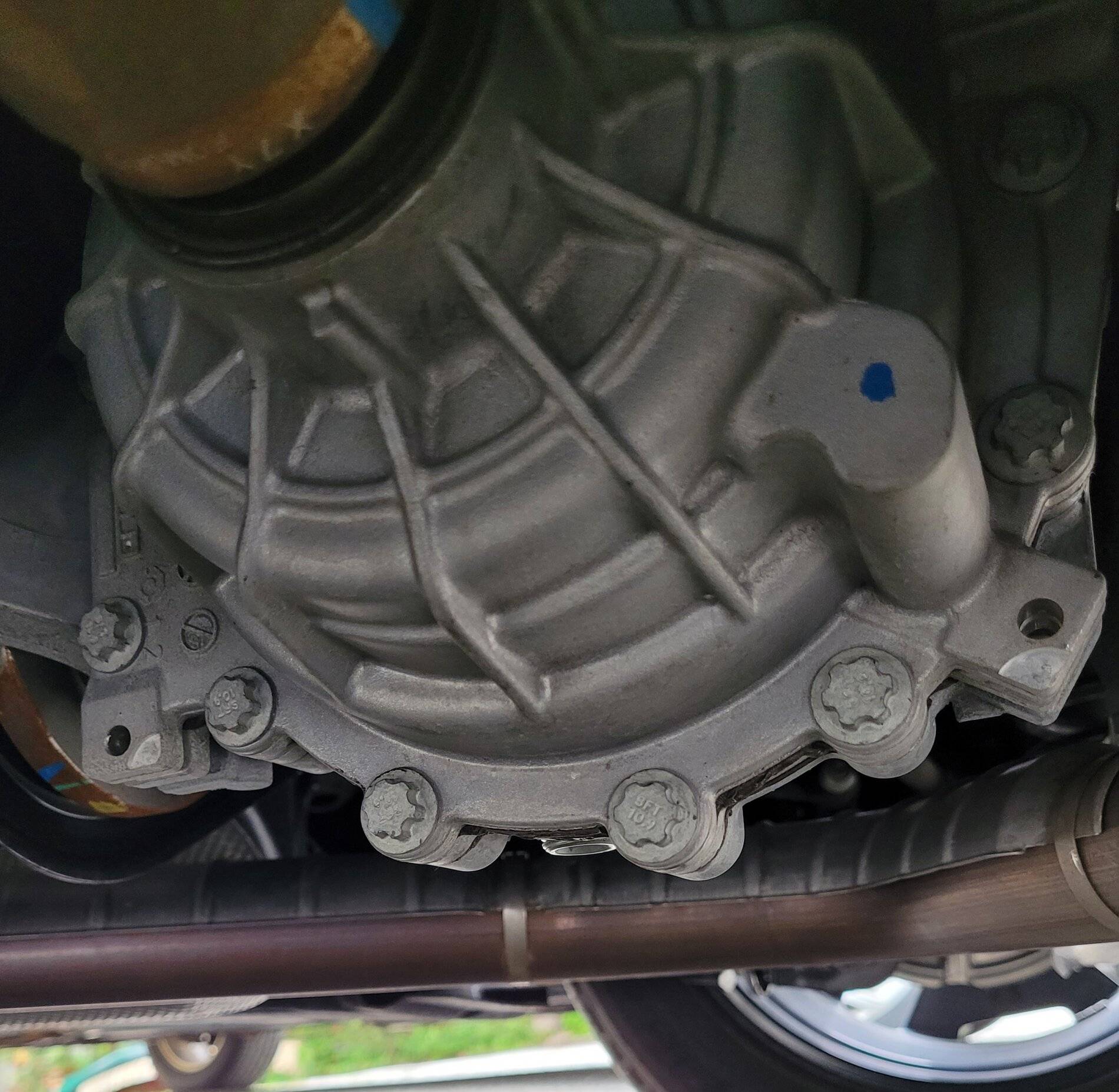

Still considering making my own.
Could use the engine splash guard as a template on some plate steel. Some square stock for rocker guards which looks like it would mount easily into the channel that has holes already there.
And then I saw this,
Ford Bronco Sport Off road protection available yet? Rock rails / sliders / skid plates? 20210523_171137
As if it was designed for it, the rear diff has points front and rear, going through each half of the casing that would be perfect for a bent piece of 1/8" plate with a couple of mounting brackets welded on... or I could just wait for the aftermarket stuff...
Thoughts?
Thoughts?
The diff seems pretty tucked out of the way to me, seems lower priority compared to front skid plate and rock rails/sliders. Easier to make something for though.
Agreed... But cracking that thing open would make for a bad day. Lol
