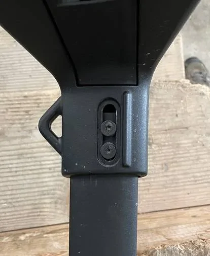

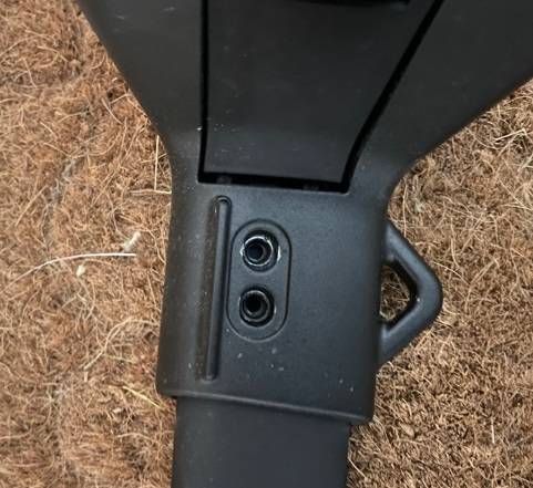

I took the cross bar off & found the problem. See the attached pictures - notice anything different between the sides? There are no bolts on the driver side. How does this happen???
Ford Bronco Sport OEM Cross Bars Rattle - Fix? DriverSide
Ford Bronco Sport OEM Cross Bars Rattle - Fix? PassengerSide
