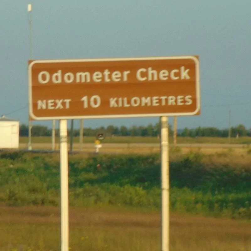

I worked a contract in Oregon many years ago and IIRC they had signs on the interstate every so often for calibrating your odometer. Any other States do that?
SportWest
Dec 6, 2020
424
629
22 Bronco Sport Badlands
Dont notice them at all, which highway are these seen?
Somewhere on I-5, southern part of the state. Similar to this one in Canada:

yes we do in NJ and Ill be 3 to almost 4 tenths every tenth mile marker
I would guess Michigan does on the main expressways with halves and tenths of a mile markers in many areas. I tried to pay attention on a short trip yesterday and watched the tenths add up until I broke a mile. Seems pretty accurate thus far. I'll monitor it closer as I drive further trips.
