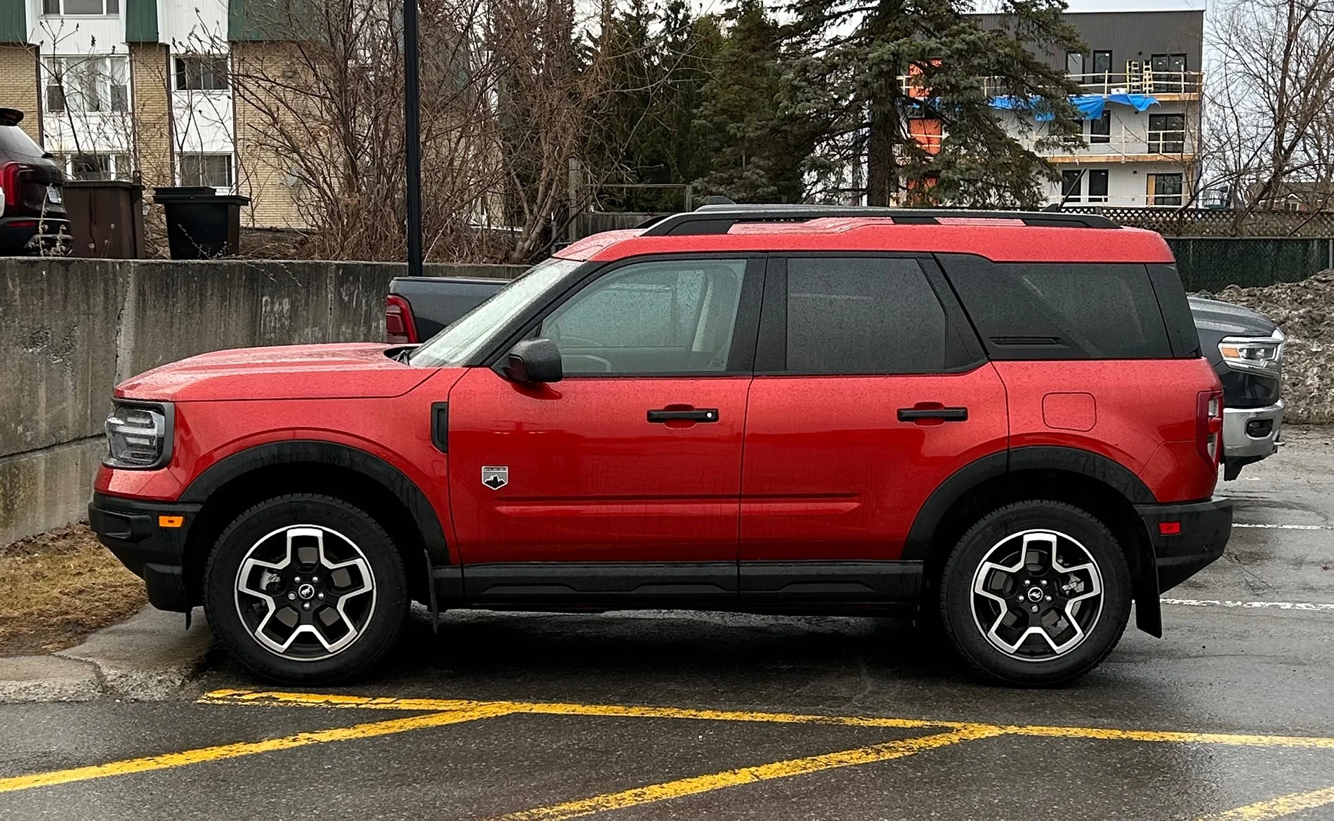

Factory 18x7 wheels.

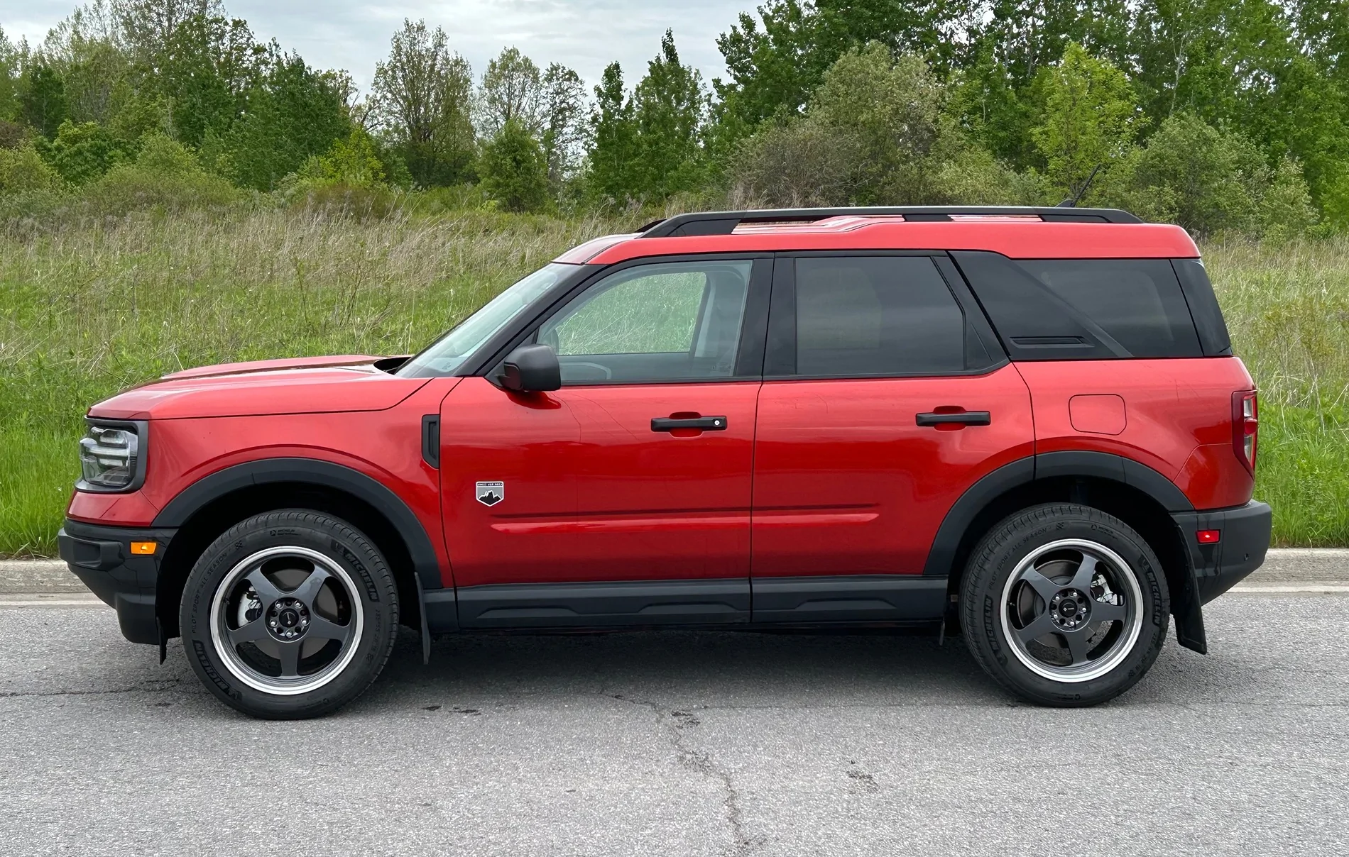

Aftermarket 18x8 wheels.

Do your aftermarket wheels use different lugs that aren't cone seated?
So apparently the factory lugs and the aftermarket lugs are different.

That makes sense. Ive also never needed hub centric rings. Never even thought about it. All aftermarket and factory wheels I've ever had use cone seating lugs. They basically center themselves.
