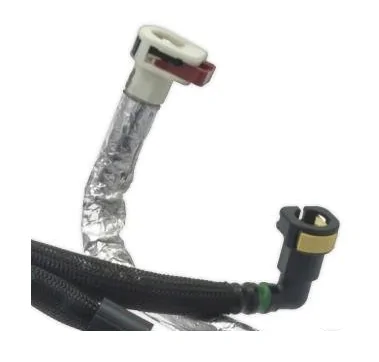

is there any kind of special tool for these style clamps? I hav not encountered them before. Newest car I've worked on in the last 10 years has been my '93 Mustang GT.
Ford Bronco Sport Not happy with Ford/Local Ford Dealer - P04F0 clips

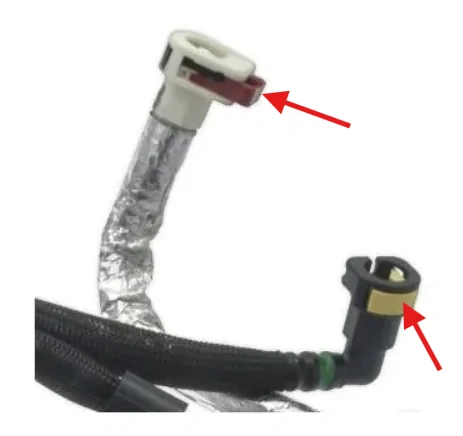

No. You push (or pull, depending on the design) on those locking clips at the location of the arrows I added below. There should be no special tools required for these.
Looking at the photo you provided, it looks (to me) like you'd pull out on the upper clip (the black one), and push in on the lower one (the tan one) to release them. I don't think the lower clip will pull out and stay out like the upper one did.
There are two designs that I am familiar with. One kind that pulls out to unlock and stays out until you push it back in (which I'm pretty sure is the black one at the top). The other kind works like a spring and only has one position. For this second type, you have to push in on that clip to unlock it but it won't stay in.....it's just deforms the clip (to release) when you push on it and it returns to normal shape (locked position) when you release it. I THINK that might be the bottom one.
If you buy the new part before you remove the old one, you can play with them out of the vehicle to see how they work so you know what to do to remove the old one.
I have not changed this specific part on a BS, but have used these clips on several vehicles/brands. Someone who is familiar with this specific part can correct me if I'm mistaken about my assumptions based on the photo, but this should be pretty close.

You're spot on. Though the geometry may change for specific applications, it's super common. Same basic style is used on fuel and evap lines. Generally all that's needed at most is a screwdriver to open and pliers to close, though I'm sure BMW or Mercedes probably require an SST.
