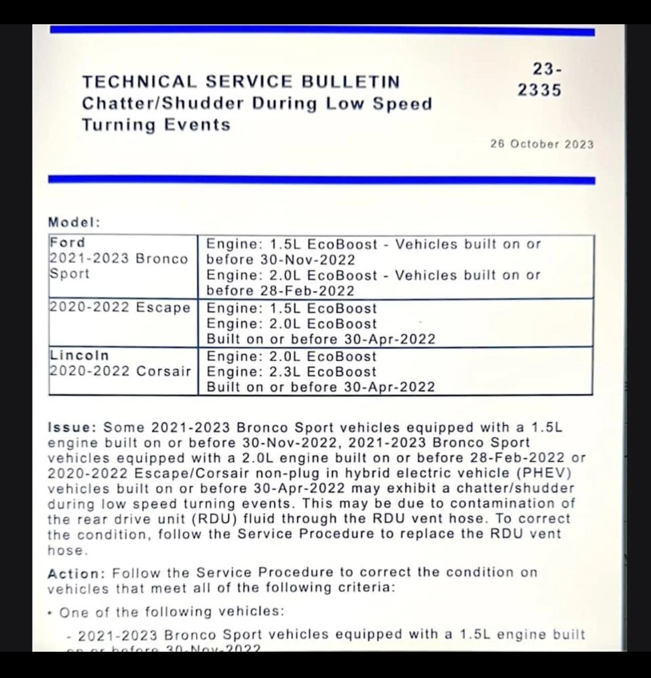

Wondering if anyone has this issue? Just left my Bronco at service department. Post on facebook group had this service bulletin. ?
Ford Bronco Sport Noise/vibration when turning at slow speed. IMG_1113

Had that problem and fixed under that TSB last fall. Happening again and took to dealer and referenced that service bulletin. They told me it is no longer in the system. Actually, before I took it in and looked for it in the list of TSBs for my Bronco and it was no longer there. So what they told me appears to be true.
Needless to say, no fix was done this time.

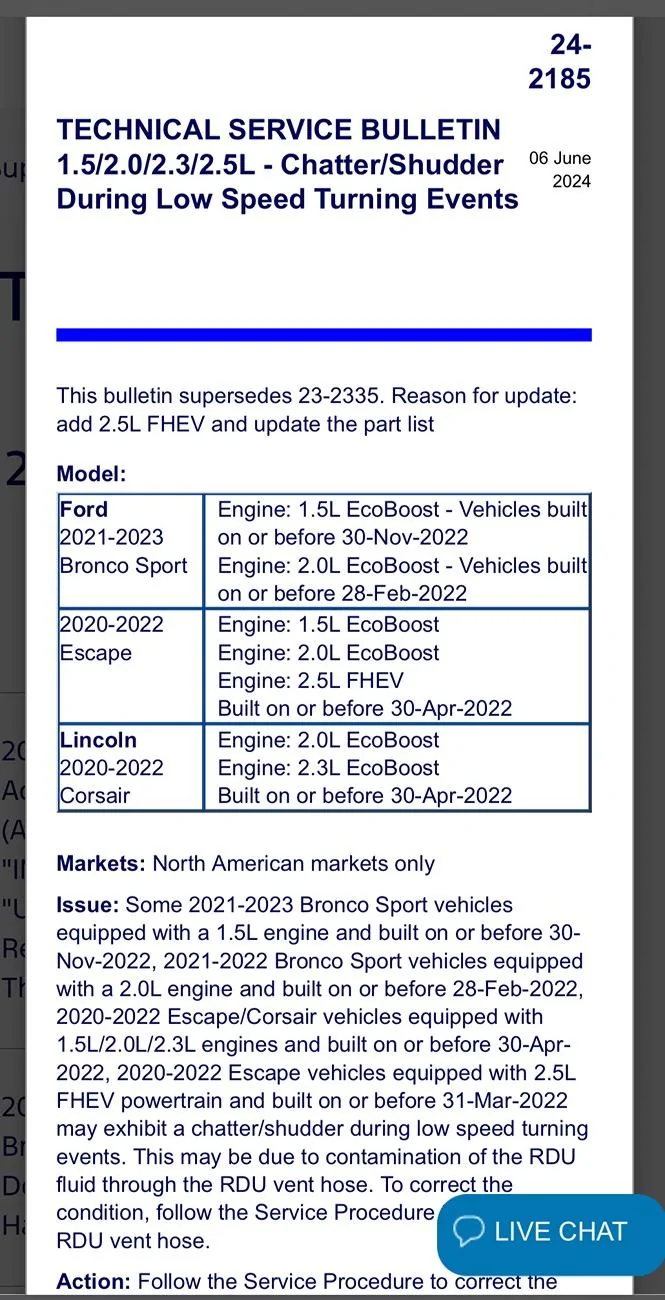

TSB 24-2185 supersedes 23-2335. See the pic in a prior post.

This sounds like the problem we just noticed. Right before a trip to Detroit and back, a 700 mile trip. The delaership guy just said it should be safe to drive and it's not like the rear differential gets much use in summer driving,, no more off roading until it's done though!
To clarify-at low speeds and sharp right turns, like starting up after a stop sign or parking, it will make a chattering kind of noise, with maybe a slight grab and go. Hardly ever feel it on left turns, and not every time. Thought it might have been early stage wheel bearing but you never hear anything on straight roads or just a regular road curve.

So we took the BS to the dealer, and they agreed that the TSB was the problem-however the new hose is not available and has no ETA. Deciding to be the cautious type I had them change the oil in the rear drive unit, the tech described it as "gross". The OK news was that our warranty expired 3,375 miles ago so I had to pay for the oil change and if they had been able to get the hose it would have been $582 OTD.
The gnarly sounds are gone, so I think we caught it in time before damage was done. If you hear the noise you'll want to get it taken care of, espeically if you have some warranty left.
