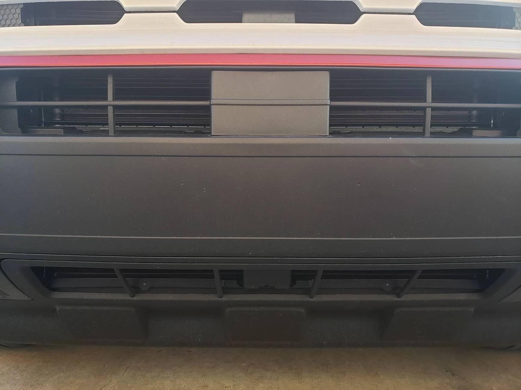

So after driving around for a week without the plate, I got up close & person with the bumper & there looks to be no provision to mount a plate on the front of this truck. Are the tiny little dimples that are visible where they're supposed to be drilled? Anything behind the cover there (metal) or just trust the plastic to never strip out?

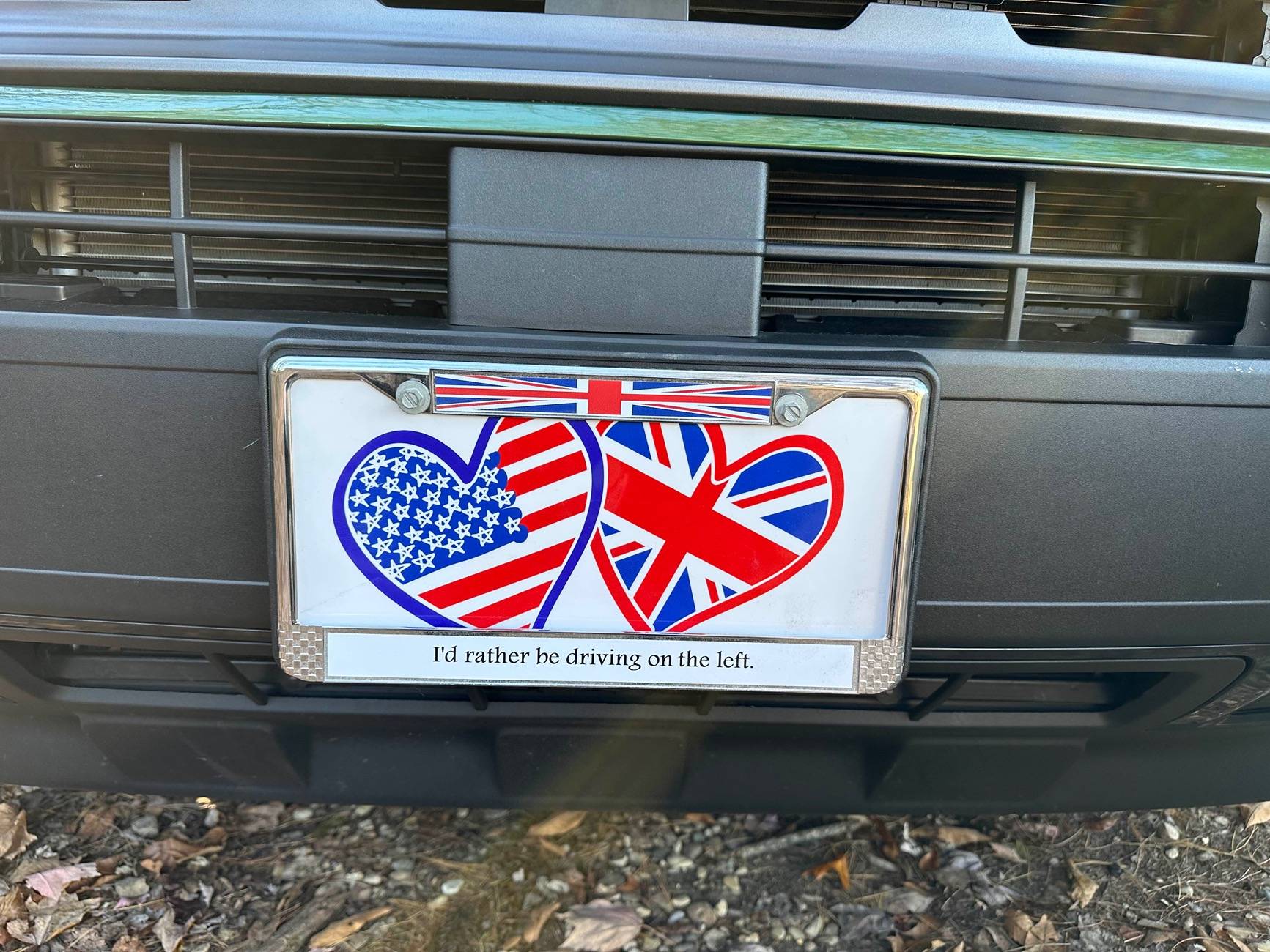

I have a novelty plate I wanted to fit so I asked my dealer for a bracket included when my car arrived. They were like yeah, yeah, no problem.
No.
In the end, I bought one off eBay and got a mate to fit it.

Yes the 4 dimples are the drill points but you should at least get a free bracket from your dealer, if not have them install it.
It is meant to be riveted on. It isn't hard but I guess not everyone has a rivet gun.

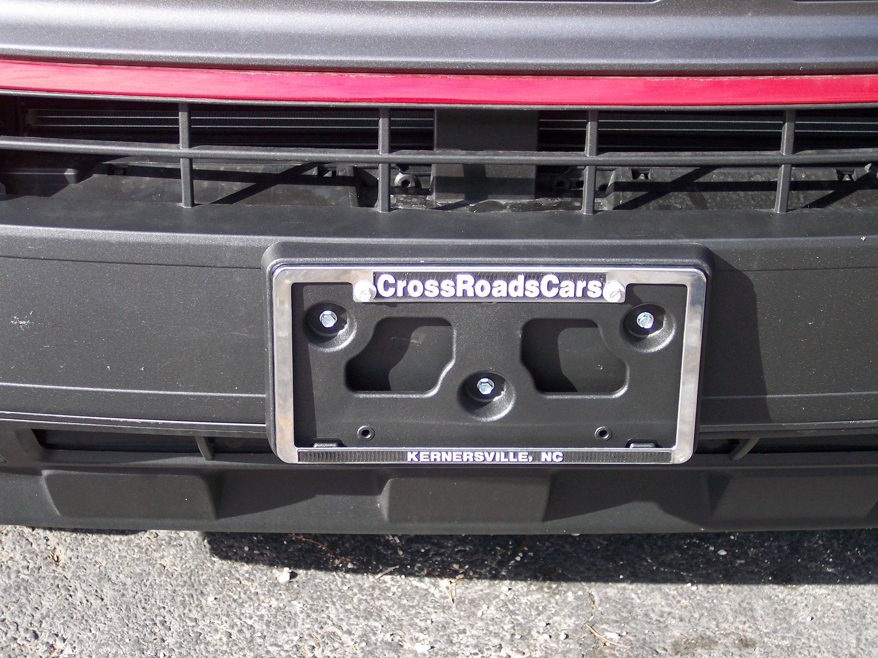

We bought our 21 Bronco Sport in NC that does not require a front license plate. I had to buy a front bracket from our local dealer & I mounted the bracket to the front bumper using self-tapping screws.

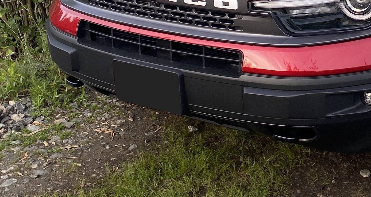

Have a look at your window sticker and see if it was supposed to be included. It should have been. Then go back to the dealer and ask them, what gives? (btw my plate is on there but it's edited out)
