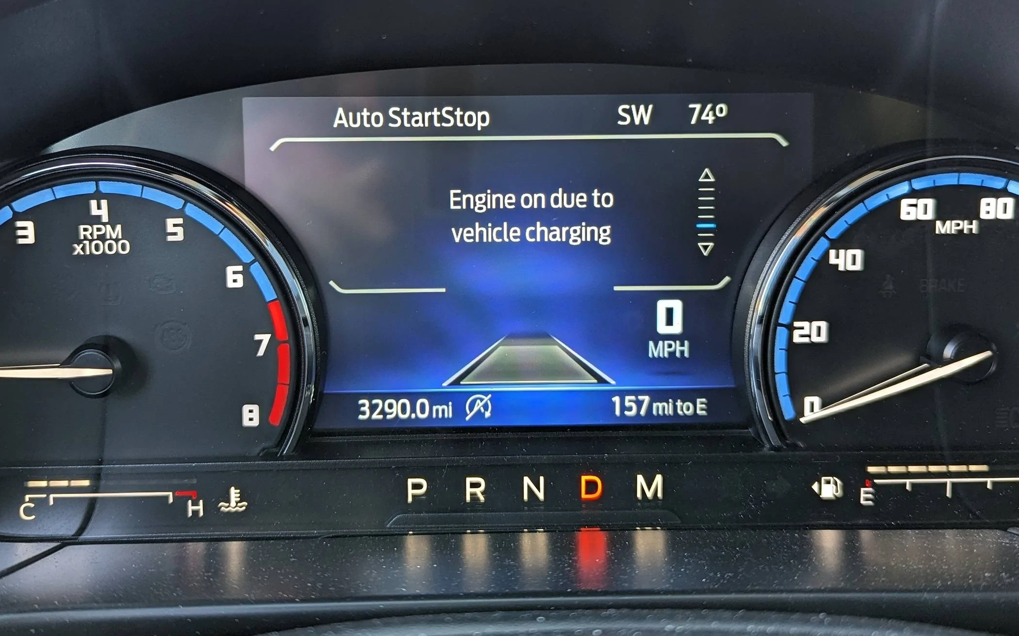

I've seen a lot of mentions of defunct auto stop-start. Most folks are happy about it, but it may be a sign of another issue.
Recall letters are supposed to go out in May for 24V-267. Has to do with incorrect evaluation of battery state-of-charge. An undetected low battery is obviously bad, but a good state of charge may be underestimated too (I assume).
My Auto SS hasn't been working for a while. Flipped to the ASS menu, it says inactivated due to battery charging. I also sometimes get a message at key-on to shut off the car to conserve battery.
So the Bronc is in the shop today for evaluation... no idea if there's a TSB for this or whether they can do the required recal prior to the recall actually going out. We'll see!

FYI: My Ford dealer found no issue with battery or charging system. They recharged the battery and the Auto StartStop works again. They feel that I just need to drive more to keep the battery charged up.
But yes, mileage is low and the vehicle is not driven a lot... but this issue existed even after going on long freeway trips of several hours.
