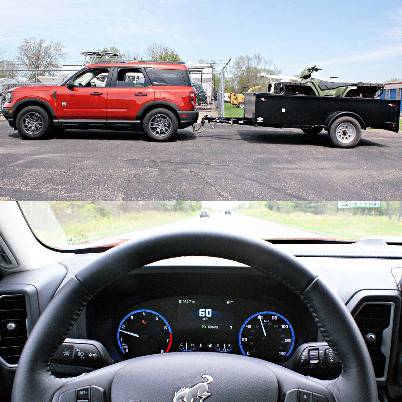

I tow a 6'6"x10' trailer that weigh's 990 and a 1000-pound ATV. Half a tank of gas in the Bronco Sport Big Bend and never go above 60mph. Round trip is 460 miles. The tach averages around 1750 (see pic). I do use a small digital scale verifying 200-pound max on tongue. Premium fuel gets me 19.8 mpg. I've done about 6 trips with it in two years.

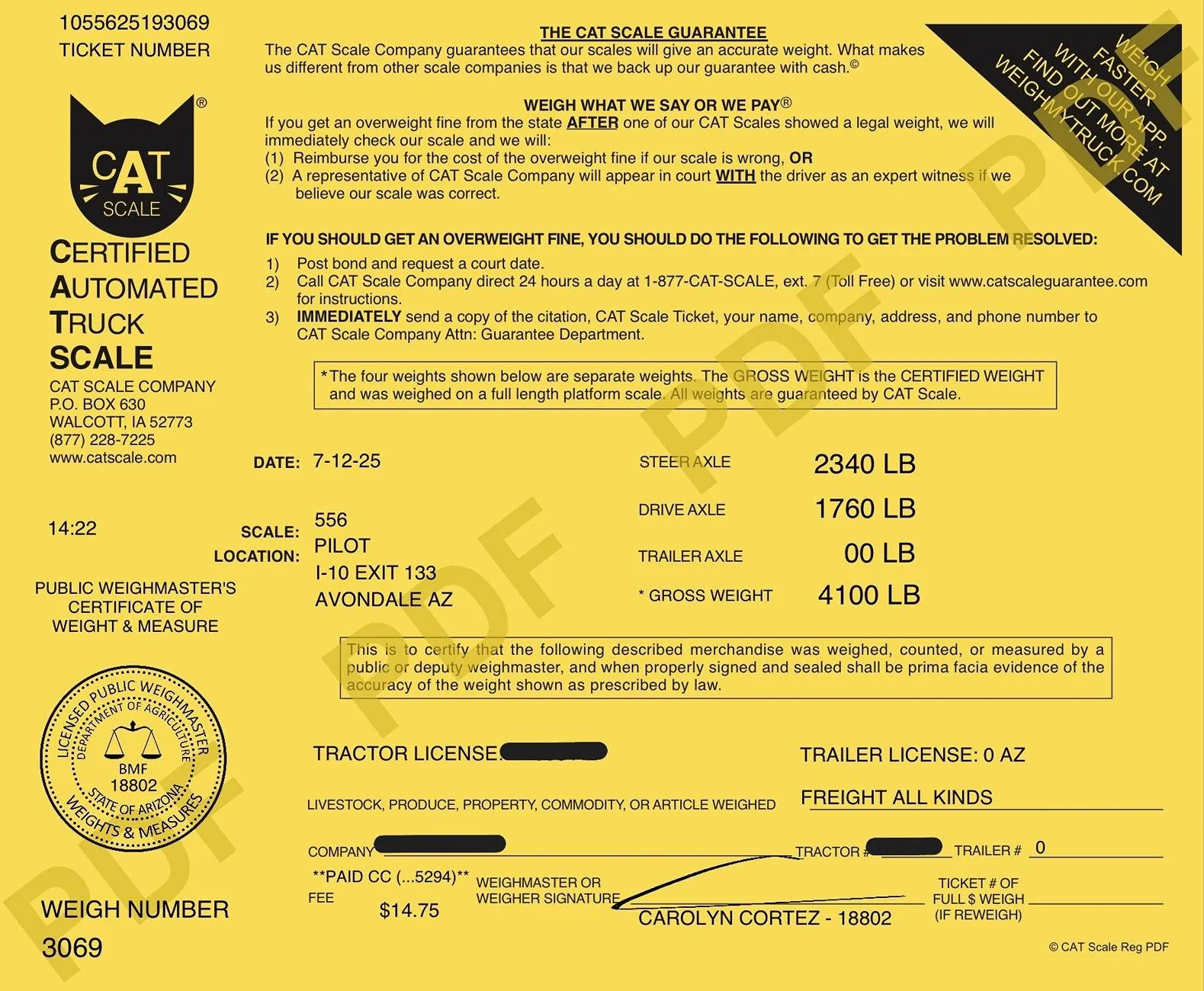

For anyone interested, here’s the as-built ratings for a ā€˜25 Badlands with the Sasquatch package, CMS, Tech Package, and no moonroof. As always, YMMV depending on your specific build.
Front GAWR: 2595
Rear GAWR: 2480
GVWR: 4910
Payload: 914
GCWR, tow, & tongue are the same for all ā€˜25 Badlands, 6890, 2700, & 270, respectively.
I’m going to take it to a CAT scale soon and update with actual weights to get an idea of what my margins are.
Dec 13, 2024
70
1,702
4,346
2025 Badlands Sasquatch
Got it scaled today. Here's the results for my build:
Front (Steer) Axle: 2340​
Rear (Drive) Axle: 1760​
Gross Weight: 4100​
This includes one adult passenger. Given the axle and cargo ratings, I have remaining capacity:
Front: 255​
Rear: 720​
Gross: 810​
Cargo: 810​
My curb weight works out to ~3900 with full fluids.
