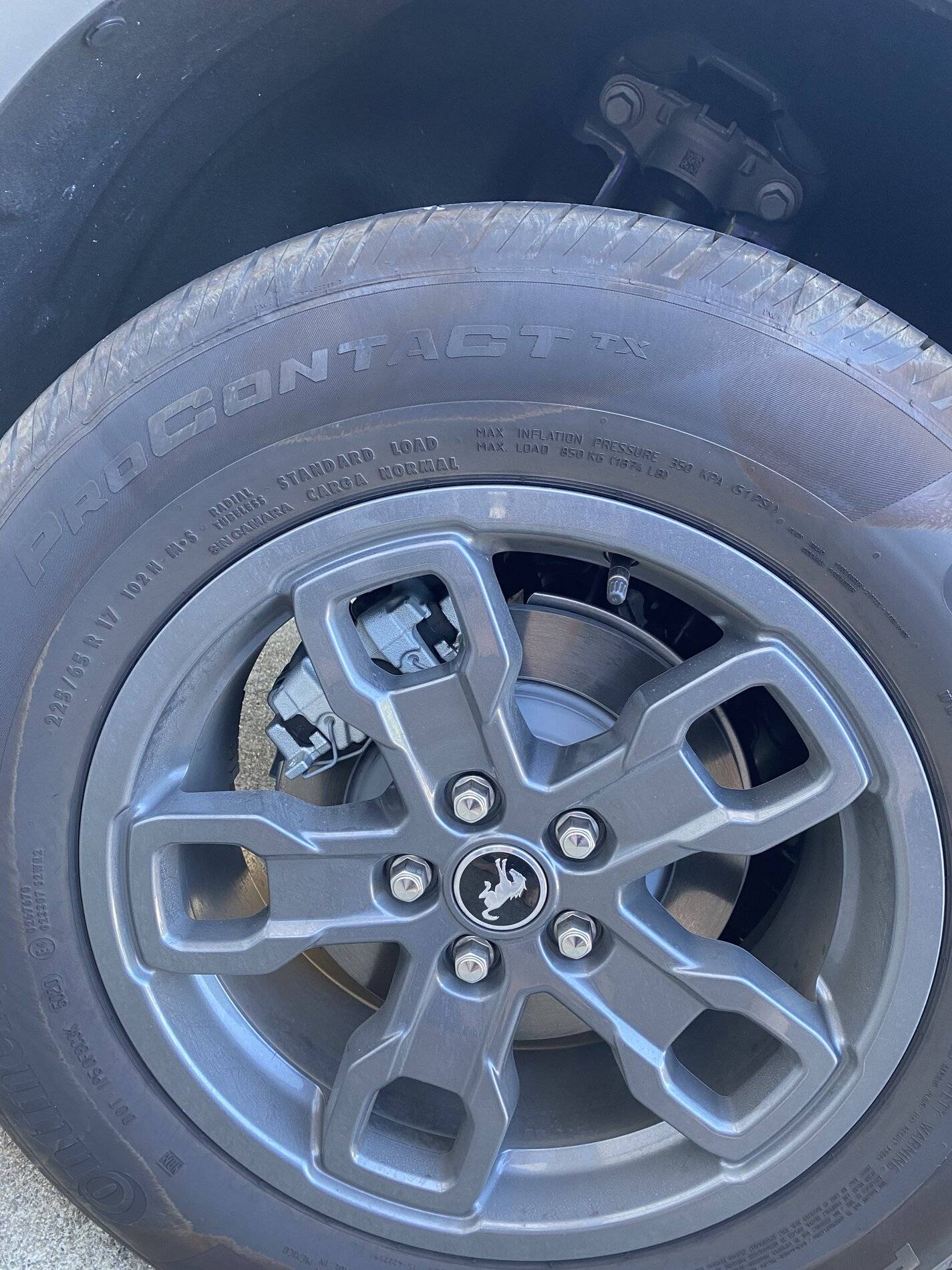

I have a new big bend bronco and my tire blew out on highway with 3k miles on it. The tire pressure light it on so I called dealership and brought it in. They said they can’t fix the alert on dashboard without original tire. So I looked at them and said, so put an original tire on. Come to find out, they don’t carry this or that anyone carry’s that. So, I said what about same spare that I put on so I at least have another spare if I get another flat. They don’t have that either. I asked them to order one and they said they looked and can’t find either that is the exact same.
So I am driving around on a brand new bronco 34k truck with a spare tire and no back up.
Any advice as what to do?

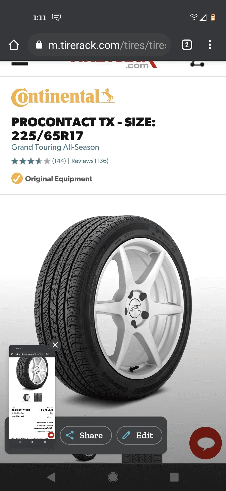

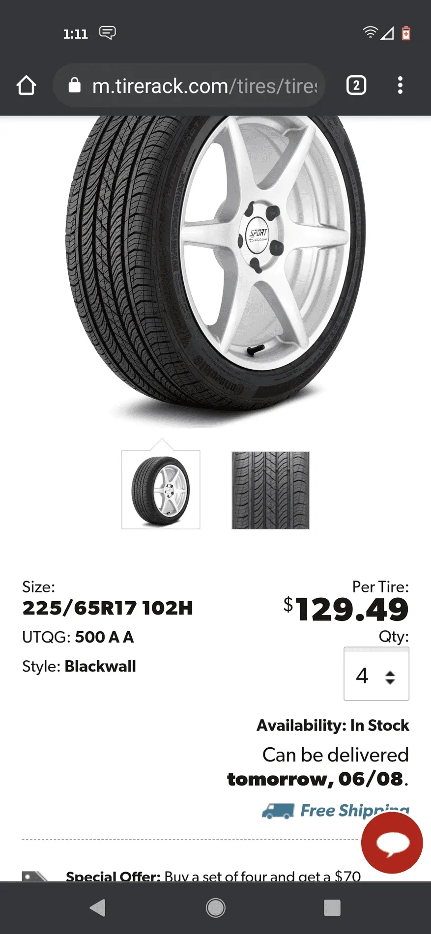

Does tirerack.com have the correct tire? Lot of ppl removing orig wheels tires maybe you can locate some take offs?

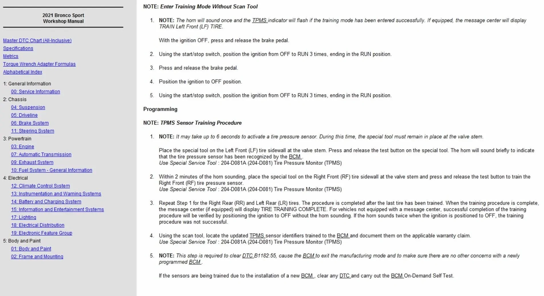

I can only imagine that the dealer is referring to the TPMS (Tire Pressure Monitoring Sensor), which is attached to the backside of the tire stem on the wheel. There is a process where those sensors are "mated" or "trained" to connect to your vehicle and it is that sensor that tells your Bronco Sport when the tire pressure is low. But those sensors are tire-independent and will function correctly with any tire as long the air pressure is correct.
In addition, if the sensor fails, it can be replaced with a new sensor, which can also be "mated" or "trained" to connect to your BS with a tool that the dealer has (or you can get yourself, they don't cost much). Otherwise you'd be kind of S.O.L. if the original sensor failed. While I've not done this on my Badlands yet, I do own one of the training tools and have done it on other Fords many times.
Now, having a different brand/type of tire than the other 3 would definitely be a safety issue, and if a replacement tire cannot be located, that's not good. But the system itself is not tire-specific.

A quick check against the service instructions for the Bronco Sport seems to confirm that the TPMS system "trains" the same way as most all of their vehicles:
Ford Bronco Sport New bronco, tire blew and dealer can’t find me a tire BroncoSportTPMS
