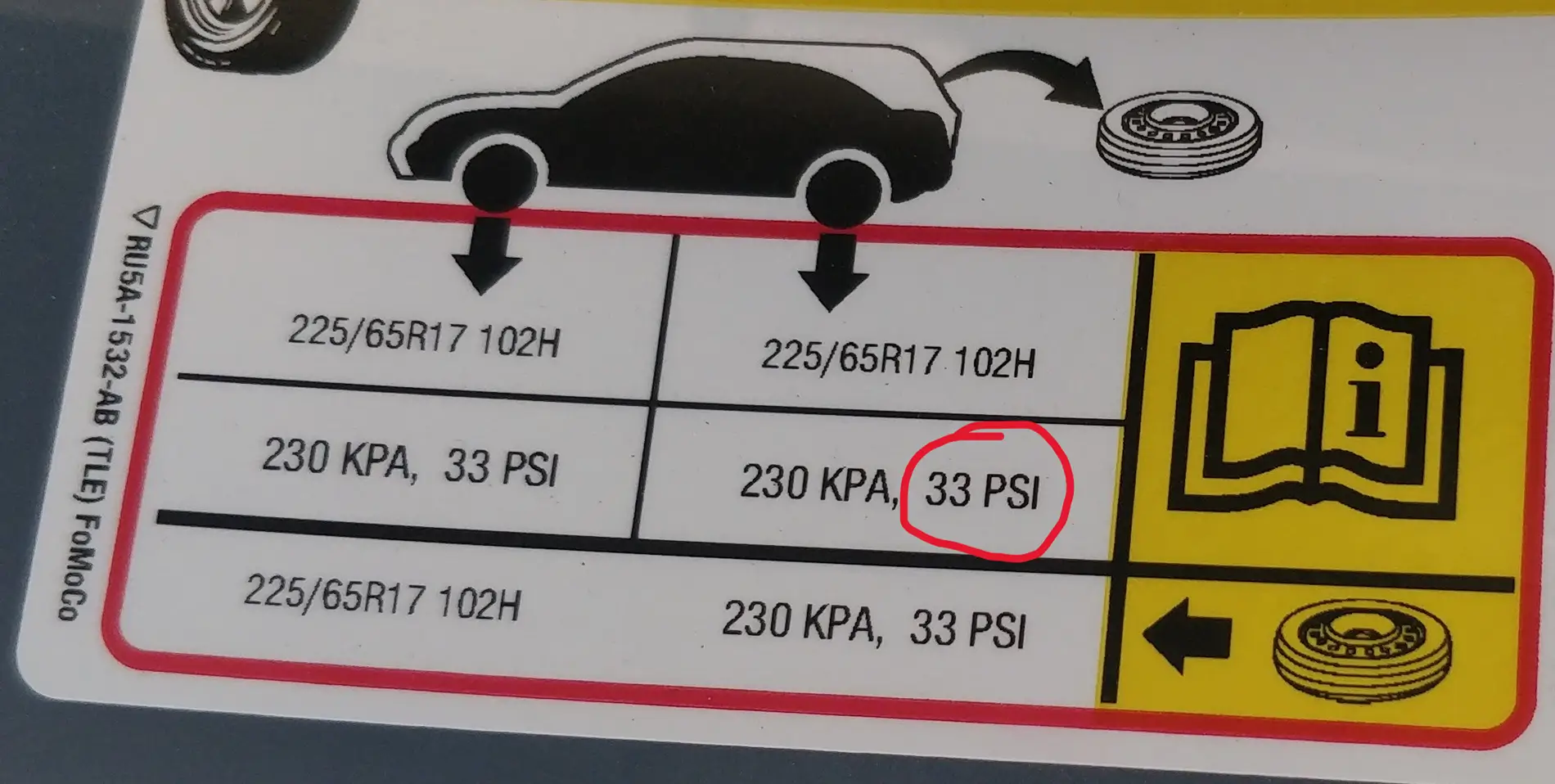

44 PSI seems 10 PSI higher than what I have for my 235/65/17s and my bronco tells me 33 is the correct PSI for stock. Your tires also look very narrow when they're installed compared to mine. I would double check your math on that one. Not sure if it's a different in NA vs SA, but that's a drastic pressure difference.

Thanks for your input, I really appreciate it.
This is actually my first vehicle purchased in Argentina that is built for the North American market (in Mexico at least), so it’s a bit of a different reference point for me. Up until now, all the vehicles I’ve owned were locally manufactured for the Latin American market (Renault Duster 2017 from Colombia, Renault Duster 2020 from Brazil, Ram Rampage 2025 from Brazil, etc)
In every one of those vehicles, the recommended tire pressures on the door sticker, regardless of the tire model, were typically in the 40–43 PSI range. That always seemed excessive to me, and in practice I consistently noticed more wear in the center of the tread rather than across the full contact patch. Because of that, I’ve usually run slightly lower pressures, although I’ve often received criticism for doing so.
Here in Argentina, it’s also very common for dealerships and tire shops, even official service centers, to inflate tires to quite high values, often close to 45 PSI. I’ve never fully understood the reasoning behind that.
Based on your comment (which I appreciate again), I went to check the door sticker on the Bronco Sport, and it indeed specifies 33 PSI as the recommended pressure for stock ones, which, in hindsight, is obviously the first place I should have checked. So that makes it clea, I’ll be lowering them to 33 PSI and testing from there.
Ford Bronco Sport New Badlands owner – Tire Upgrade and initial setup (looking for feedback) 1774381862283-g3
Thanks again for the feedback.

When I got new tires the shop set them at 36psi, I am waiting for the weather to warm and to see how high the pressure gets as the tires get hot. From what Ive read 33psi is the recommended minimum when fully loaded so a little more pressure should be better and for fuel economy. Also something else I saw about tires is that lower pressure increases the stopping distance which took me by surprise but the tire deforms more and loses contact apparently.
Trust me, over-inflation also increases braking distance (don’t ask how I know <lol>). As the tires get harder they act like “marbles” — no traction for stopping. My experience here in SoCal is that most of the time 33psi cold is @ 37-38psi hot (I do use nitrogen fill, air may be slightly different).

FYI, I found out not to long ago that the PSI numbers on the door is based off a full load. meaning passengers full rank of gas. Plus luggage. I recently checked the max psi on mine. max was 51 psi so I filled mine to 48 PSI gained around 2 mpg.
You gained 2 mpg, but at those pressures your contact patch will be compromised. The tires will wear significantly in the middle of the tread. I would also be surprised if the BS didn't feel squirrely too. Cheers!
Once your tires warm up the pressure will be too high for safety and you will wear the middle tread out prematurely.
What Ive read is best running pressure 15% below max fill pressure after tires reach heated pressure. If that makes sense lol. So if your tires say 50 max and after getting hot from driving they shouldnt be over 42.5, if the pressure increase 5psi from heat then you should have no more than 38.5 cold but I bet on a hot day they would warm up more than 5 psi so your max fill cold would be even less so 33 minimum for the vehicle load rating and maybe 35-37 max cold. But Im no expert so this is just sharing something Ive read. I do run 36 but I havent driven in the summer yet.
You and I both run 36psi (cold), mine on hot days of driving increase to 39 according to the instrument cluster tire pressure gauge
Do you have the link to the article you referred to?

I’m sorry I did not save the article it may have even been a video. I’ve got so many things coming and going I’m surprised I remembered what they were saying.
I think they were talking about a specific use case (like driving on the moons surface) … I wouldn’t follow the psi advice of the source you referred to 😉
